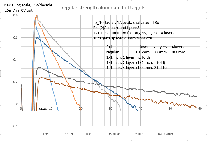

        Some targets for discussion. 1x1 inch targets cut from regular strength aluminum foil(kitchen foil). Thickness can vary, probably need to include measured thickness. Should be easy to detect. 1 layer maybe not? 5+mm square and a 10mm square cut from the side of an aluminum drink can. Hard to cut exact so include micrometer measurements(example, 5.1x5.2mm). Charted decay for the foil targets, included US nickel, dime and quarter for comparison.
          What was your hardware test set-up to chart the decay times? Also, it is assumed that you are driving your output transistor with a +/-5V pulse, but the pulse length I use is 65 uS, not 160uS, which will make a relative difference too.

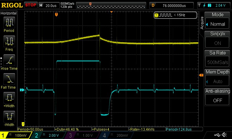

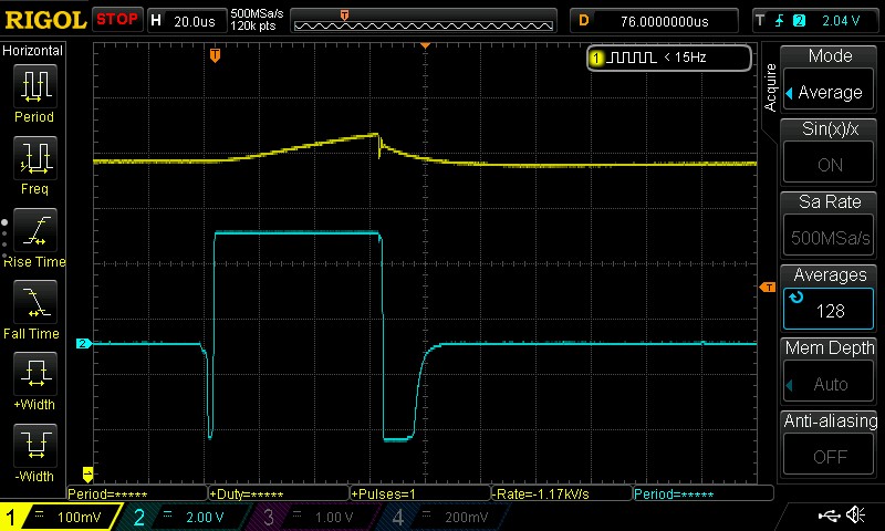

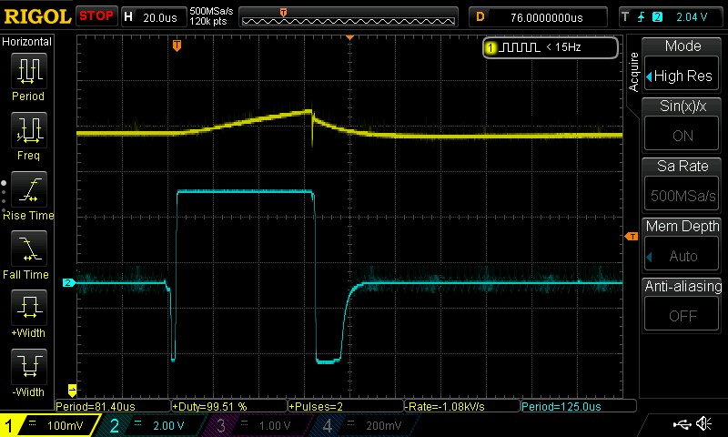

            Has anyone come up with a design for a cleaner power supply for the +5V and -5V supplies. Using an NE555 timer to generate voltages adds small spikes to the power supply, and this gets amplified along the path. The attached photos show the following:
            - Average voltages (+5V and output of pre-amplifier) - they look nice and clean
            - Voltages by Time - lower trace shows the jitter as well
            - Voltages by snapshot - can see the noise in the 5V transfers directly to the output of the pre-amplifier
            Has anyone tried using a Low Drop Out (LDO) chip to smooth things out?

              My detector isn't working at the moment, so charted the targets with my bench tester. Doesn't show maximum detection depth, can't compare with your detector. Shows amplitude of the three foil targets are the same at about 5us after Tx off. The foil and can targets are possible targets that anyone could have available? One problem, thickness can vary. They are short time constant targets so Tx on time shouldn't have much effect, peak current yes. Just wondering if there are some targets that anyone could have available to compare detection distance.

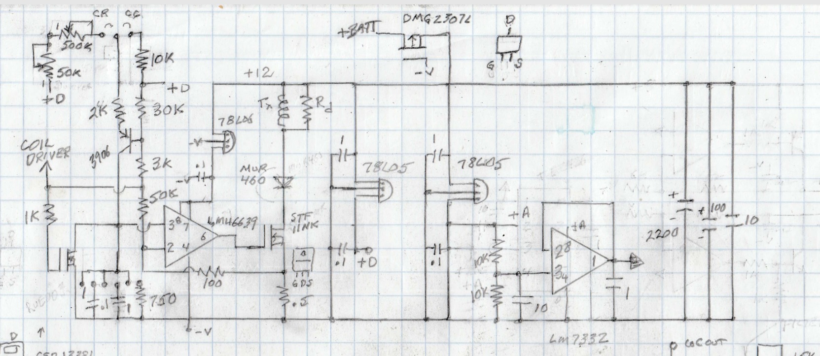

                Schematic reply #21 doesn't show MUR460 diode between mosfet and coil. Tried both ways, ended with diode.

                  Yeah there is some slight noise with the original power supply. Some get kind of fanatical about it and complain. The noise was found not to have any bearing on the way the Mirage operated or degrading performance. So it was left as is.
                  Will say, a new power supply was designed which no longer uses the NE555 but, two other chips replace it, its proprietary circuit design, so I was asked not to elaborate on it. Takes care of the noise and ties in with other parts of the Pi circuit to make a much more stable detector. So a cleaner power supply can be made.

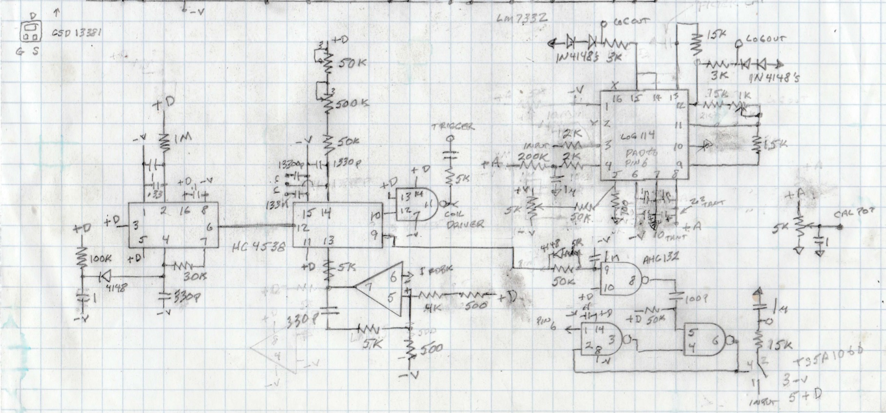

                    Is there a cleaner schematic of the Target Response Tester somewhere?
                            Just the hand drawn schematic. Enlarged it so a little easier to read.
