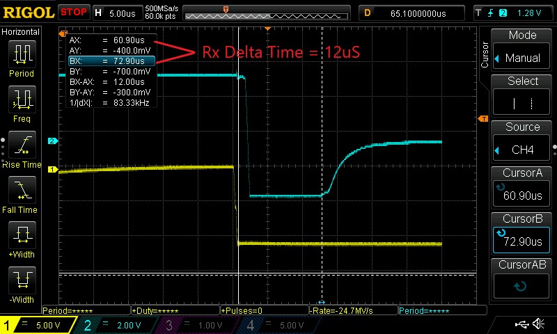

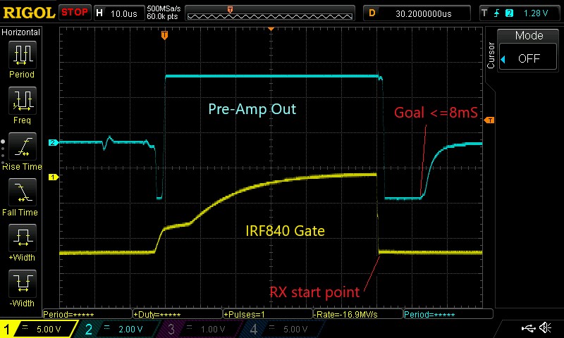

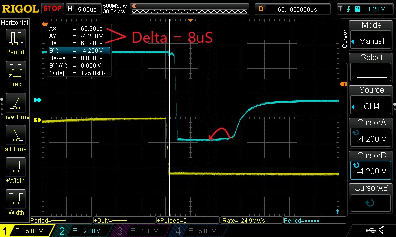

              Now I feel depressed! Looking at this screen shot, you can see the yellow gate drive signal (RX start point = Carl's cheat spot?) of the IRF840 and the blue RX signal after the pre-amp. Click image for larger version
Name:	Measuring RX Window 1.jpg
ID:	354869. Now look at the actual result Click image for larger version
Name:	Measuring RX Window 2.jpg
ID:	354870. Then see where the blue knee needs to start in order to achieve 8uS Click image for larger version
Name:	Measuring RX Window 3.jpg
ID:	354871. I suspect that I need to increase the damping resistor, which will reduce the over-damping and move the blue knee left somewhat. Short of that, I need a quicker search coil and lower capacitance coil driver (ie. IRF840B).
                I also use the TX Gate OFF edge as the start time to measure decay delay.
                The difference between Gate off to Drain off is very, very small so Gate is good.
                I also look at the Coil output, before the clamp diodes, to determine if the coil decay is fast enough. On my HH2 it is the Pre-amp recovery that takes more than 10us whereas the coil decay is <8us.
                This is why many have posted improved Pre-amp designs and there has been much discussion on which op-amp is best.
                  Haha! Welcome to the club! It appears you are at about 14-15us right now. I consider 8us to be quite difficult. You will need to look at everything... coil windings, shield, cable, FET switch, damping R, diode clamp, and preamp.
                    Now I feel depressed! Looking at this screen shot, you can see the yellow gate drive signal (RX start point = Carl's cheat spot?) of the IRF840 and the blue RX signal after the pre-amp. [ATTACH]47372[/ATTACH]. Now look at the actual result [ATTACH]47373[/ATTACH]. Then see where the blue knee needs to start in order to achieve 8uS [ATTACH]47374[/ATTACH]. I suspect that I need to increase the damping resistor, which will reduce the over-damping and move the blue knee left somewhat. Short of that, I need a quicker search coil and lower capacitance coil driver (ie. IRF840B).
                    Start with a two stage amplifier and a MUR460 diode between the coil and mosfet. Then you need a fast coil.
                      It's difficult to compare these. If the preamp needs to settle to within, say, 500mV of ground to start sampling, then the coil needs to settle to within 1mV of ground is the preamp gain is 500. It's difficult to see this on a scope. It's easy, however, to look at the raw coil decay and think it is nice & fast, until you realize just how far down it has to settle.

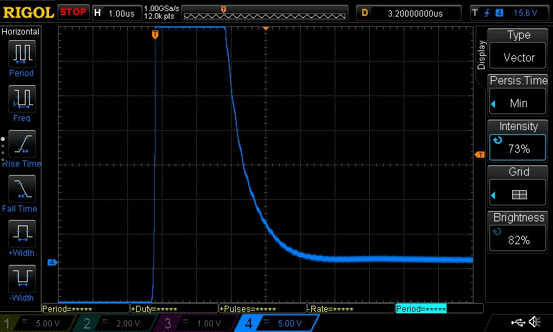

                              It looks my my overall rig (including coil, coax lead, IRF840, etc.) produces a fly-back decay time of about <5uS (using my eye, not measured to 1mV above ground) once critically damped, so the impact of the clamping diodes and pre-amp is my next area of focus. I have noticed that when I increase the pre-amp gain, that the "clamped time" does increase a few uS, so the pre-amp is probably the priority area to work on. Green's suggestion of a two stage pre-amp is a good one. Can anyone point me to other posts that resolve this?
Name:	Critically Damped Coil Response.jpg
