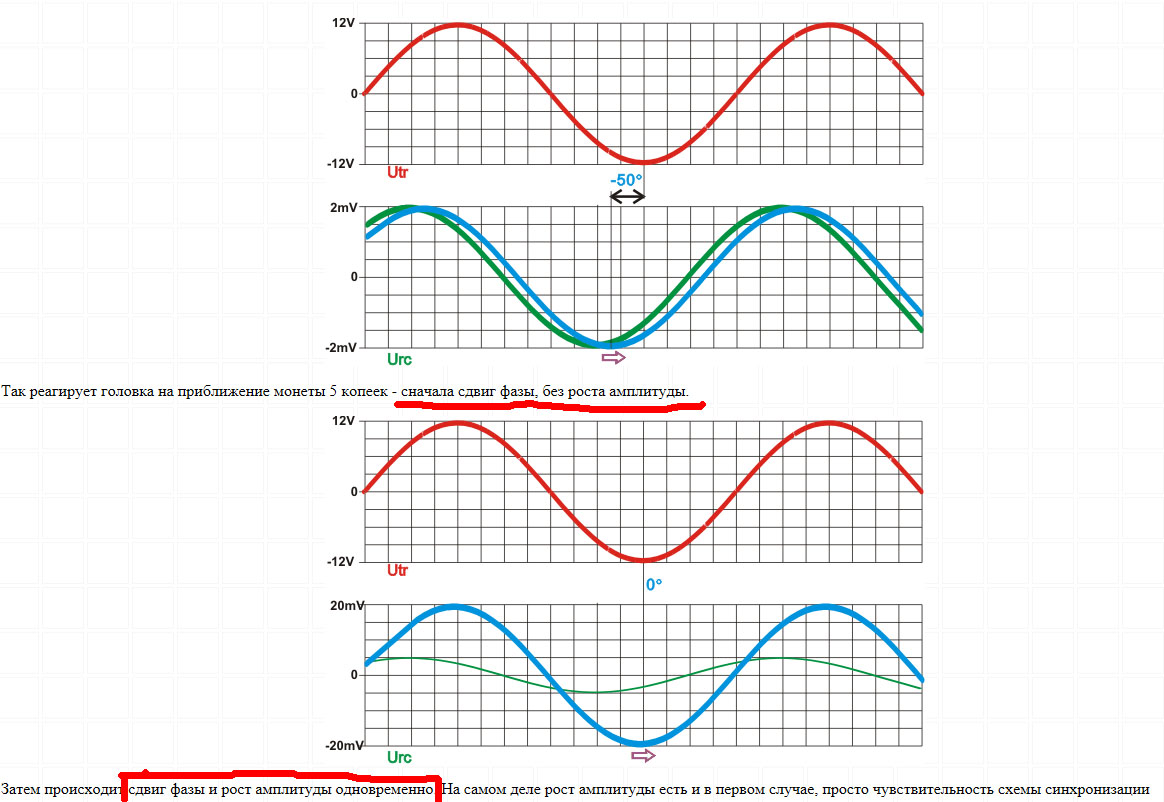

    Kostin reseached that
    - a reaction on unferrous at first moment is just phase shift, then after at secondary is phase shift and amplitude
    - a reaction on ferrous at first and later is phase shift and amplitude, together.
    from that you see why VLF two-channel classic two-comparator schematic has low sensitivity on unferrous and big sensitivity
    on ferrous. because at first stage when un-ferrous channel already turns up, second all-metal channel is still in turn off state.
    NO signal, no reaction.
    (i do not use 'X reactive' and 'conductive R' conceptions here)
    I had a bad TGSL and had to troubleshoot it. When I checked the filters I have observed that the Disc channel has more gain and it's more sensitive than the Geb channel with the same components, I even meauserd and paired them to be almost exactly the same value. I tried to raise the gain on the Geb channel by 1.5x~ aprox but no benefits of detection distance.
    It is very interesting because as you say no reaction on Geb while Disc has already reacting. Because of this phenomenon classic comparator desings loose good detection depth. It would be nice to improve this drawback of these designs.
    • yup, we pay the depth loose for perfect discrimination. you are right.
      here that i see in Kostin's text. you see primary reaction on coin and then secondary reaction, on the pics. in first case we see just phase shift without amplitude growth.
