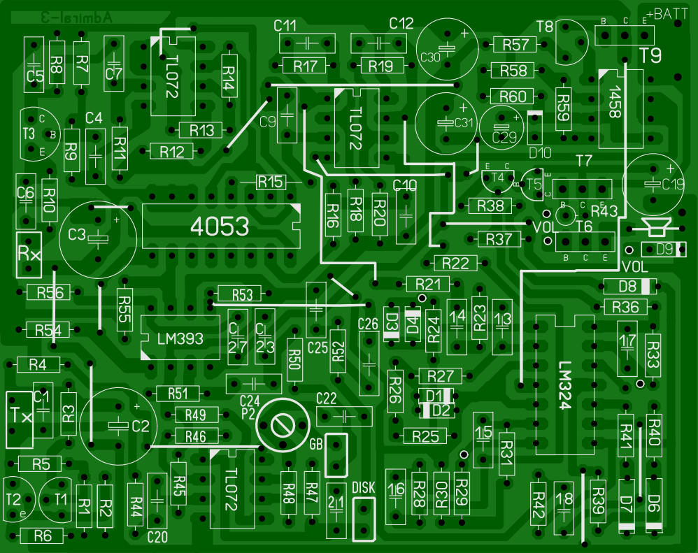

                    • Thanks DB,,,,I don't see those 'X2' diodes labelled on the schematic but they are labelled on the pcb. Thanks, Marty.

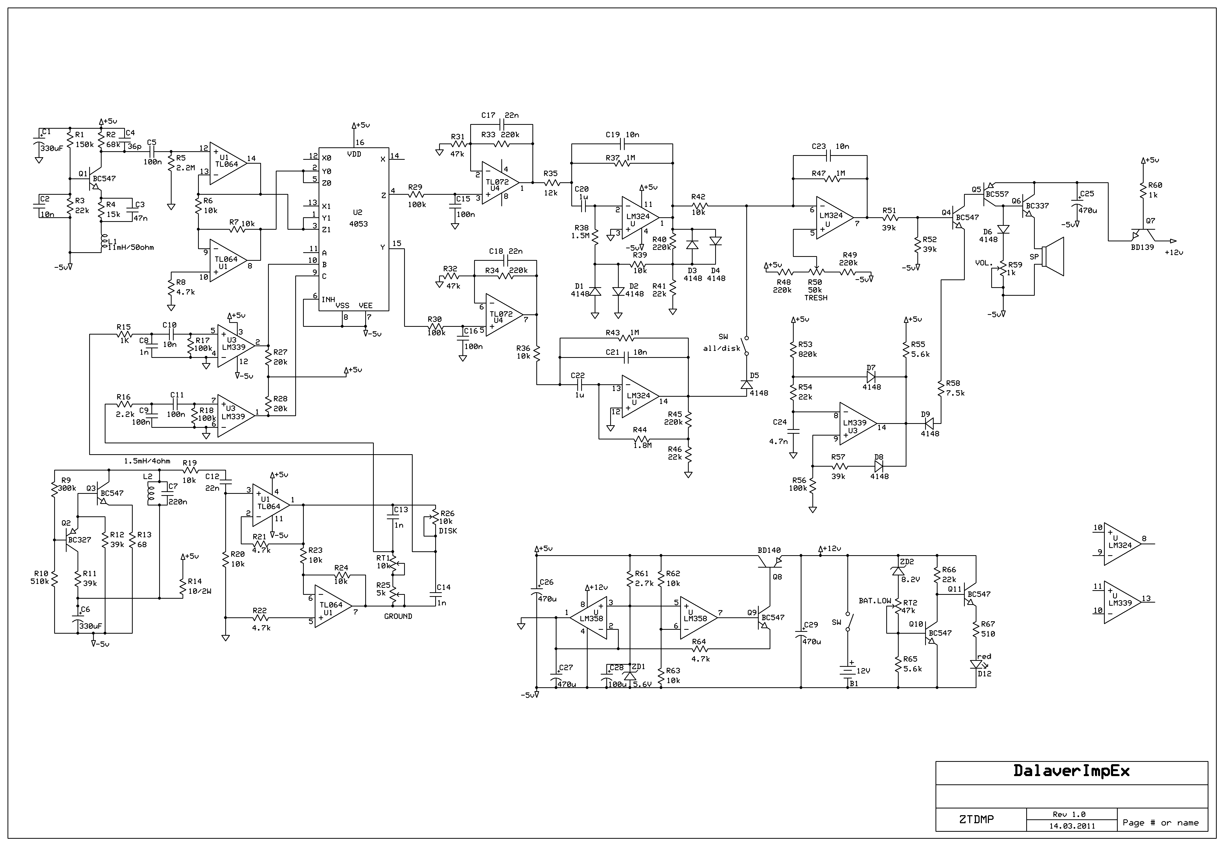

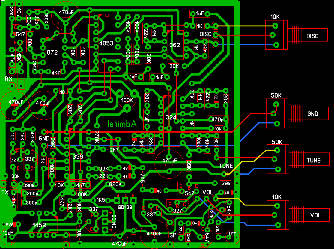

                          Hi Marty, well X2 means two diodes, so there are two 1N4148 in series where it is marked X2 on the PCB layout. The schematic shows two diodes in series, but the layout only has provision for one diode, so you can either solder the diodes in series and then solder the two ends into the PCB, or you can modify the layout to accomadate two series diodes.
                          I have never made this circuit, so I cannot say whether it is good or not. There are a few variants of the "wave" schematic floating around, Indicative of many builders versions over the years. I tend to stay away from such circuits.

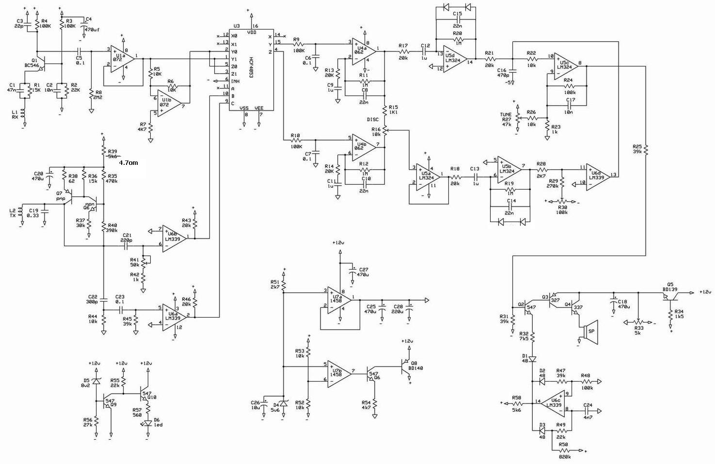

                          There is however an original Cscope circuit which matches a wave schematic and it has a good layout. Here they are.
                          I can put the Sprint file if you are interested. I feel much better about this version, because it is directly a Cscope schematic.

                              • This layout is quite nice, I checked it through against the shematic I posted above and it seems good, although I have not built it. The coil details are on the schematic, but I'll check for the proper parameters. I have it somewhere in a file. If you want to build the "admiral" then this is the one to build. The "wave". it is direct copy of Cscope circuit, so it is bound to work.
