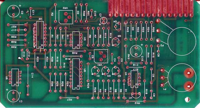

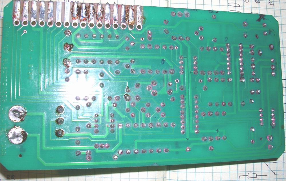

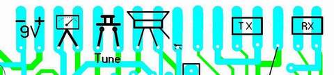

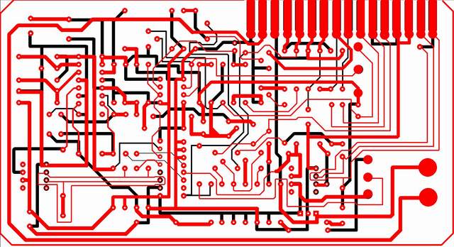

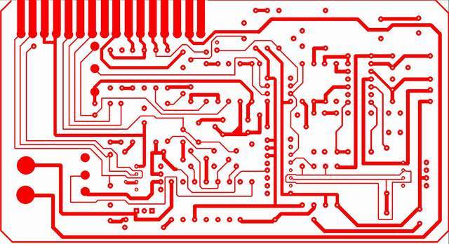

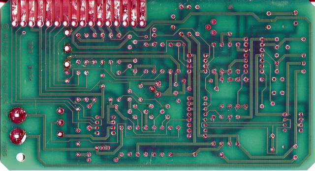

certainly, like always, i take files from this forum keeping on PC and put them back.Attached Files- 3900.JPG (77.3 KB, 315 views)

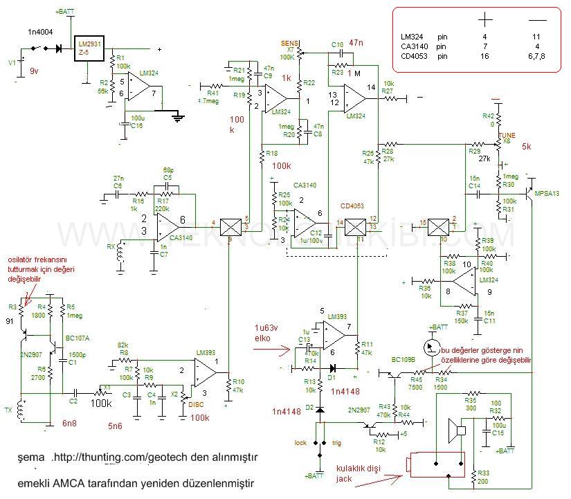

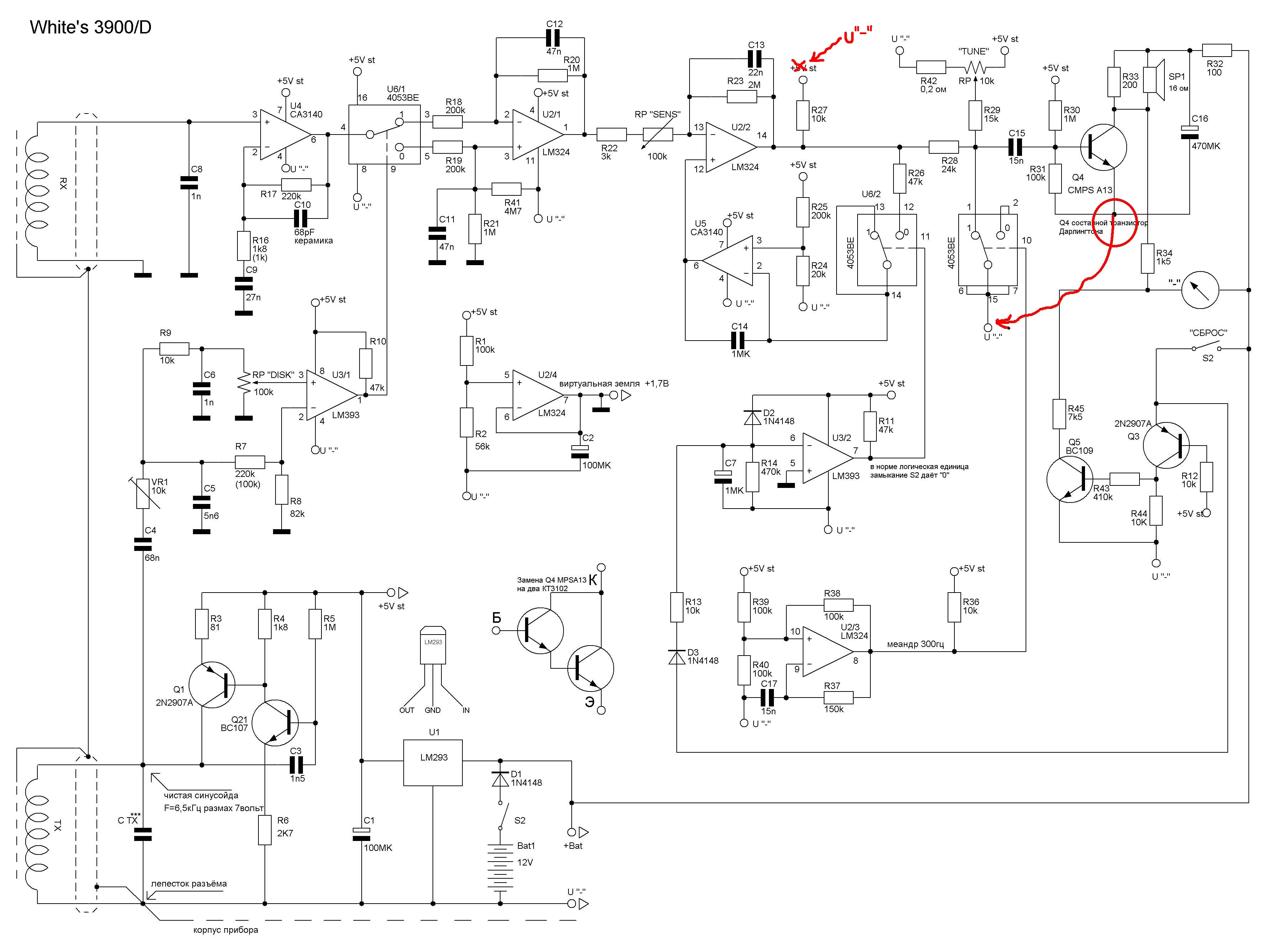

Did you set the Rx resonance to 4.5kHz???Originally posted by sayan1345 View PostThanks to all the friends who guide
I tested with a few handmade coils , from 4.5mh to 16mh , Neither was good

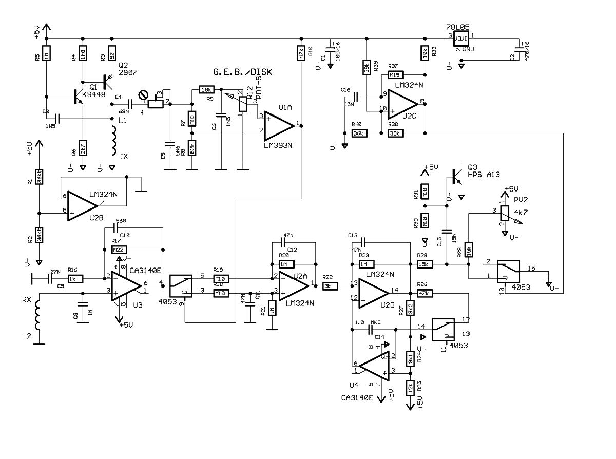

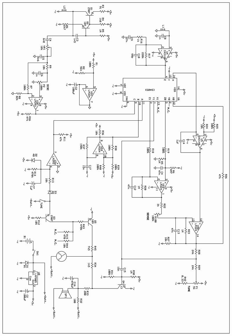

I have the schematic I got from the Turkish site , One user changed his pieces
I don't know if it's right or not
I send the schematic
[ATTACH]48197[/ATTACH]
Remember the Tx is set at 6.5kHz and the Rx resonance is set to 4.5kHz. This means you must put a parallel capacitor across the Rx coil.
For 16mH Rx coil, the capacitor is 78nF, I told you to use 56nF and 22nF in parallel to get 78nF.

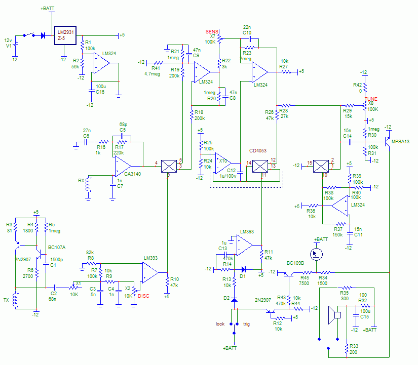

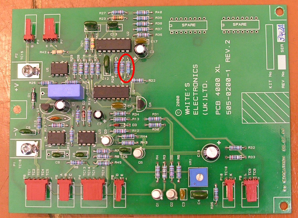

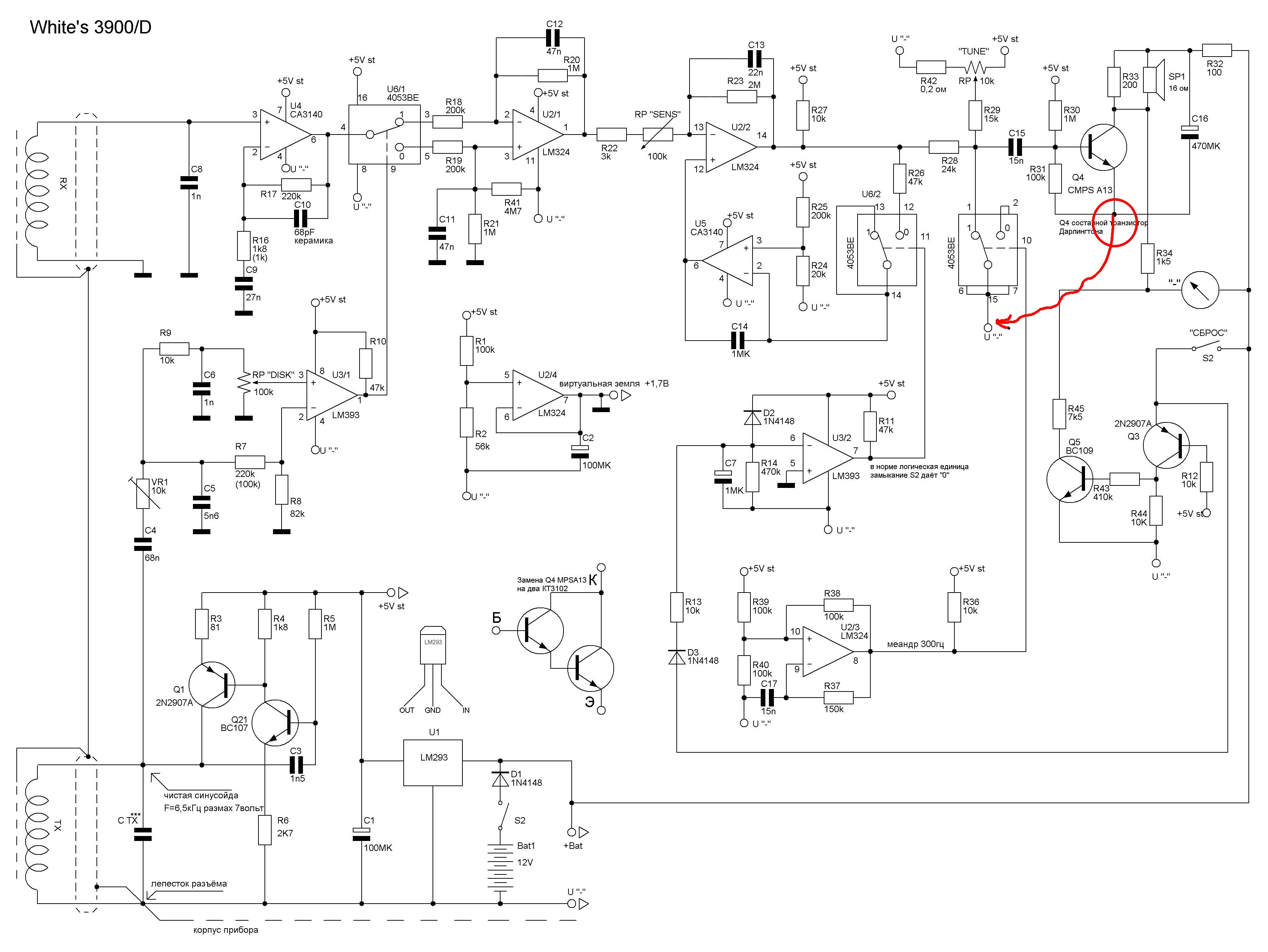

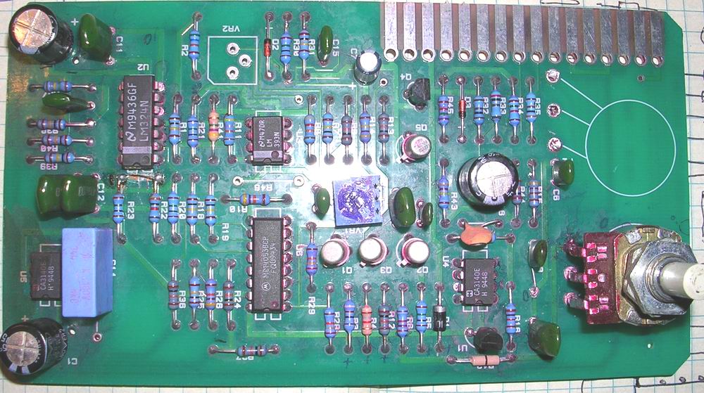

Originally posted by Artyom View PostHi everyone. There's another question. The diagram shows the virtual earth voltage + 1.7 V on pin 7 LM324. is this correct? The voltage divider R1, R2. There should be 0V.
Yes, this appears to be correct, have a look at R1 and R2 on PCB. They are 100K(brown,black,black,orange) and 56K(green,blue,black,orange) respectively. 4 band resistors. The only difference is the pin numberes for the LM324 on the PCB are different on the schematic, the schematic is for self made layout. So designer used different op amp pins in LM324 to set up the Common. But is the same thing.
I noticed the Transistor Q4 emitter must connect to -12V, not shown on the schematic.
R27 (pullup for output of U2/2) on schematic is wrong, it must go to u"-", not to +5V. This is how it is on the original PCB.
I'm trying to get the schematic to be exactly as what is shown on original whites PCB.Attached Files
So that when it is finally constructed, I can know that the scheme is exactly as it should be. This will help with troubleshooting the circuit if it isn't working right.
The Tx oscillator frequency is for sure 6.59kHz.
I will set Rx resonance to 4.68kHz.
