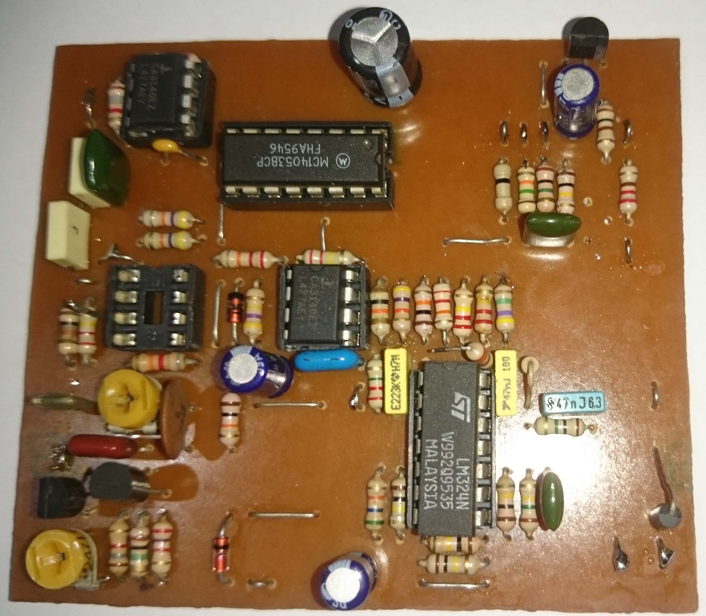

            This circuit works only disk part does nor work ...
            picture of my PCB .....

            my PCB is proteus file, if you want a proteus file I can send it for you
            thanks

              Yes, please post the proteus file here. You must put the file in a .rar or .zip archive first, then post on the thread.
              I am gathering the parts and tomorrow I will etch and drill PCB. I have only one 3140 chip, so I am going to use NE5534 chip for the front end as I see in 5000/6000D scheme. This mod may require some tweaking, but I think it should be fine.
              I have finished with the Sprint layout, so will be posting it as soon as I have checked that all is well with the layout and schematic.

                  Sayan, VR1 was measured in actual 3900D working circuit. Its value was measured to be 3.5K. So set VR1 for 3.5K.

                            One end of the 3.3K resistor is floating on the layout, I suppose you soldered wire directly to it for sensitivity pot.
                            Overall, the layout seems correct with the schematic, I haven't found any faults.
                            I am fairly confident that the circuit will work correctly. Only thing is the correct coil parameters and proper tuning of the resonant frequencies.
