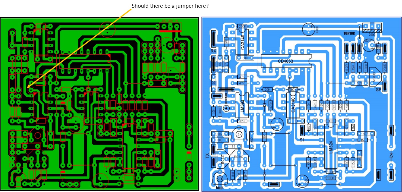

                            • #74
                              Hiya DB,,,,,I may be wrong but should there be a jumper across these two pads? Regards,,,Marty
                              • #75
                                Yes, also pin 3 of the nearby chip goes to wiper of discrim pot. I updated the layout. Thanks for pointing that out.
