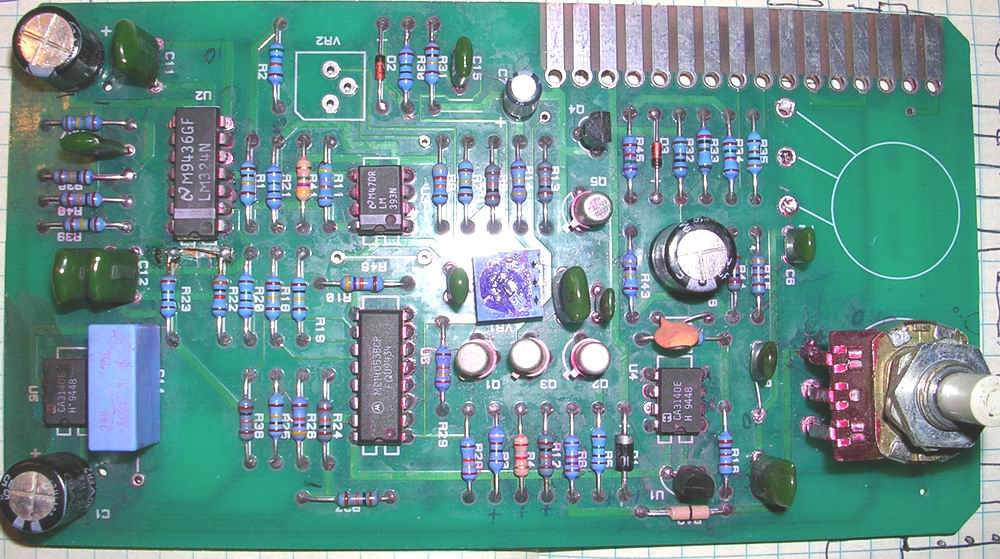

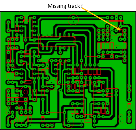

    For whatever reason, Q3 and Q5 were left out together with the surrounding components. However this circuit (Q3,Q5) is part of the original 3900, so maybe I'll try to stick it in somewhere on this layout if I can find the space.

        Hi DB,,,,Think I found a missing track as well,,,From the Cap to the SP output. Regards,,,Marty
        • #79
          @DB,,,,Can a 'jumper' just be used in place of the '0.2r' resistor?,,Thanks, Marty
          • #80
            I think they meant to limit the full stop of the tune pot on one end to a voltage slightly higher than the negative rail, not sure why. But I think this calibrates the tuning range for the audio chopper.
            Thanks for spotting that missing track on pcb

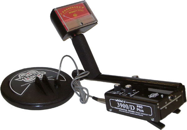

              3900ِِِِD
              picture of detector and coil

                Originally posted by gurdal View Post
                Hello
                Very good, but where is the big iron pliers waving across the coil to demonstrate the discrimation? The implication here is that the coil is not properly phased and the circuit will not discriminate.....nice try!

                  hi
                  yes you're right, coil hard work.

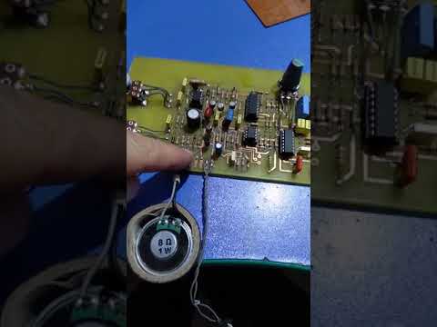

                  • #84
                    this VLF is not different that other. big iron pliers also gives good unferrous signal. this is sure normal situation.
                    in real conditions in ground rust shell around the target will reinforce the signal and kill all disc you wait from this detector.
                    we are back returning to HALLO/gallo effect matter, our loving melancholy winter time discussion.
                          Nonesense, a standard size iron pliers is surely REJECTED! Who can say what coil is in the video? Can anyone undersatnd the language?
