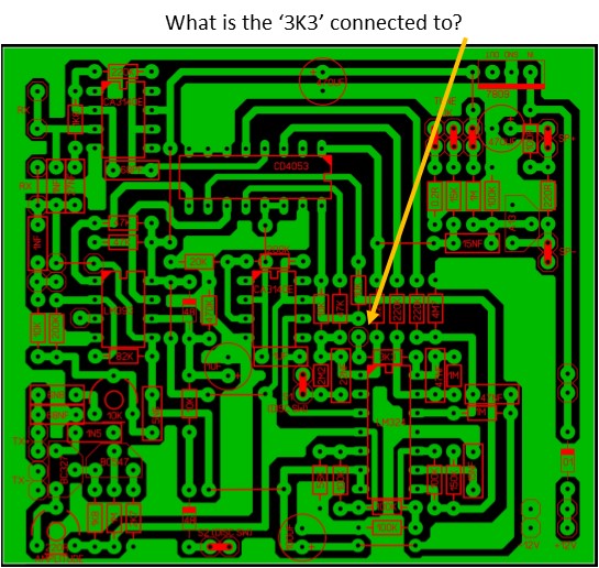

@DB,,,,,,I hope you don't mind but I labelled all parts on the silk and so you can print a Parts list off when making a DIY board,,,I can't see any more errors etc but was wondering if you could double check this too? Is this PCB alright to print off and build now as I wouldn't mind building along with everyone who's building it? Thanks,,Regards,,Marty

Don't proceed as yet. I'm in the process of checking over everything against the original Whites PCB to make sure everything is perfect.
Then I will post final layout for making PCB. This will be finished and posted today. I got my printer up and running so tomorrow I start to build for sure.

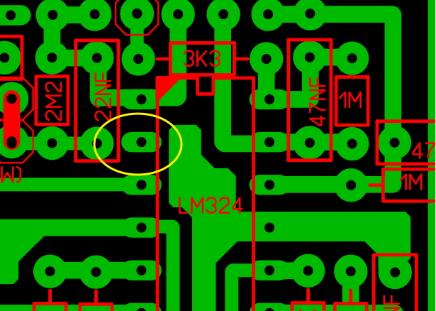

Ok DB,,,Thanks,,,It'll be nice to build another VLF Detector and I like the sounds of this one,,,I'll wait for your posting befre starting,,,When you mentioned the 3K3 is connected to the 'Threshold' I thought that the Threshold was marked up as 'Tuner' on this pcb? Where are the other connections for the threshold besides the 3k3 pad? Thanks again,,Regards, Marty

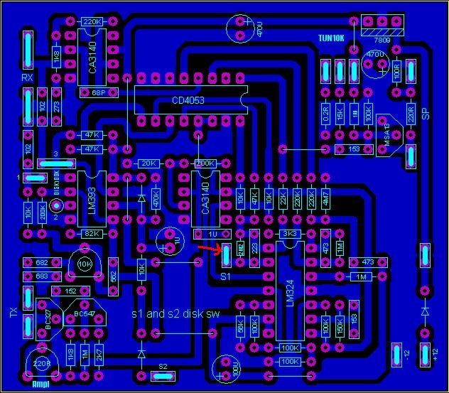

It's the "sensititvity" pot on the schematic, I made a mistake calling it "threshold". So one end of the pot goes to the 3.3K and the other end is tied to the wiper and goes to the point indicated on the board as indicated in pic. Which side is tied to the wiper, I'll have to see when operating the circuit for increasing /decreasing sen. clockwise/anticlockwise. At this point, I'm not interested in that.Attached Files

Here is my final layout. I intend to go with this one. The circuit is checked as best as I can, and everything looks good according to the original circuit. Any errors will have to be corrected afted construction and testing.Attached Files
