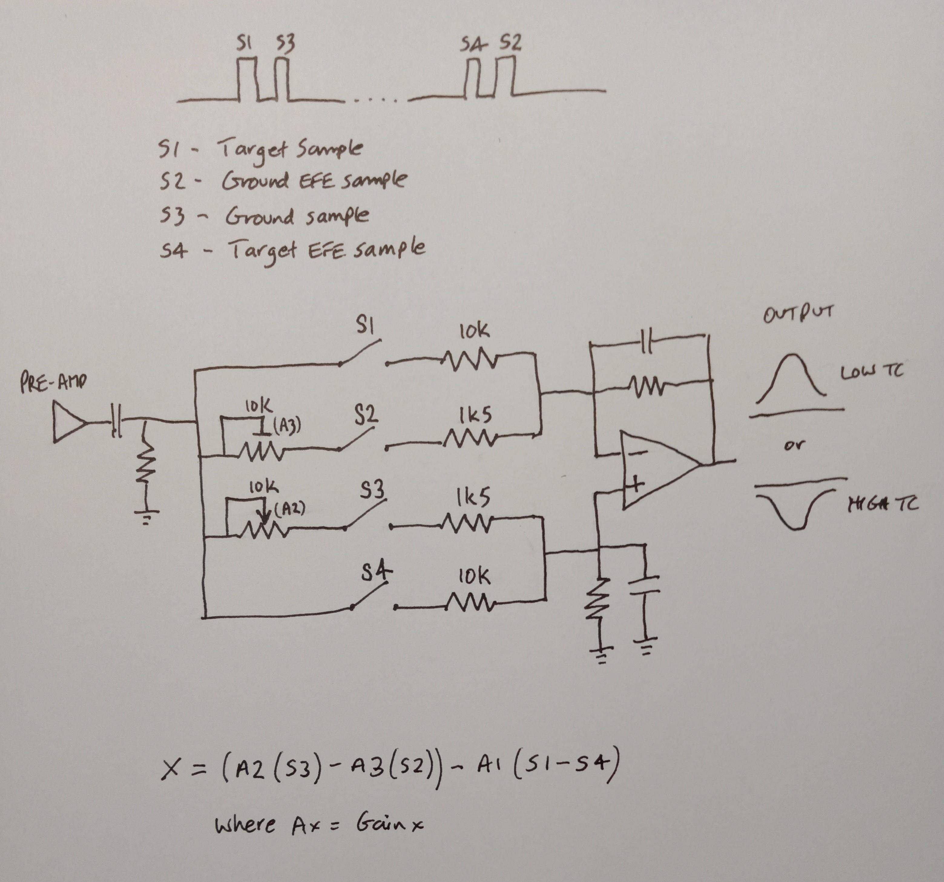

                        I’m currently working on designing a ground balancing Pi machine. My initial research identified that the standard Ground Balancing formula for a four sample design is:
                        X = A1 (S1 – S4) – A2 (S3 – S2) [Formula 1]
                        Where X = the resultant signal to be integrated
                        A1 and A2 are the gains for different sample groups
                        S1 = Target sample
                        S2 = Ground earth field effect (EFE) sample
                        S3 = Ground sample
                        S4 = Target EFE sample
                        As the EFE samples are reasonably static, you are meant to be able to take two different (albeit consecutive) EFE samples, and they should be the same, therefore the S2 and S4 will cancel out, leaving just the target and ground samples to process.
                        When A1 (S1 – S4) > A2 (S3 – S2) it gives a positive response (i.e. When the target has a high time constant (TC), or in other words, the target response decays slower than the ground response).
                        From a practical implementation perspective, under formula 1, when you change the gain (A2) in order to ground balance the machine, it also affects the gain of S2, resulting in an EFE imbalance. Additionally, there are resistance tolerances in real world circuits which means that one of the EFE samples would ideally be adjustable separately (and permanently locked in) to fully cancel out the other.
                        To overcome these issues, I’m proposing a more usable/practical formula for consideration. I’m also proposing to flip around the formula so that High TC targets (relative to the Ground Balance set point) give a negative pulse response (like on the Whites TDI etc.), and Low TC targets give a positive pulse response, as follows:
                        X = (A2 (S3) – A3 (S2)) – A1 (S1 – S4) [Formula 2]
                        The gain of A3 would be independently adjusted to fully cancel out EFE from the equation, regardless of the GB gain setting (A2).
                        An example schematic of formula 3 is as follows: Click image for larger version
Name:	Ground Balance Schematic.jpg
                        Elliot

                            Hi Waltr.
                            My idea was mainly for implementation in an un-coded (ie discrete component) design. It can also handle a three sample method just as readily (by sending the one same EFE sample to both S2 and S4), but you still need to be able to adjust the gain of one of the duplicate EFE samples (even though S2 = S4) because of the differences in circuit path gain (e.g. resistor tolerances, and Jfet /4066 switch resistance tolerances).
                            Maybe I'm being too picky about unbalanced EFE effects, but it's just too easy to do it properly the first time, then you don't have to worry about it again.
                            Are you aware of any other potential imbalances that should/could be catered for?
                              The three sample method removes the issue of different component values since there is only the inverting and non-inverting sampling switches. It then is only the sample pulse timing (widths) that contribute.
                              In the discussion in my HH2 thread it was brought up that 'gain' (A1, A2, A3) verse 'pulse sampling width' is not the same, sampling width is not as linear. That makes the math difficult. However, we have a pot to adjust GB in the field so any non-linear effect is nulled due to simply turn the pot to obtain a non-response to 'hot ground'.
                              I am thinking that you are putting to much of balancing the EFE samples.
                              EFE is a very slow effect which is why they are taken far from the target & GEB samples. I do the EFE sample just before the next TX pulse. I haven't seen any indication that a slight un-balance of EFE sample to the target & GEB sample has any effect.
