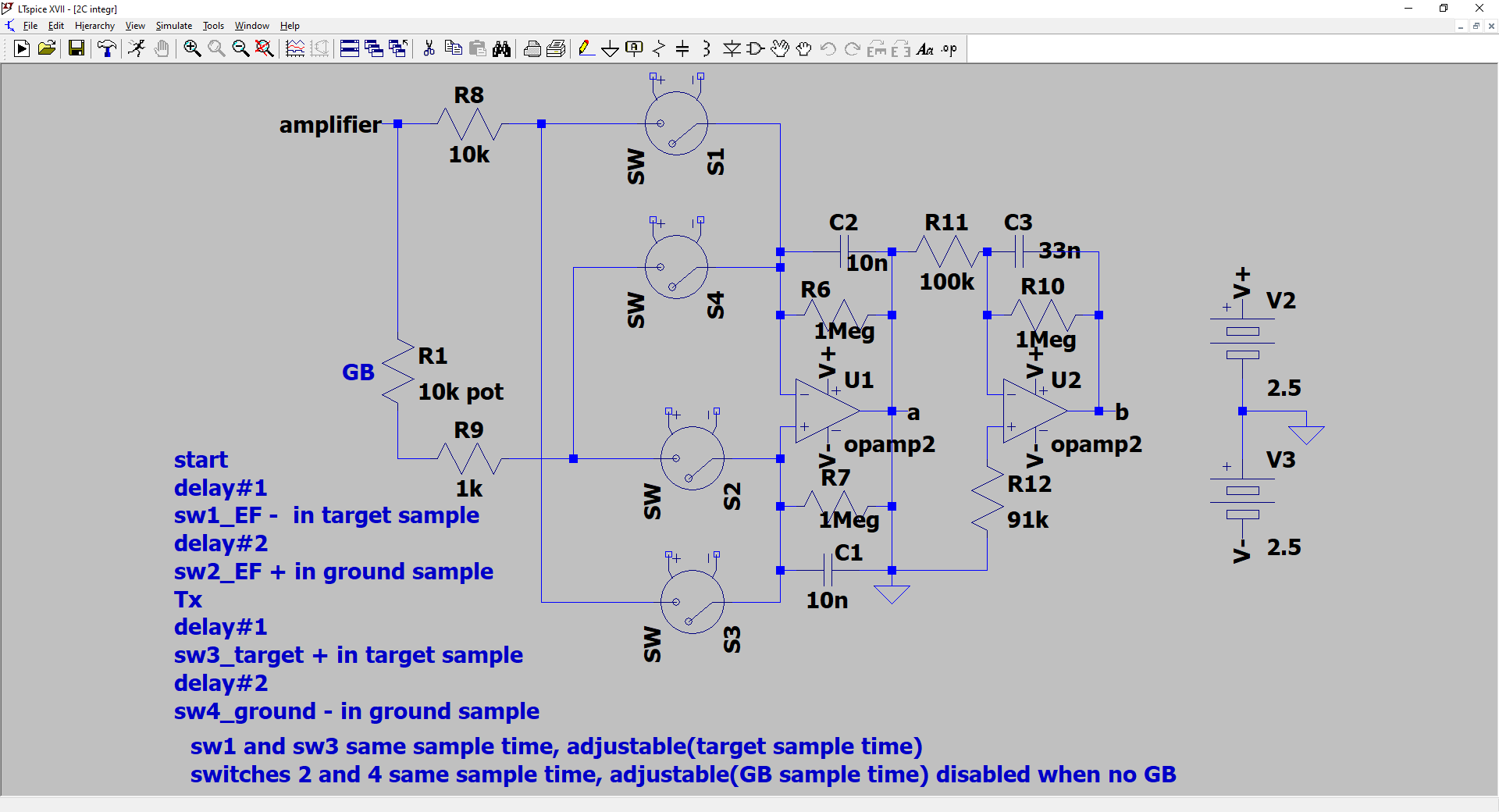

EFE sample -> inverting
Target sample -> inverting
GEB sample -> non-inverting
The pre-amp in inverting and SAT is non-inverting.
The SAT output should then be high going for long TC targets and low going for short TC targets.
If you find this the other way then simply reverse which sampling switch is pulsed, swaps which integrator input the samples go to.
When I first put this GEB code in the output polarity gave a low tone for long TC targets. I just swapped which sampling switch (PIC output pin) was used in the PORT defines.
