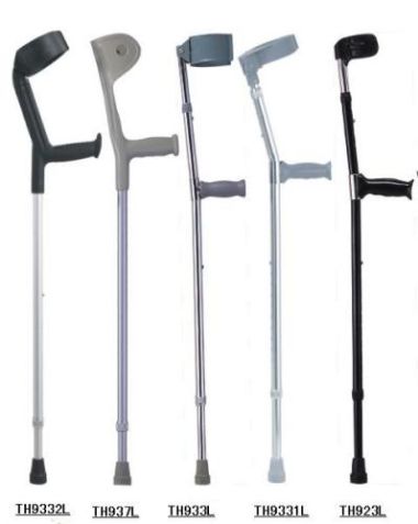

                          Ok Andre, I think with your progress here you have done a good job, thanks to Ivconic for giving us the modified GB scheme. If I have time I think I can build PCB, perhaps someday I'll post here. Your plan with PVC pipe, I've done it before, It's heavy to my arms, better if you use Elbow Crutches plus putting PVC on the lower rod, the bottom end is mostly 20mm diameter shaft, I put PVC at the lower end. Again, thank you for your updates of this project!

                            Great!!!!!!
                            Elbow crutches - How come I didn't think to use this thing?
                            Thank you!!!!!
