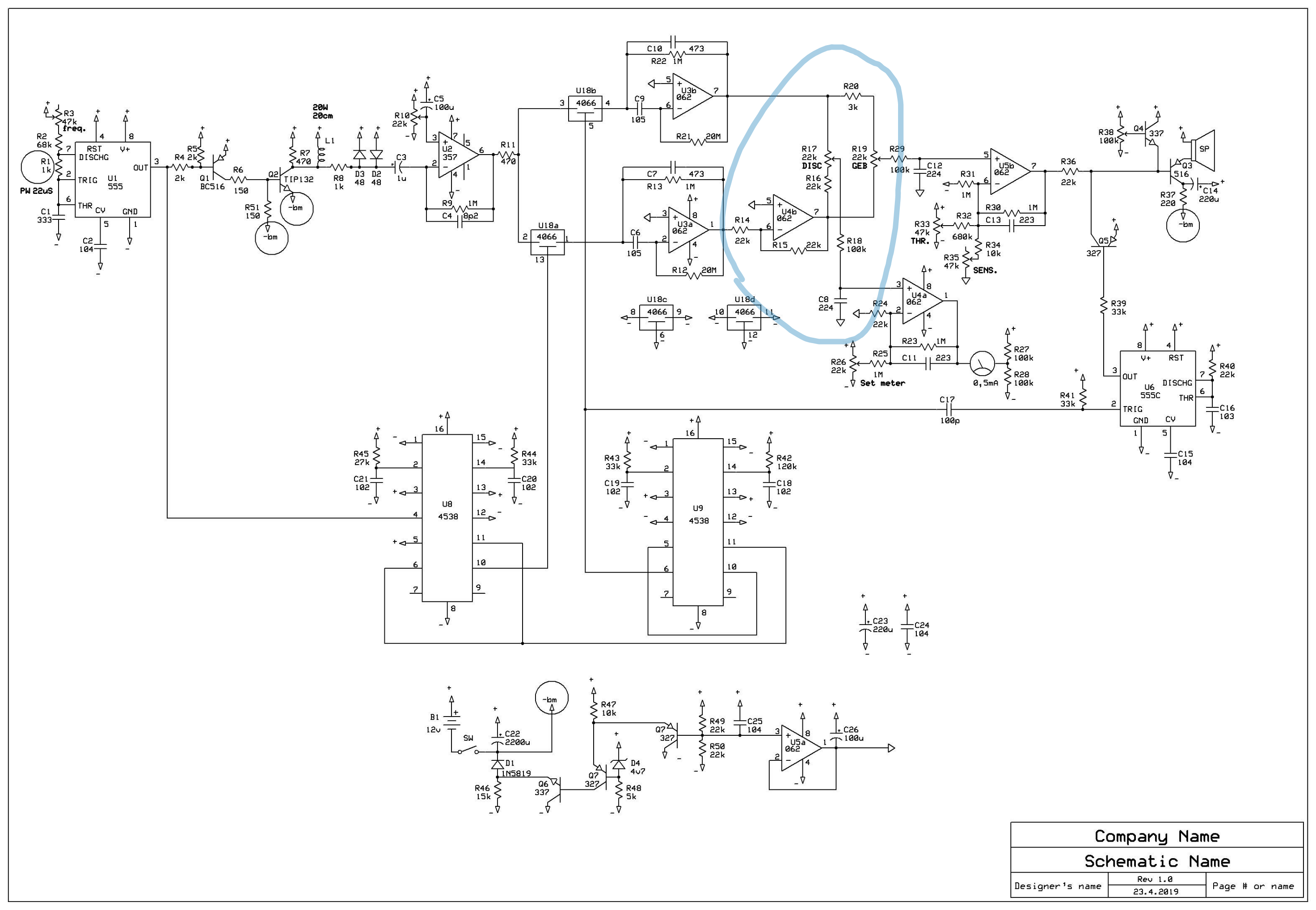

    Originally posted by DavidB View Post
    If you added a 3.9k resistor from the inverting inputs to what they are calling VDD on the original schematic then you would have a buffer with a gain of 1 with less noise and the offset pots would be much easier to adjust.
    I can try this!
    Thanks!
    • #47
      DavidB,
      There was no significant change in the adjusts, but I left the resistors there.

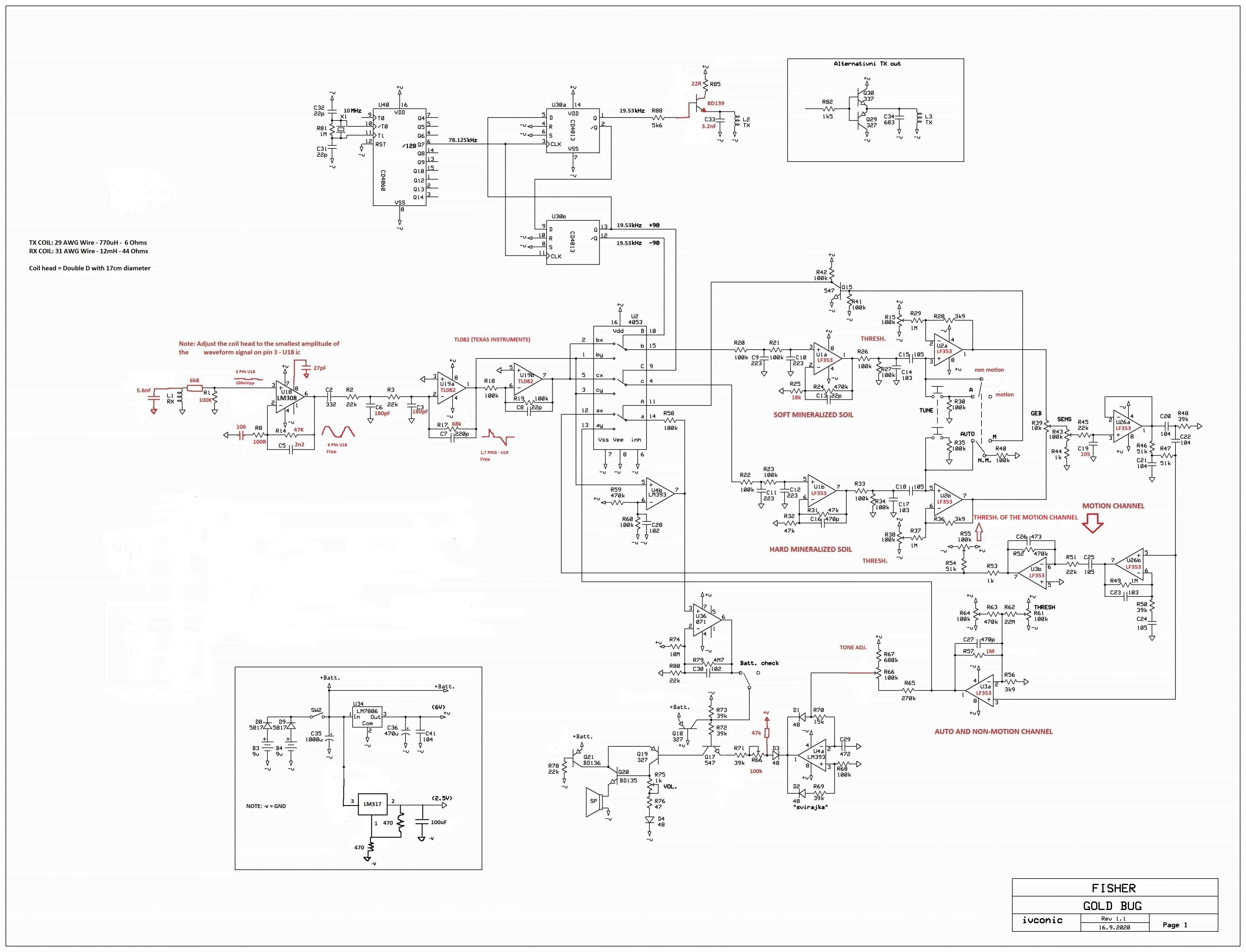

              I got back to work on the Fisher Gold Bug I project perfectly adapted by our dear Ivconic. I got great results, but as with the original Fisher design, there is no iron discrimination step as there is in the Gold Bug II. Does anyone have any idea how a discrimination stage could be added to the circuit, which I leave attached to the post?Click image for larger version

              • #52
                Dear Andre, glad to see this progress. Just looking that schematic similar to sascho PID here's drawing from master Ivconic, try if that work.Click image for larger version
                • #53
                  Dear OP04!!!!!!
                  Thank you!
                  I'll try to make it work! I'll post the results!
