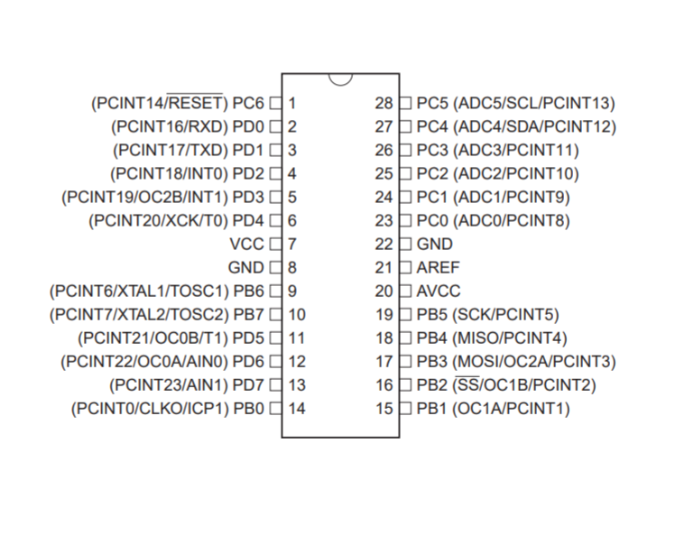

            Is PD2 pin 4 of the Atmega328p? Is this here I place the Reset button to? Thanks, Marty.
                        Yes It Is. Look at the picture please:
                        Look at the new schematic carefully please, you don't need to place It anymore.

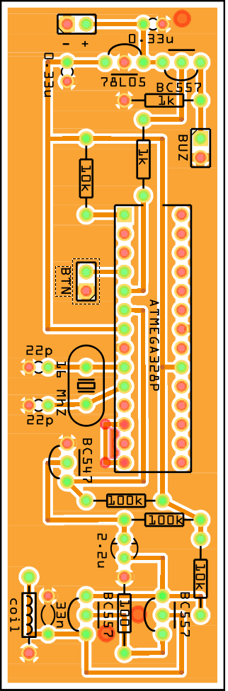

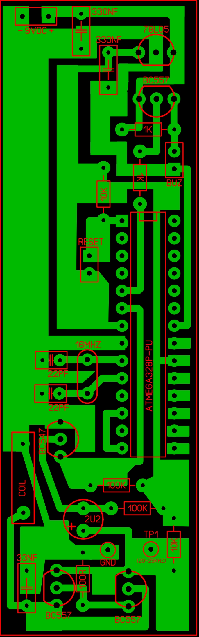

                              this is my finished pcb and revised to version 1.2 loaded by void118, i used ground fill, then you will see the seeds where gnd are connected, you can follow the tracks and compare with your pcb
                              9v and btn seeds are not seen but are connected to gnd

                                thank you! i would say we are ready to build pcb!
