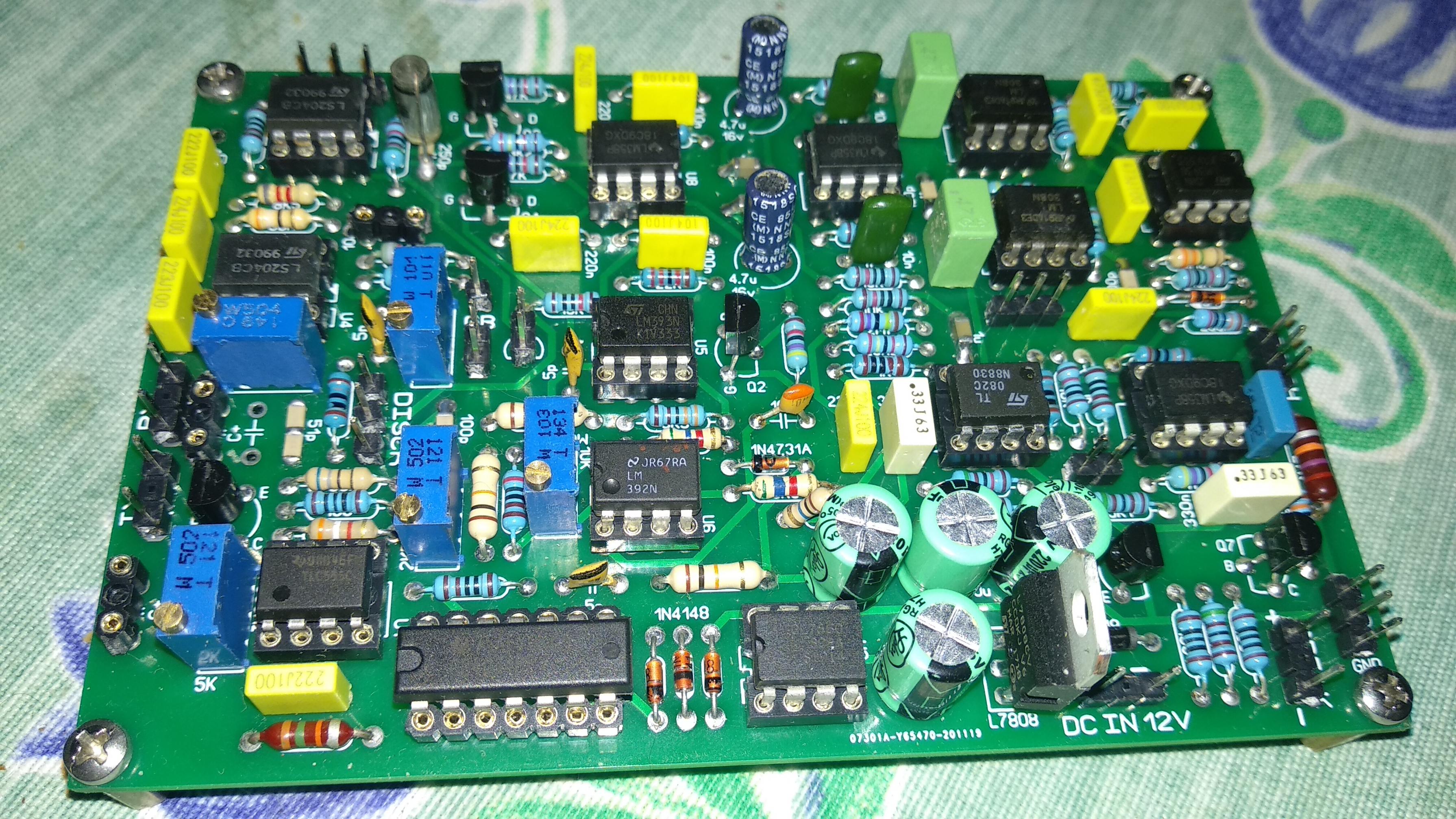

Excellent jam, you inform us about your progress. I've had to let it dust my PCB, I've been busy with other things. I see that LOBO is very difficult to make it work, I see several different schemes in various LOBO forums, there are some that have been successful and others have not, you have to be patient and read the forums to be able to deduce which error one makes at the same time there are so many details that one does not know which is which.Originally posted by mermelado View PostWell gentlemen, I finally have all the PCB components assembled, except for the capacitors whose value must be determined by trial and error, now I am going to make the coil. I will report on my progress.
[ATTACH]56143[/ATTACH]
Thanks Ruben:
I must be a masochist. Look that there are well-documented projects and I get to ride the Wolf "LOBO". I guess I like challenges and since basically all Treasures are very similar, I think that my great experience failing with TGSL will help me
