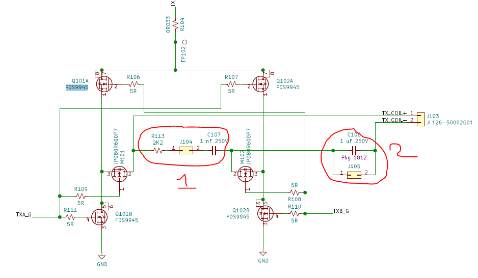

          Greetings. Studying further the question of constructing (repeating, to be honest) a TX cascade for the possibility of working both on resonance and with full bridge mode, I did not find anything better than this solution: https://www.geotech1.com/forums/foru...gle-full/page2
          as they say: all the best was invented before us. There is no need to reinvent the wheel.
          But there are questions....
          1. Figure 1: I understand that this is a RC-snubber for quenching bursts. This chain is optional: can it not be installed?
          2. Figure 2: Is this capacitor provided for the possibility of operation in the sequential resonance mode? If the need arises. So?​
          3. I understand that mosfets should be chosen not only according to the permissible voltage and current, but also according to the minimum gate capacity in order to ensure the best performance of the cascade. Right?

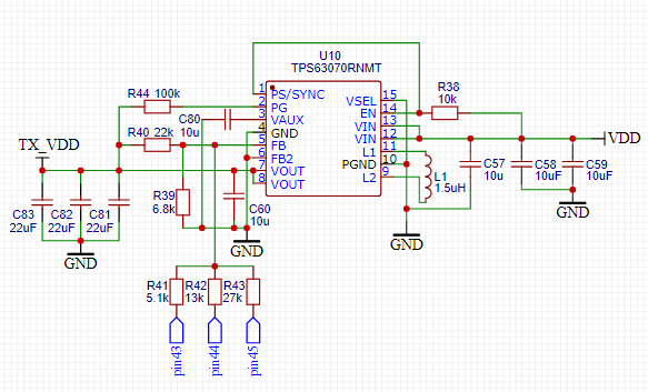

          4. As a voltage regulator, I can consider such a circuit. This solution allows you to adjust the voltage from 3.3V to 9V, providing quite a good current. Is this voltage range enough for a multi frequency of 2-3 frequencies? I understand that with such a small voltage range, it will not be possible to implement a single field for all frequencies using a single coil. But nevertheless.

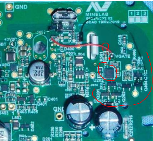

          4. Looking at the board from Minelab Vanquish 540, I saw 6 elements in the sot23 case. I understand that in this metal detector, such a cascade scheme of the TX that we are talking about is implemented. Right?Click image for larger version
          The highlighted element is probably a driver for management? Like a ТС4428 chip?

              Thanks! Thank you for the advice. This is very interesting and valuable information. At the moment we have settled on a scheme with a full H-bridge.
              ____
              By the way, the use of 199 did not justify itself: if the output signal form is still acceptable at a low frequency, then at a high frequency (after 20 kHz) there are already small signal distortions "in the switching places" of mosfets.​
                By the way. Earlier I wrote that the TX cascade was built on the DRW8833 chip. Well ... It also does not work correctly in this cascade. It has its own fixed value of dead time. 450ns So it doesn't fit either. Now, as I wrote, the full bridge works on two mosfet assemblies (IRF7105) and the IR4428S driver
