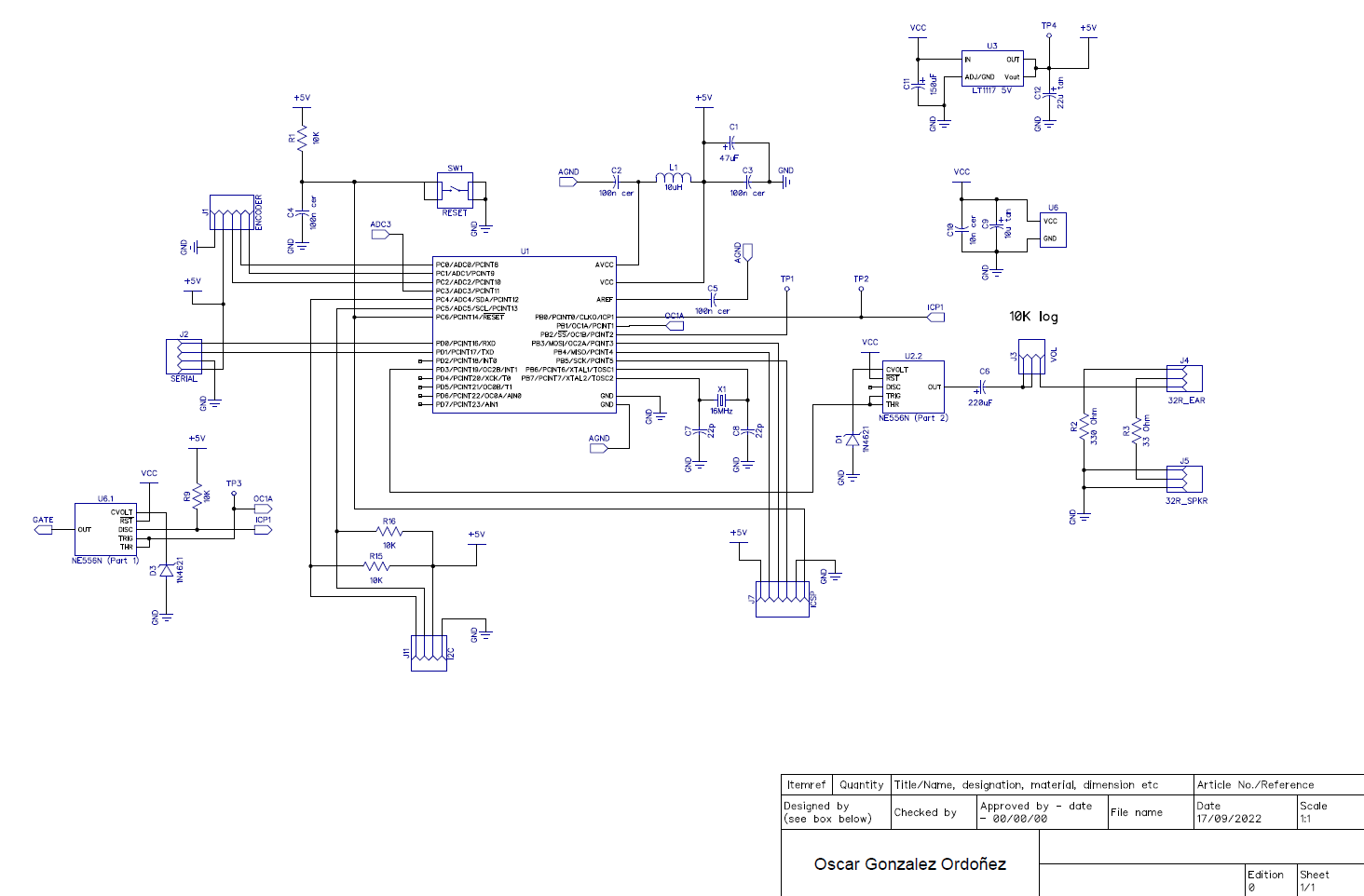

    I'm sharing the backend of my PI detector, a tried and true working design with firmware.
    The MOSFET is driven by PWM output OC1A of Timer1 and 1/2 of the NE556.
    Audio is driven by PW2 output OC2B and the other half of the NE556.
    The analog signal is sampled by the ADC (1st. 2nd. and EF samples) and filtered digitally (9-tap median filter -> low pass IIR filter).
    The IIR filter has a coefficient of 1/64 and a gain of 4 to increase resolution to 13 bits (provided a minimum noise level of 1.5 ADC bits).
    It includes:
    1. MCU Atmega328P (DIP - 28 )
    2. Gate and audio drivers NE556 (bipolar version)
    3. I2C interface for 16x2 LCD display
    4. Rotary encoder for menus.
    5. Serial connector (for debugging, bluetooth or anything you want to do with it)
    6. ISP connector for programming (USBasp, STK500 and compatible).
    Connections to your own front end:
    • Gate: to the MOSFET gate, N-channel.
    • ADC3: from the amplifier. Max 5v and referred to MCU ground.
    VCC is your frontend voltage, maximum 12V. The MCU 5V is derived from this by regulator U1.
    AGND (analog ground) and GND must be connected to each other as close as possible to the MCU.

    PI backend Atmega328P.pdf
    Diptrace schematic
    PI back end Atmega328P.zip
    Please share your own modifications, PCB's, frontends, etc.

    PS: diodes D1 and D3 are 3.6V zeners, 200 mW.

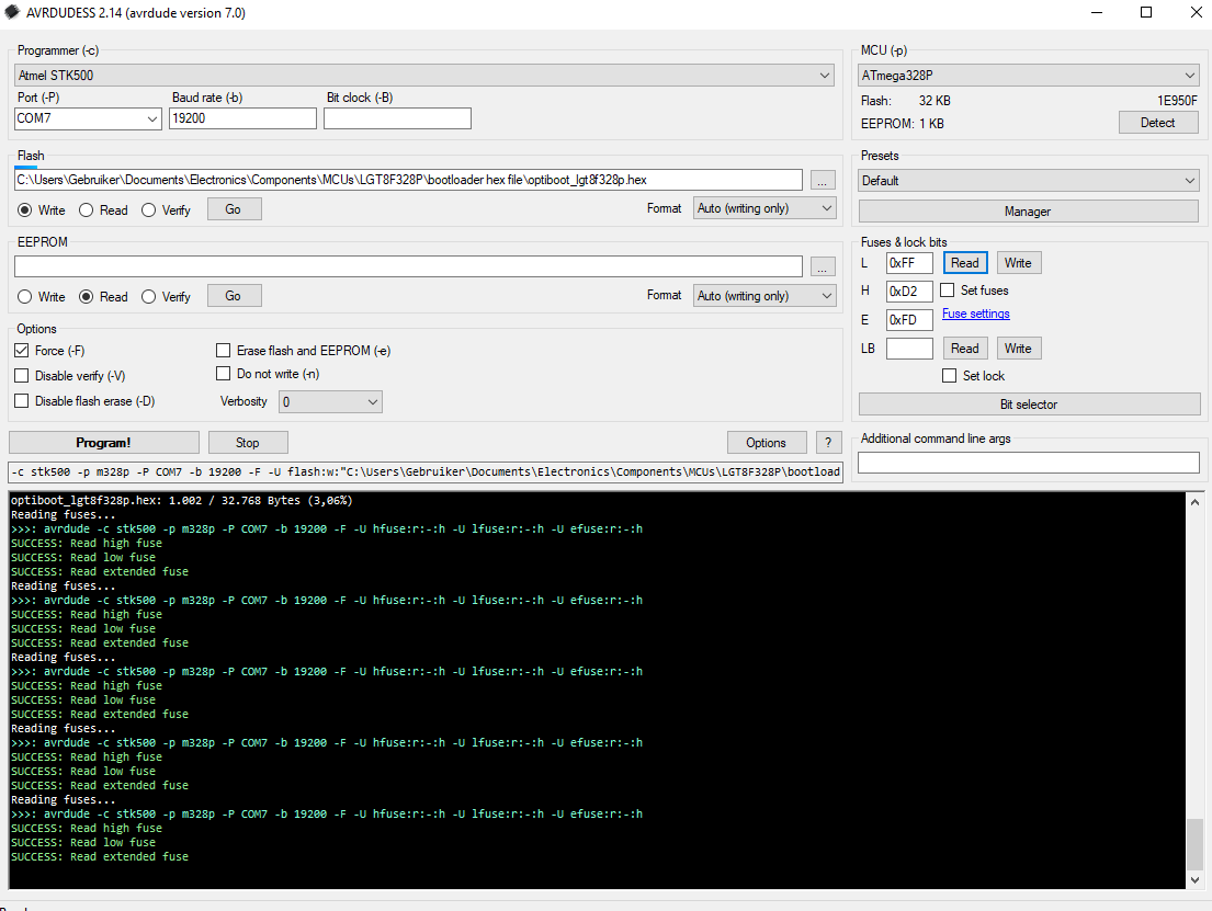

        Fuse settings for a blank Atmega328P. Program via ISP with avrdudess.

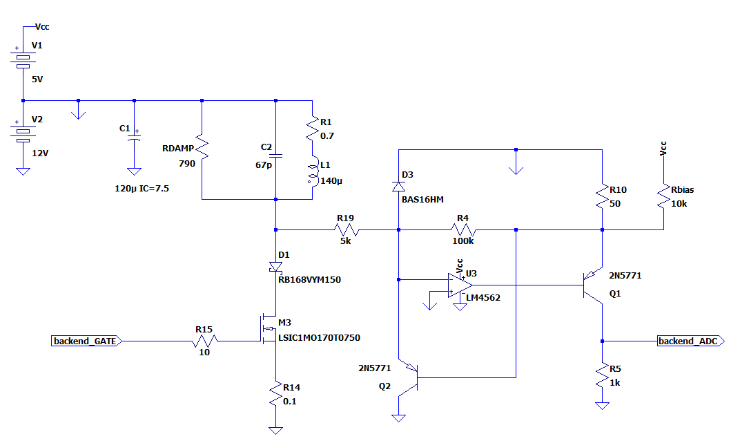

                      The front end is also minimal, just the MOSFET and a preamp with low gain around 20. The ADC is set to a 1.1V reference, it can be changed to 5V though but sensitibity will suffer.
                        This is what a front end might look like.

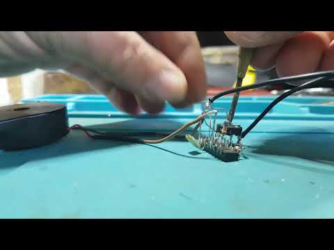

                          Simple analogWrite() on any digital pin available:
                            In AVR arduino, analogWrite() generates a PWM signal with a mere 256 discrete steps (duty cycles), so you'll get only 256 different frequencies with your 4046. Not equivalent to a pot as in the video, but rather to a jumpy pot and sound like a Nintendo.
                            Instead, generating the frequencies directly as per this firmware, using registers OCR2A and the Timer2 prescaler, gives you a much finer resolution and dynamic range in increments of 1 bit. You can go from a minimum of 30Hz to a maximum of 16MHz is steps of less than 2% of the desired frequency.
                            I mean, it's your choice but as the author of the firmware I wouldn't advise to go that road.
                            Minimum 400Hz - maximum 800Hz in 400 steps. Smooth enough (That's a 0.7g gold nugget)
                              You are absolutely right.
                              But that video is confusing me now!?
                              I hear the nice linear audio on it that I've been thinking about all along.
                              And earlier on one of the videos I heard different behavior. That's why I proposed the changes.
                              255 "states" on a 10k potentiometer (from my video) is not a very "linear" sound. It's more "graded" than yours from that video.
                              I don't know which video I saw where I thought it was too "graded" and logarithmic.
                              Ok, for now your solution is definitely better.
