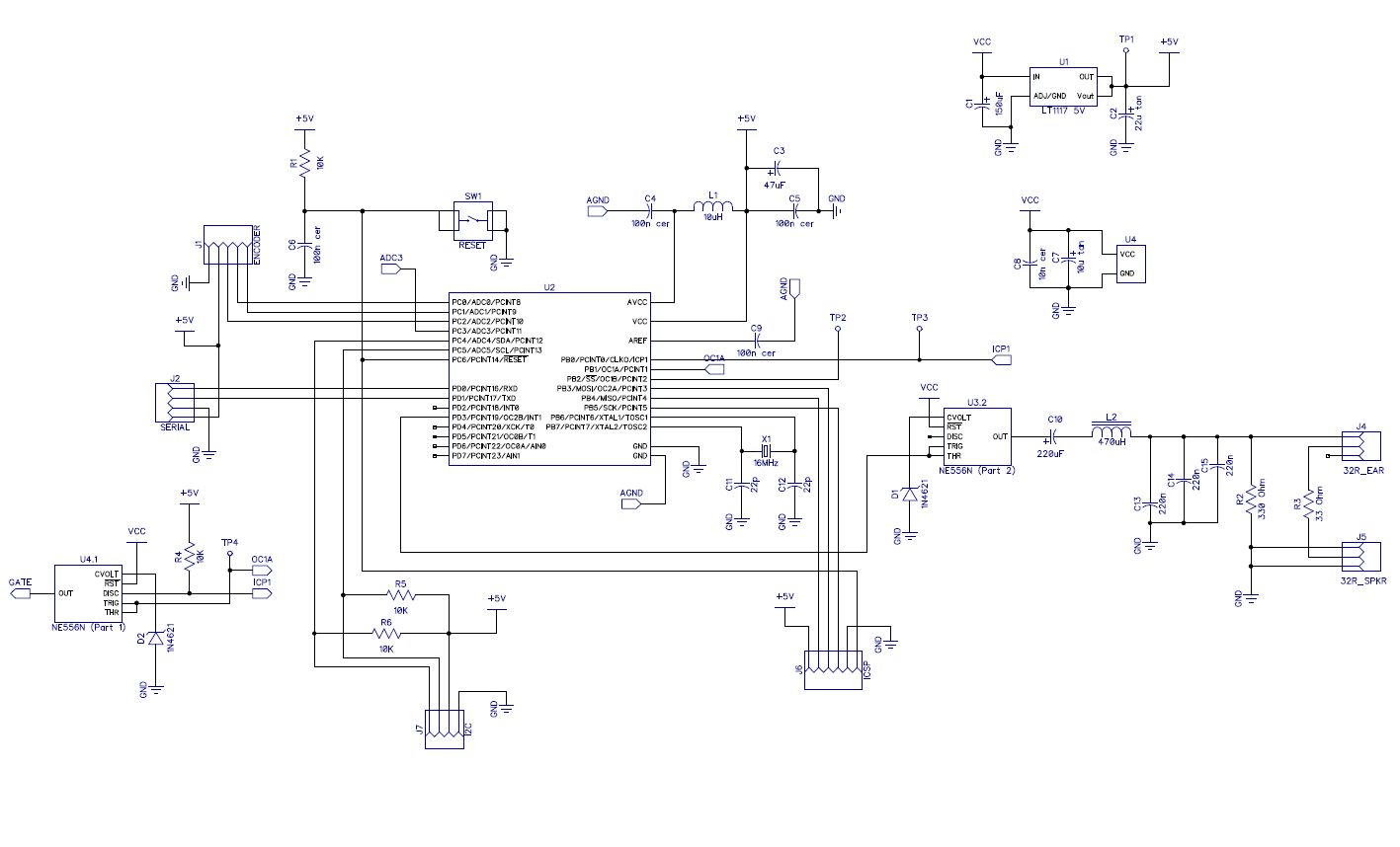

    Updated schematic, DipTrace file and firmware for the digital volume version.
    The median filter had to be scaled back to 5 samples due to the extra overhead by the PWM interrupts.

      Please excuse the dumb question but I assumed the audio to be a PWM frequency within the selected range in software ie 400-1000Hz. How does the timer convert this high freq PWM to audio?
      • #48
        It's explained here in detail.
        This library is good for any Atmega328P board to generate square waves at controllable volumes. It replaces a mechanical sound pot by programattically setting the volume via a menu and up/down buttons, rotary encoder etc. It can even modulate the sound with attack, sustain and decay to (see examples inlcuded in the library).
