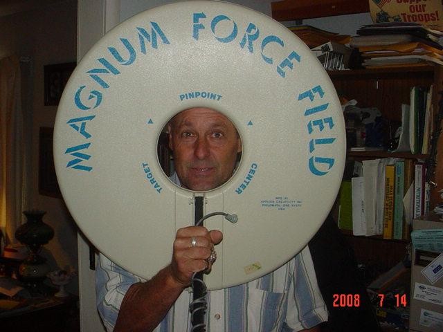

            The MPP would also work with a large coil, but the coil must remain within the coil specifications. The timing can also be adjusted. Generally, it should also work with large coils and modifications. The disadvantage, however, is that with a large coil, you won't find small coins, only large caches.​
              hello
              GMT KING COBRA would also work with a large coil. we say now about the COINS, not the cash. Click image for larger version
