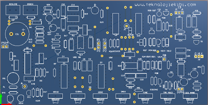

do not put it on first stage. check DP in real hunting. you have to get working detector and learn a sound.Originally posted by Tahabns1 View PostC30 what about it! Where to put it ?
then after some experience solder it on bottom pcb side. this is tantalum cap.
with it you will not hear a sound on turn on and no need to press RESET knob,
because automatic SAT reset going.

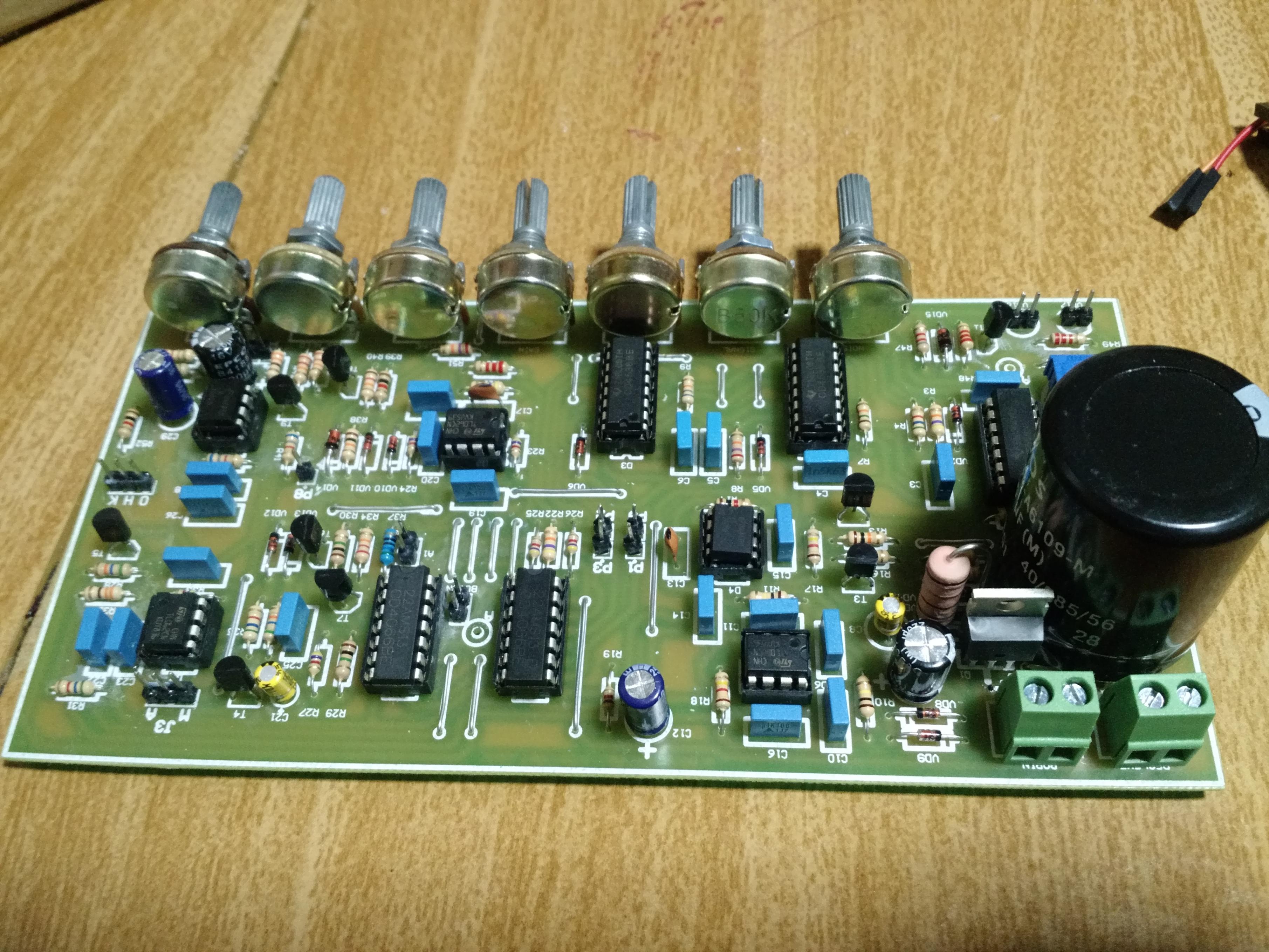

Squeaky start, wobbling, not good, ringing.Originally posted by Emersonpaz View PostHello yes it worked perfectly and with great gain https://youtu.be/BfpYdZ_0KjU
Not damped well.
What's the story with "dozen" knobs on front panel!??
Usually is desirable to simplify it and decrease number of front panel commands.
