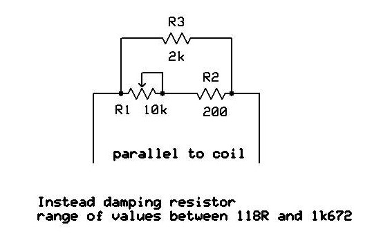

          Use Qiaozhi's method to distinguish best damping resistance for that particular coil.
          "...Adjustment of the damping resistor is usually done by monitoring the pre-amp output. With a 10k pot in series with a 270R resistor, and both in parallel with a 1k2 resistor;
          connect this across the coil, and adjust the pot until you achieve critical damping (no ringing in the pre-amp signal). Disconnect the resistor network and measure the resistance,
          and then fit a damping resistor of the nearest preferred value

          • #50
            Thanks for the tip buddy. actually the damping resistor must not be correct as there is no adjustment for this coil.

              • #52
                I did a video on making the damping resistor jig here:
                https://youtu.be/CrJ5tFFmWyo

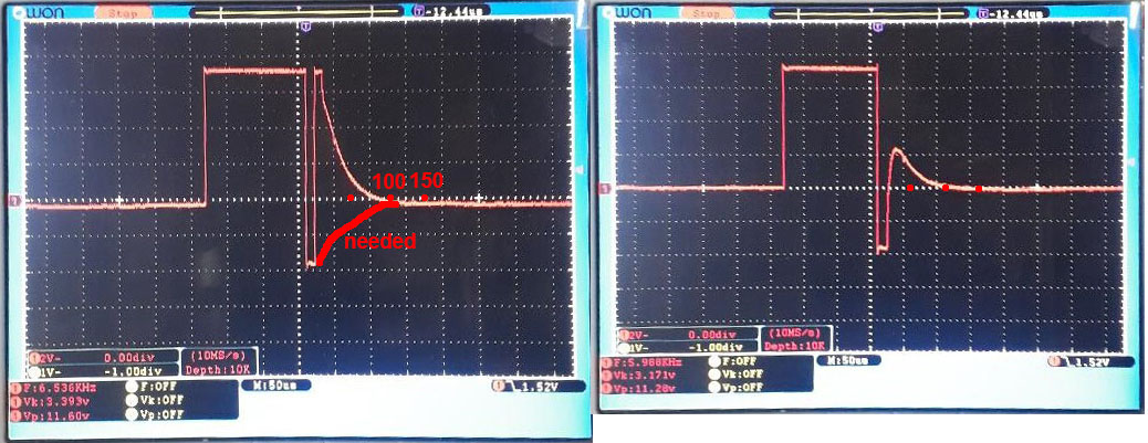

                • #53
                  not so actuel for Delta Pulse. why? looking the pic.

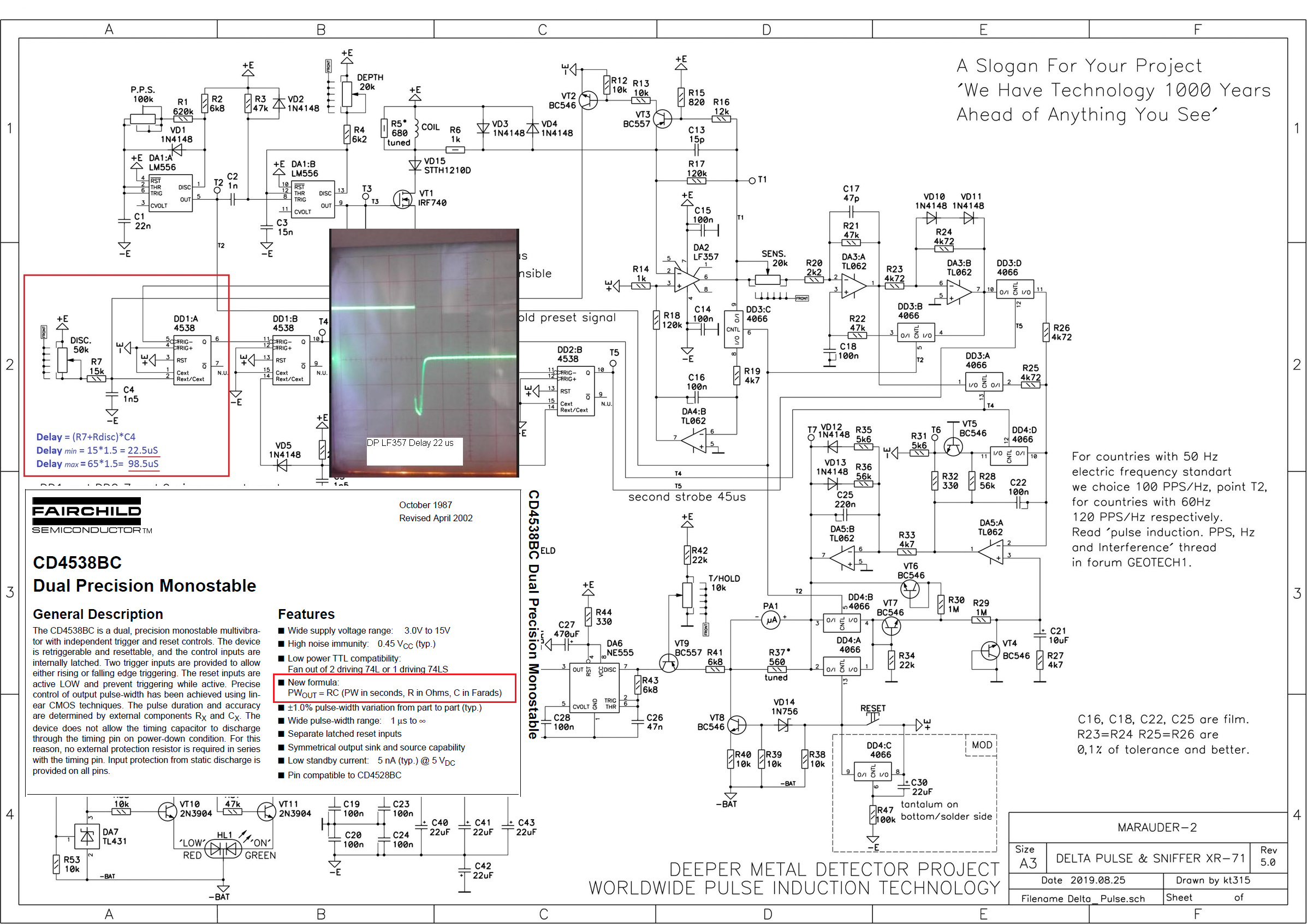

                            • #59
                              and work with Delay in the middle (>=45uS)
                              minimal FIRST SAMPLE DELAY in DP is 40us. it is not middle.
                              pleasure
                              • #60
                                Hi Anatoliy!
                                Maybe you mentioned some other DP circuit with modifications? Yes DP will be more usable with first sample greater than 40uS.
                                In my circuit i have 22-100 uS range.
