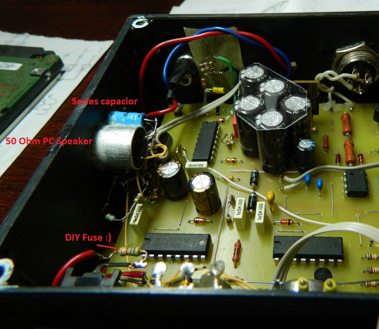

          Can we use voltage dividers (using resistors) across 12v power supplies +ve &-ve to supply power (6 v) to an additional LM386 amplifier circuit on delta pulse.
          If yes where should we place these resistors ?
          Sorry !! i have a very little knowledge on electronics..
          • #65
            OR is it better to connect a DC to DC buck converter ?
            • #66
              This is really bad idea, don't use any audio amplifier with DP. Why you need additional amplifier? Maybe your speaker is bad or it connected without capacitor (in series with speaker), or capacitor connected with wrong polarity.
              I use tiny speaker from PC, and i even taped it with paper scotch when i do tests on table, otherwise sounds to loud.
              • #67
                Thanks Vadim18 for your reply. I think you are right !!! I will follow your advice..

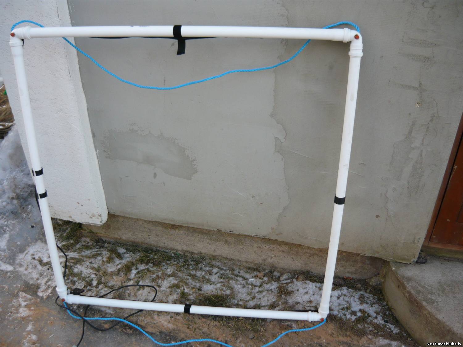

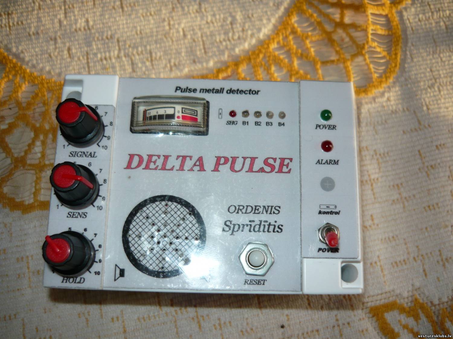

                          • #73
                            took pics from this link http://www.vesturesklubs.lv/forum/4-1461-1
