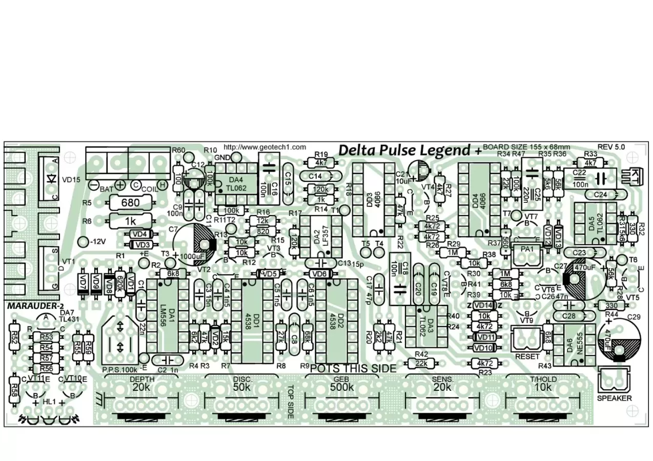

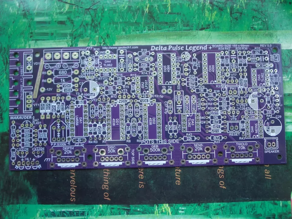

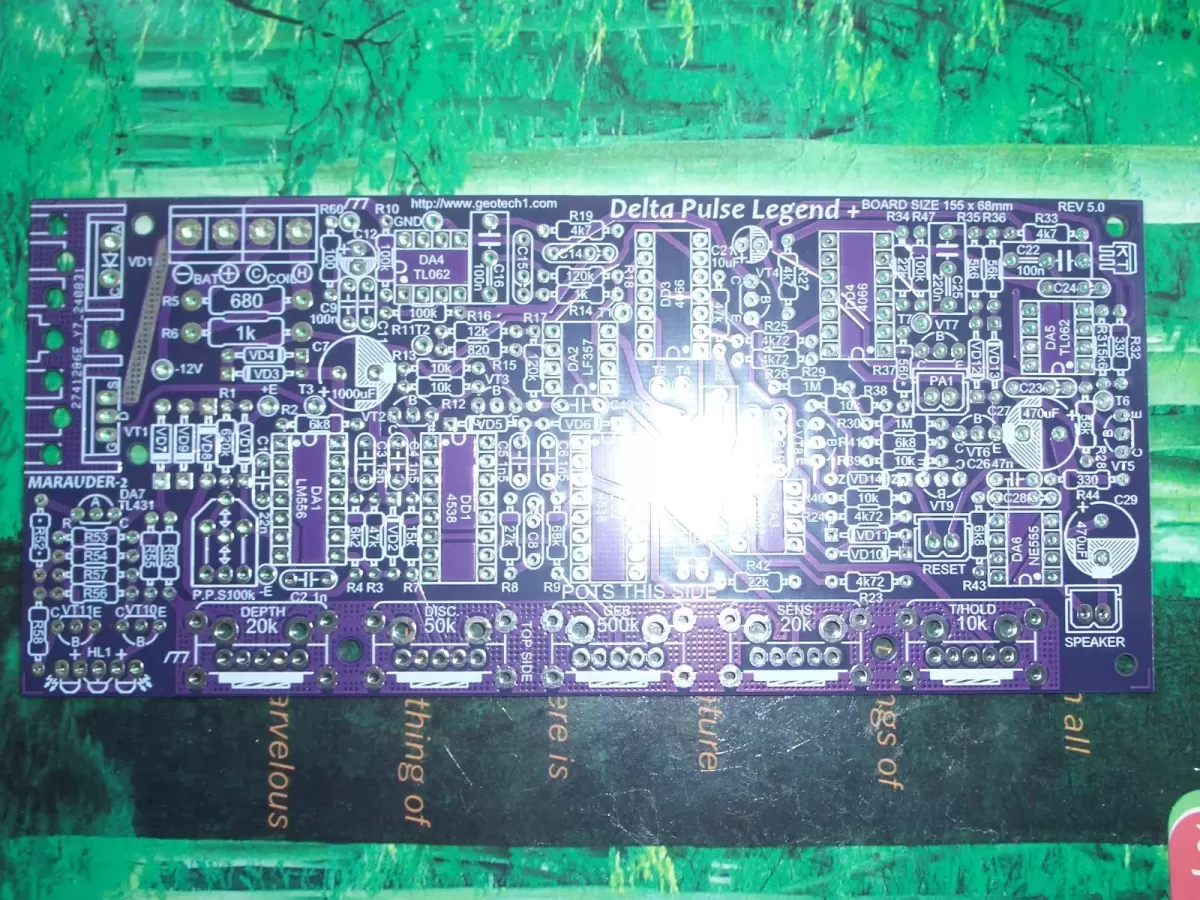

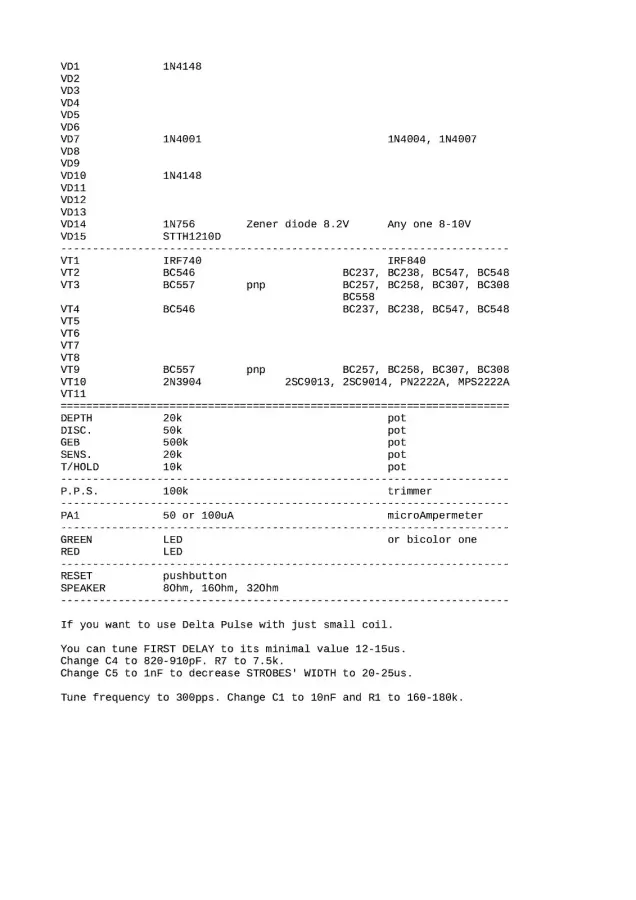

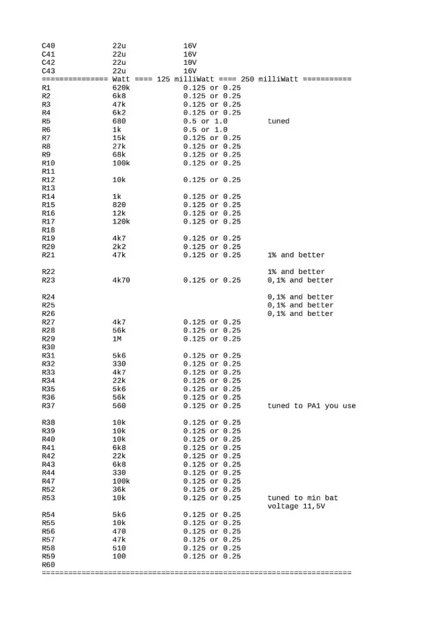

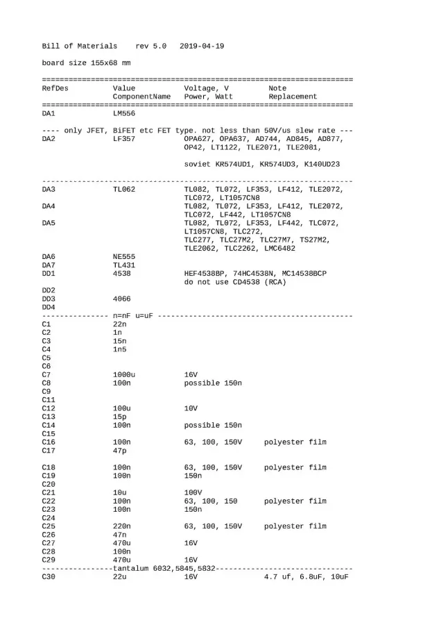

            • Hello Infamy,
              Here are the 10 documents & images that came with the Deltapulse board sales page. Of course, you had to save them yourself. KT315 only sent the bare board. But that's also what he wrote there.
              @KT315
              I hope it's okay if I attach the attachments from the sales page here.

                  Thanks for that, I have boards plural. What is the smaller second board for?
                  • Make some changes, for example, put an operational amplifier on the threshold, and other things. For example, instead of a 555, you can use a CD4046, etc.

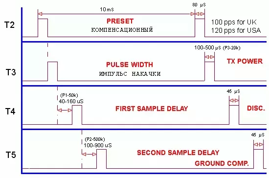

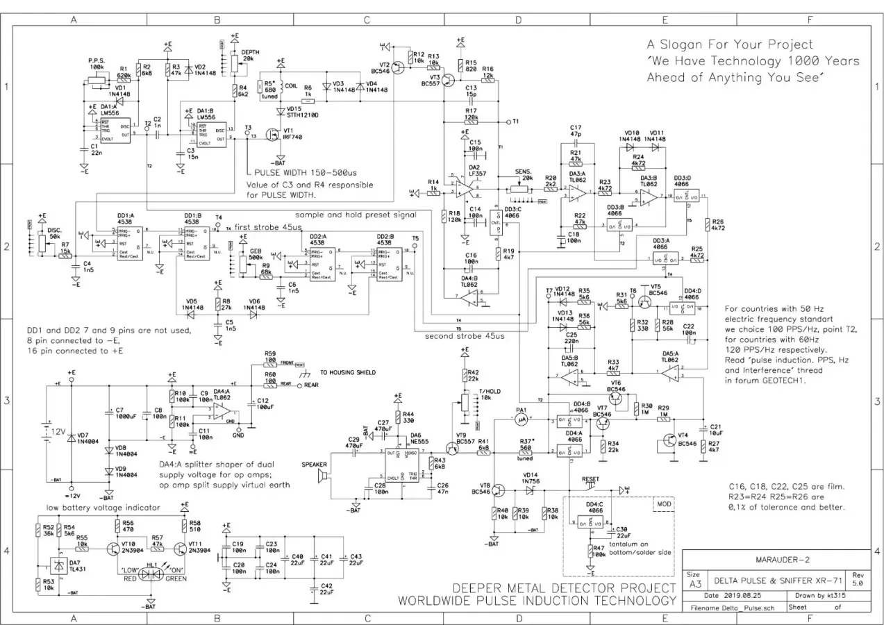

                              i can send file to file, if you so ask. i did that billion times in the forum. a schematic.VERY PLEASE do not ask me frequency's choice be cause it is at the sch WRITTEN-NOTED. Click image for larger version  Name:	dp_sch5.jpg Views:	0 Size:	826.8 KB ID:	439658
