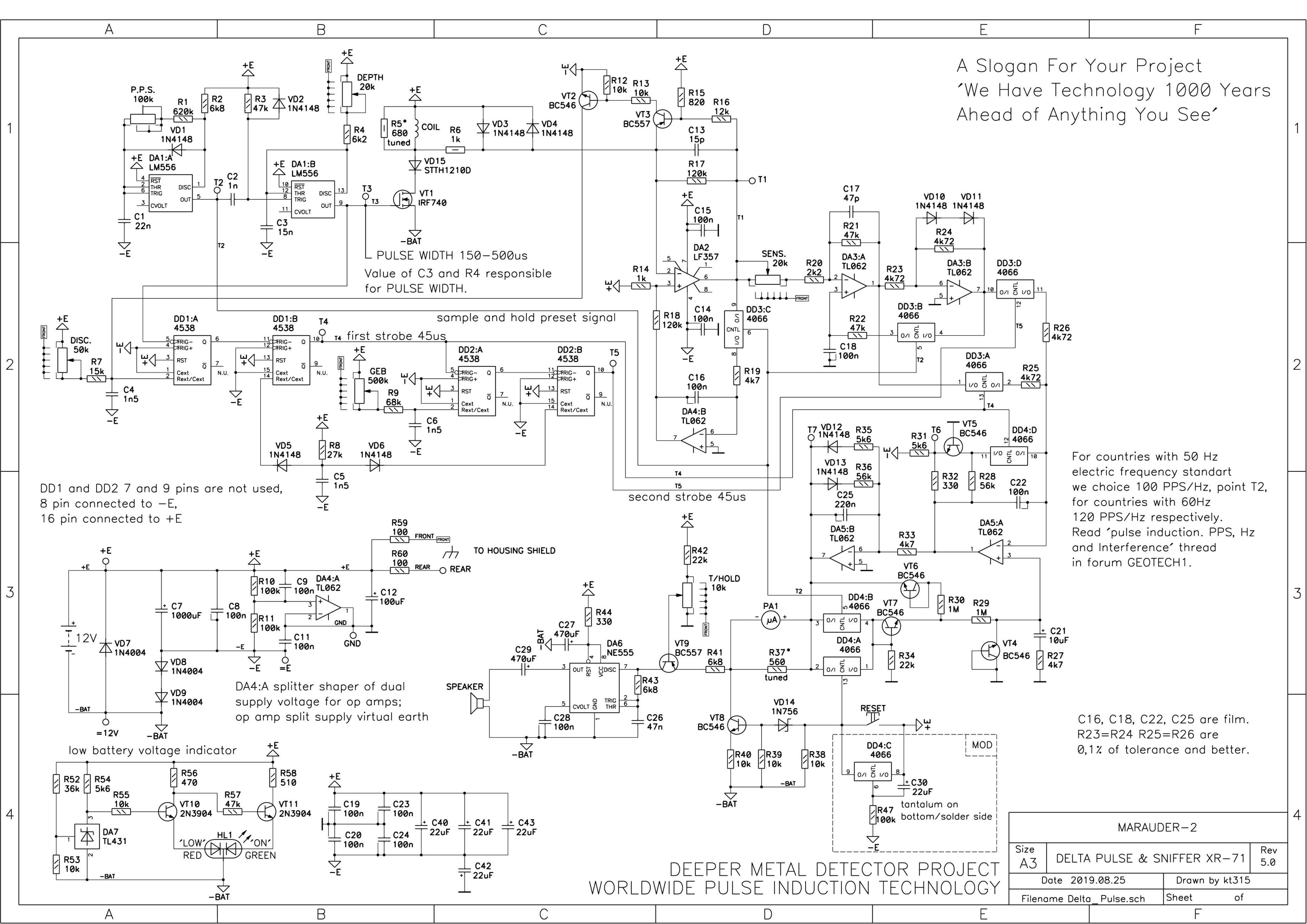

    i can send file to file, if you so ask. i did that billion times in the forum. a schematic.VERY PLEASE do not ask me frequency's choice be cause it is at the sch WRITTEN-NOTED. Click image for larger version Name:	dp_sch5.jpg Views:	0 Size:	826.8 KB ID:	439658

                      What are you looking for for the Deltapulse project? Everything you need to assemble and complete the Deltapulse project can be found here. Have you seen my post #216? It basically contains everything you need for the project. When I built the Deltapulse over 20 years ago, I only had the deltapulse schematic and nothing else, and was able to build a working detector from scratch since no circuit board was available back then. The schematic posted by KT315 is even better and more detailed than the old schematic I had when I created the project.​

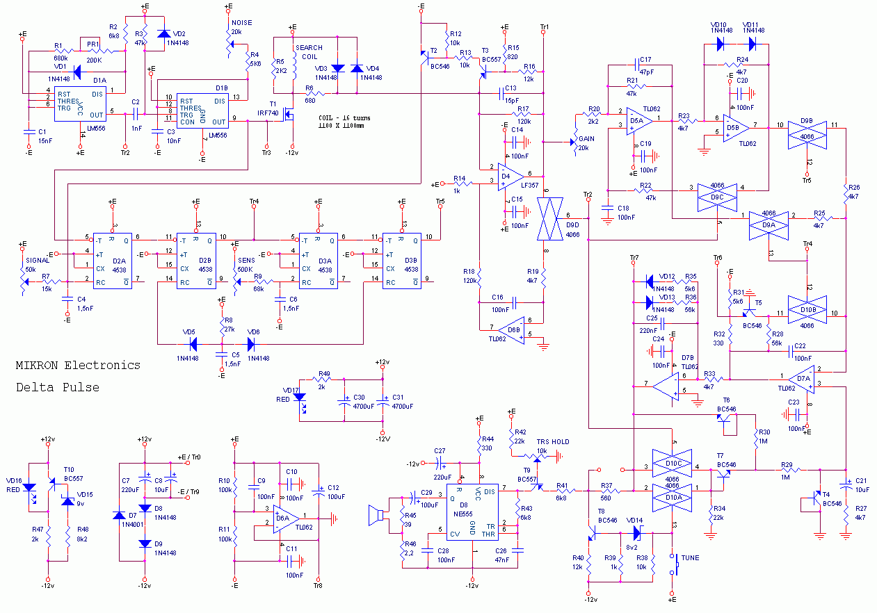

                      This is the circuit diagram I had when I assembled the Deltapulse.

                      • I managed to download KT315's huge archive of 6.4GB in about 8 minutes.
                        Only one folder in the RAR file applies to Deltapulse. If it's a Build Document that you're looking for (similar to MiniPulse), then there isn't one.

                              Thanks for the folder. Connection poor probably. On the multiple choice for parts any suggestions as to one be better than another? Any suggestions on those resistors with 1% or better tolerances? You know I'm probably going to ask you what has been asked many times before, maybe that is the purpose of no build document?
                              • first of all you have to sold sound part (on NE555) and check it. 99% of all problems is this part.
