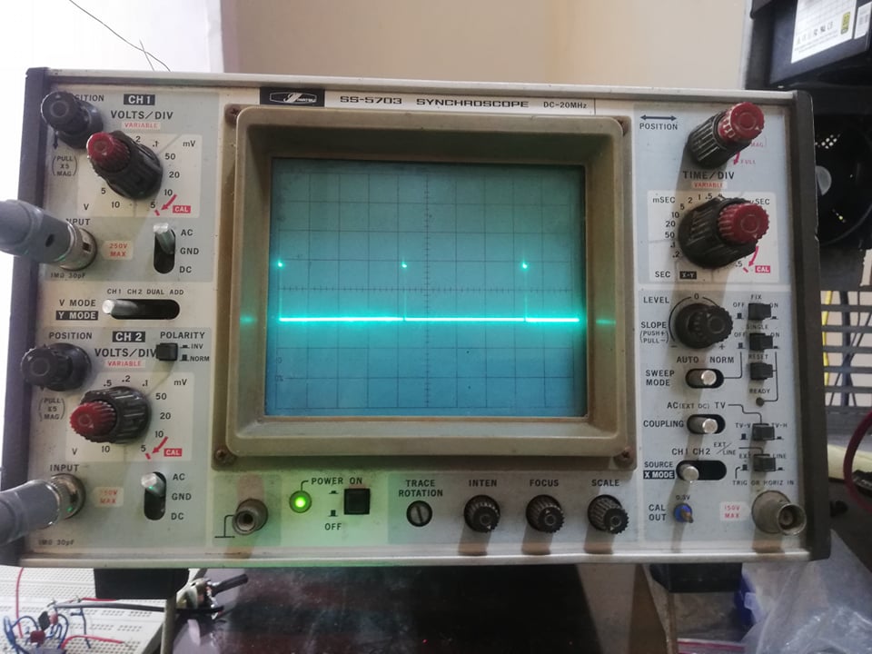

              For Surfdetector, here is the screenshot.Click image for larger version
Name:	DP T1 Scope Signal.jpg
              • #82
                Originally posted by Sally View Post
                For Surfdetector, here is the screenshot.[ATTACH]57152[/ATTACH]
                This is the output of the preamp? It does not look correct.
                • #83
                  Yes, output of LF357. No search coil connected.

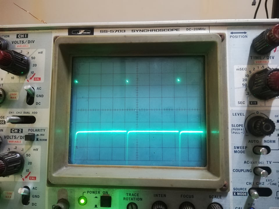

                    screen shot of DP T1 with search head connected. Click image for larger version
Name:	DP T1 Scope Signal.1.jpg
                          220v AC, 60hz frequency.
                          thx. looking as 'american standart' (postwar help of Big Brother). set sure 120Hz in point
                          T2 or T3.
                          • #88
                            screen shot of DP T1 with search head connected. [ATTACH]57153[/ATTACH]
                            I cannot really see the wave form properly here. How did you choose the size of your damping resistor?
                            • #89
                              I used 680 ohms 1 watt resistor.
                              • #90
                                T2 or T3.
                                Yes I did adjusted 100k trimmer with T2. Time is 8.3 millisecond = 120hz.
