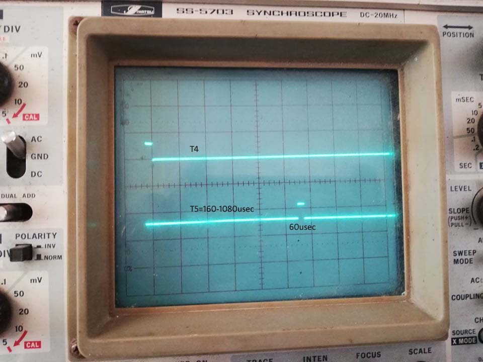

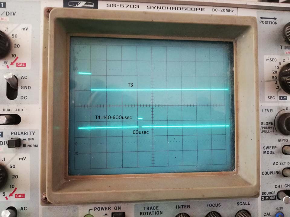

      • #93
        T4 and T5.... i had met a problem in board i got in repair... that was abnormal working 4538.
        let to see pics of T4 and T5 one-pulse-on-screen/one-period-on-o-scope.

          • #95
            I don't have enough time to fine tune time delay because we are on Holy week and it is holiday today and tomorrow in my country.
            This is actual time delay on DP board. Click image for larger version
Name:	DP T4 Scope Signal.jpg
ID:	362822 , Click image for larger version
Name:	DP T5 Scope Signal.jpg

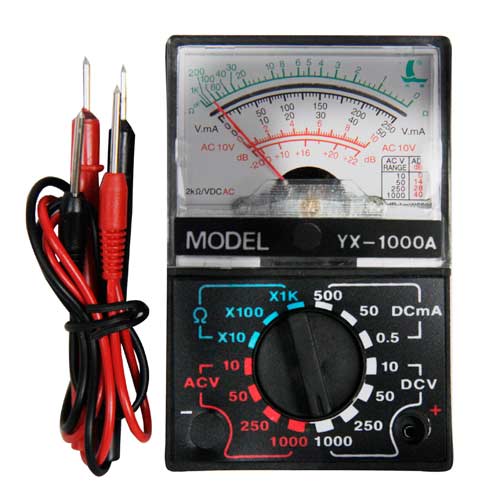

              • #97
                for a member.
                take analog arrow chinese tester ('simplest'). it has 0.5mA scale. yes, that is DC but you measure DC =)
                ie 0.1 division of it is 100uA. connect to R37 and write what you see.
                https://www.aliexpress.com/af/Electr...20220527233356
