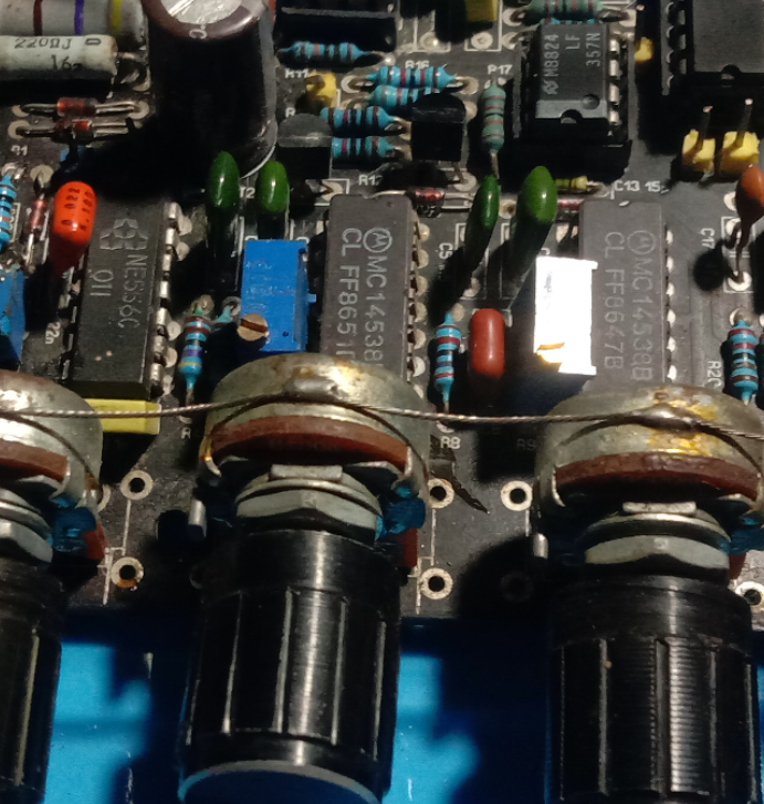

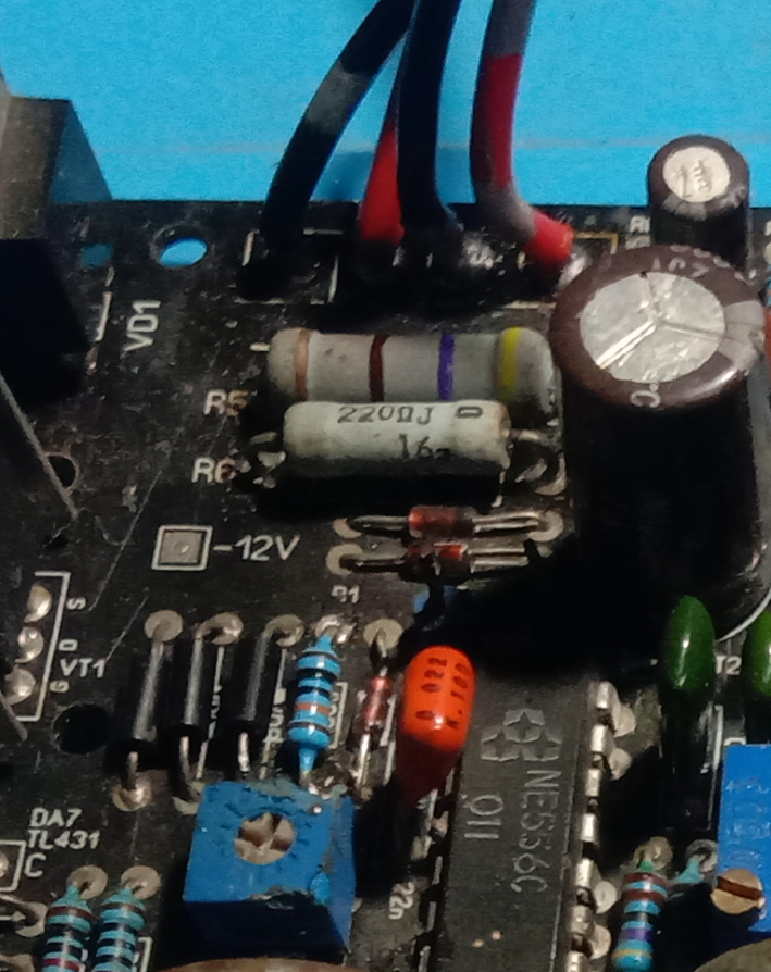

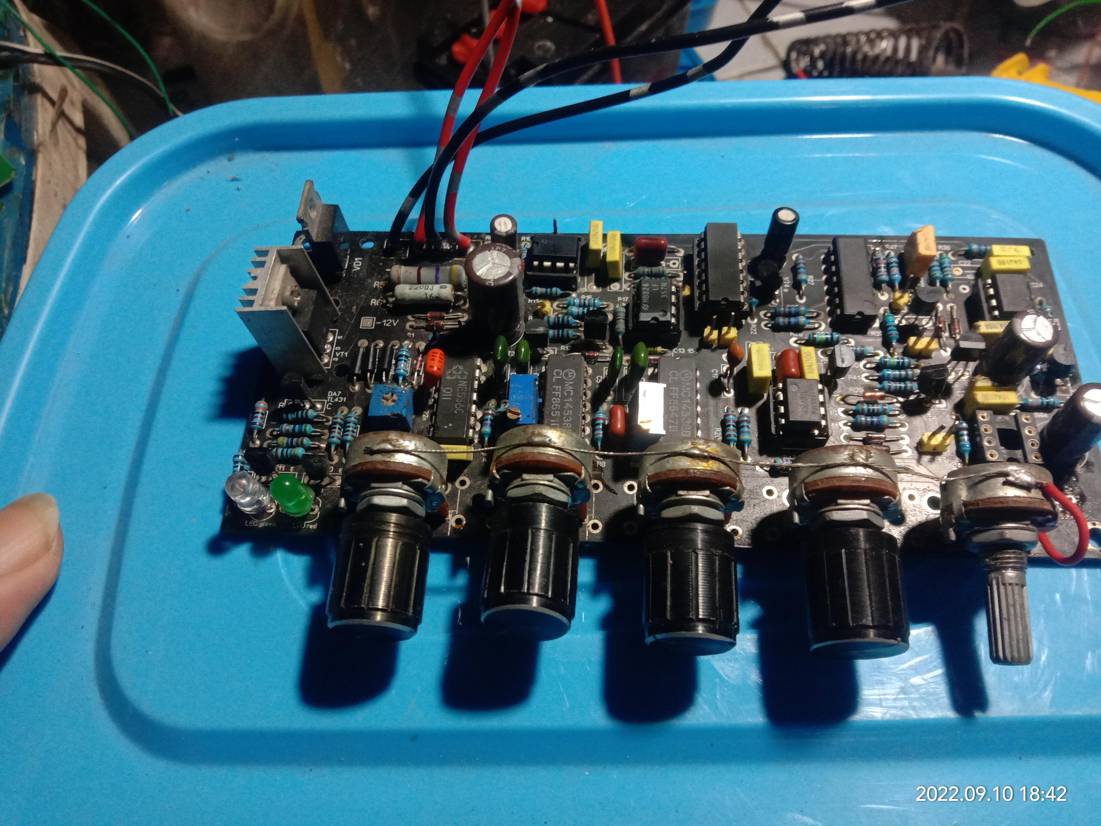

    • hello all, these few days I tried to experiment with DP like the following photo,
      I changed my R5 to 470r
      I changed my R6 220r
      frequency 300hz
      induction coil 300-320 uH
      then I changed the resistor near 14538 as in the photo * with a 503 trimpot to adjust the timing on T4 and T5
      T4 which on the 40us scheme I changed to 22us
      T5 100us,
      good detection results with plato pliers which was 40cm points, now 50cm points.
      the gold ring that used to have to be attached to the coil, now can be 18cm points,
      that's my experience with DPClick image for larger version
