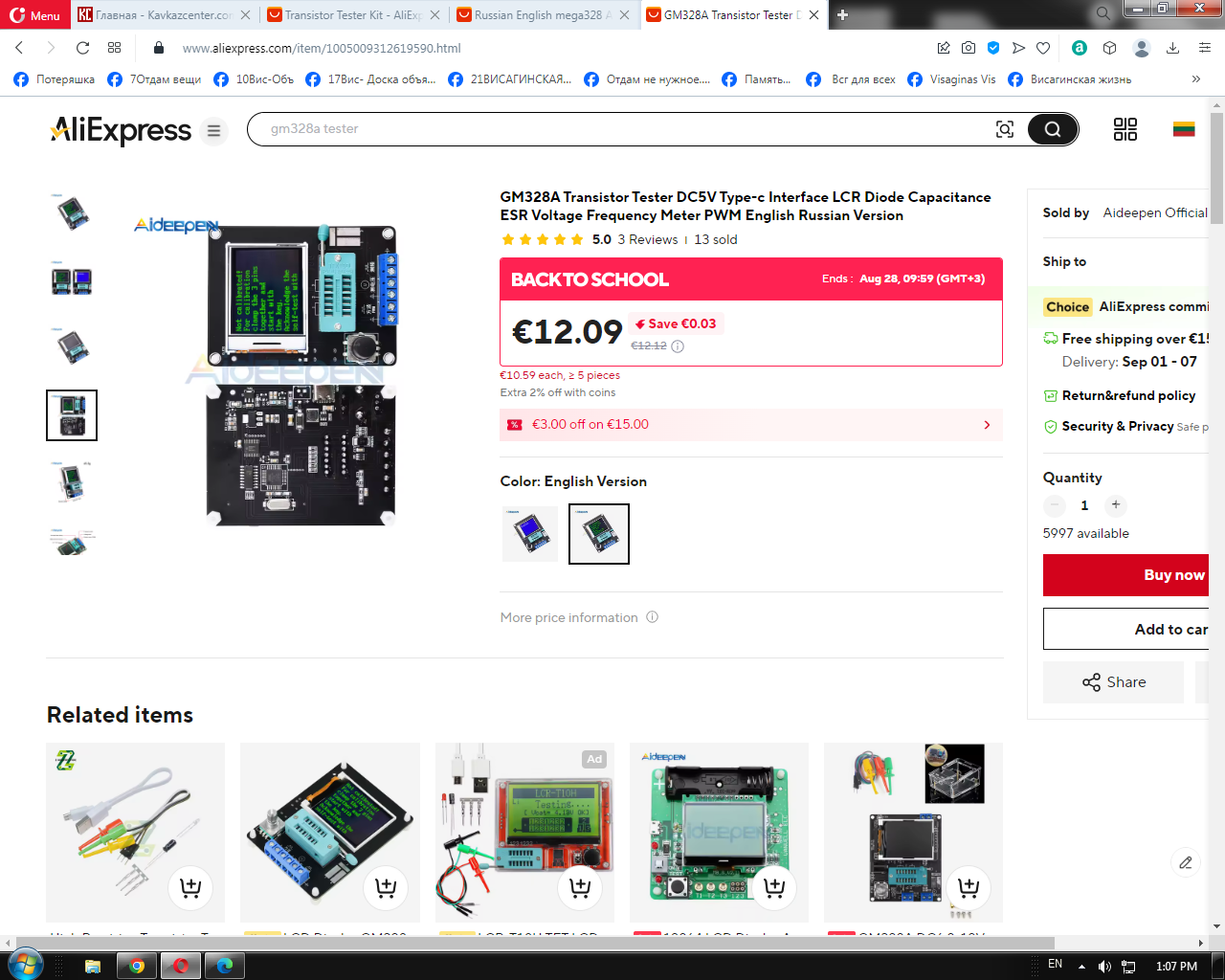

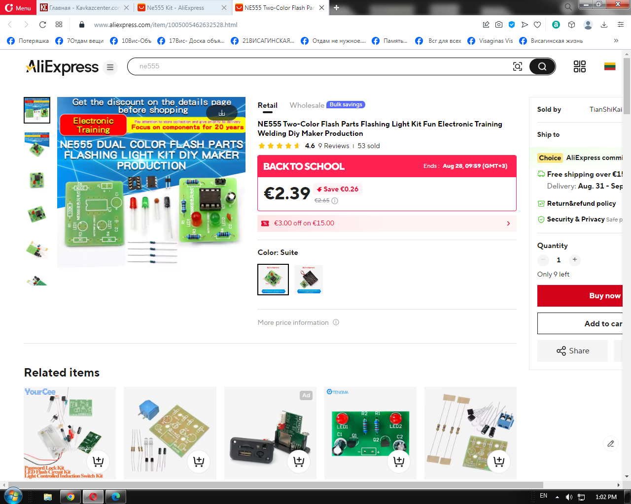

        how to check NE555 out of board... i recommended to buy simplest kit from ali, they are much there.
        also, i did open big thread for all chinese kits, in the forum. transistor tester will later. you can check IRF740, diodes, electrolitics ESR etc.
