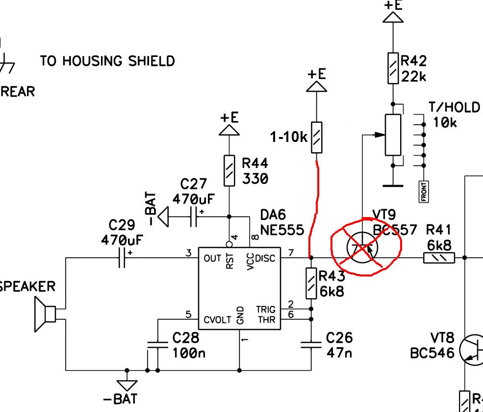

          • Instructions How To Make Delta Pulse Working. Following Steps.
            PleaseleavedrinkingoffintimeyoumakeDP.
            Pleasedo not use resistors of 0.5Watt of power. Theboardisfittingonly0.125or0.25Wattresistors. You can use 0.075 Watt resistors too.
            R5andR6take 0.5,1.0or2.0Wattresistors.
            Pleasecheckallresistorsbymeasuring,beforeyousolder . Another way you get big trouble.
            Checkalsoall diodesbyatester,beforeyousolder.
            CheckallelectrolyticcapacitorsbyESRorLRCtester, beforeyou solder.
            SolderallIC’sandcomponents,besideIRF740.Solderapin intest point –E (marked at PCB like =E).
            Cleantheboardbyalcohol.
            Setpotsinpre-setposition:
            DEPTH-min,atleftside,counter-clockwise
            DISC-min,atleft,counter-clockwise
            GEB-middle
            SENS-middle
            T/HOLD-middle
            Turntheboardto+12Vpowersupply.

              Delta Pulse PI metal detector. 1 stage. Sound checking. Проверка звука.

                you may test the sound with all components in board and without all with just sound NE555. you have to sure present as NE555 works in standart connection.
                if not...

                      I had got billion of complains 'no sound'. and yes I do not know why the people have this problem. so I did two videos to SHOW VISUALLY in youtube how to test the sound because simplest text is not understandable for the people. the roof is sure first.
