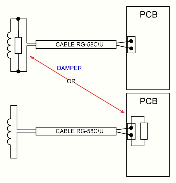

                  • Hello! Sorry for the stupid question (I haven't made PI for a long time). Where is the correct place for the damping resistor? DELTA PULSE device. Thank you!
                    • better inside a coil. but for tuning you can not open clued coil. in DP the damping resistor sets on the PCB. also, you do not need to tune the resistor as DP is working
                      with 40us FIRST DELAY.
                      • Thank you, KT315! I'll put it on the coil connector.
