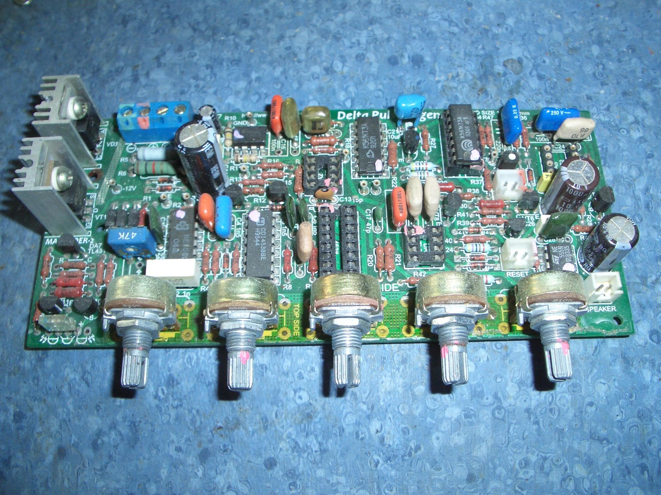

            • Hello
              I've completed the Delta Plus 2 project, but when measuring the frequency between the coil terminals, I get a range of 108 to 139 Hz.
              I've seen some posts here talking about 300 Hz.
              Another problem: The device is stable on small coils and detects a coin at a distance of 30 cm, with 40cm coil but the large coil is unstable.​
              • Hi Anas,ru
                probably you need to adjust the damping resistor and match it with your bigger coils.
                • Large coils act as antennas, make sure you are far enough away from the power line to do this test. And as suggested by GEOMAX, check the coil's damping resistor.

                      Hi Anas,ru
                      Hi GeoMax
                      I use the same components as in the schematic R5=2.2k / 1W.
                      40cm coil =2.7ohm------ 1.2m coil = 1.9ohm

                        • Originally posted by Emersonpaz View Post
                          Hi Emersonpaz
                          I had the same problem with Felezjoo Pi..... so I made Delta Pulse2 and I got the same problem.
                          • What do your oscilloscope images look like at the output op-amp for each connected coil?
                              Unfortunately, I don't have an oscilloscope.
                              I'll try to work on software that uses the computer's microphone input.
