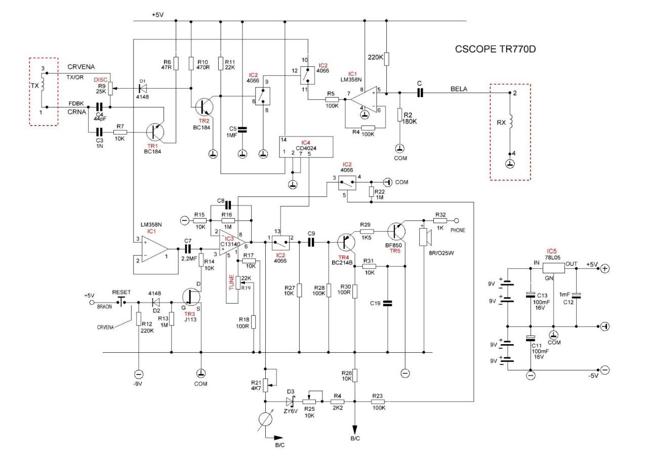

    There is a problem with the circuit... the oscillator is not working.
    Do you guys have the correct schematic?​
      https://www.geotech1.com/forums/foru...-660-schematic
      look here , it is the same. maybe the problem is in your coil.

          Hello
          I only had the schematic.

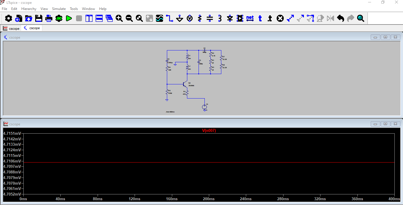

          The oscillator part was interesting to me so I ran it in the simulator but it didn't work.
          Now I'm looking for the correct schematic so I can test it in the simulator software first.
          Unfortunately, I don't have the device or the PCB design.​

            That circuit didn't work in the simulator either!!!
