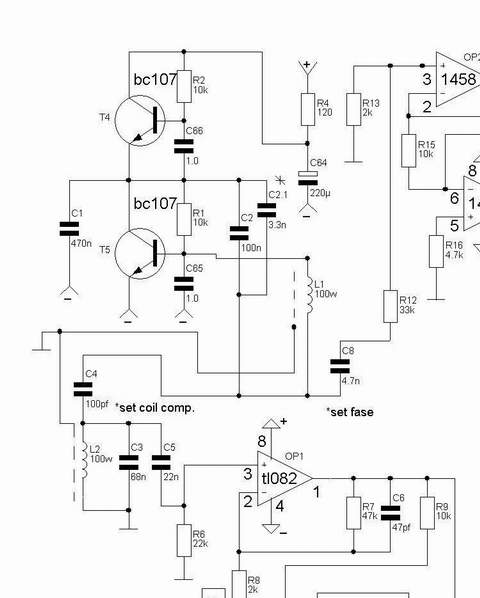

      All Sasho's schematics are interesting. So i decided to draw pcb for this one. And i was just about to start when i saw this:
        I think this TX will never work, wired as on schematic. Sasho must made mistake in a hurry?
        Sasho can you comment this?
        Thanks in advance!

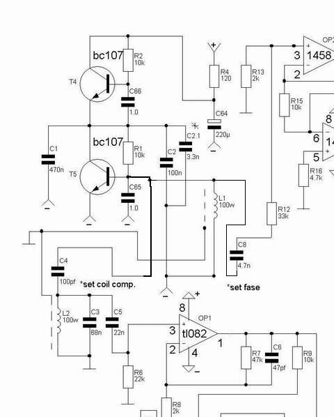

          I think this should be proper wirement, agree?
            In this way isn`t base of tranzistor shorted to "-" ? Is this correct? Both base and emiter goes to minus . Base via L1 .

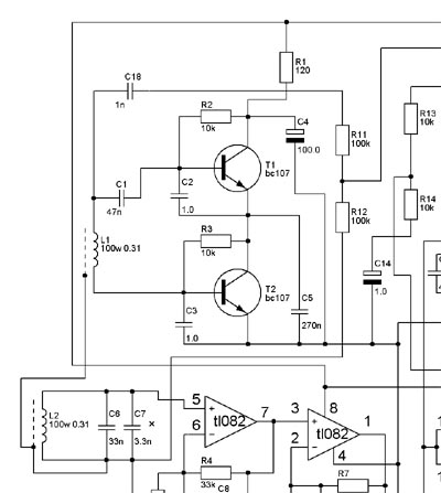

              A similar oscillator:

                Yes i see. Maybe i am wrong, but i also can not figure out the first case?
                Would be best to hear from Sasho.
                Ahhh it is that awkward way to draw schematics..!
                  You can make only Tx generator and L1 and see if it work.
                    I agree. Best way to figure it out!

                      Where did that schematic come from?
                      Ivconic: 100 pF is nothing, and not meant to send signal anywhere, but rather to cancel stray capacitance from sloppy wound coil imo. It seems that Sasho has not been around for a while. You could make circuit board to go both ways to see which one works best. I think Sasho's design has been tried and works.

                        Simulated this oscillator with proteus software . worked correct.
                        • #42
                          Hi ivconic
                          I built this oscillator , working correct without problems .also has very good
                          Stability .
                          • #43
                            ivconic ,if I remember correct, also one of the fisher detectors used similar
                            Oscillator
                            • #44
                              I'm not sure, some Russian detector.
                              • #45
                                Oscillator
                                aft_72005 now i am confused? Part of schematic you are posting now is not what i am confused about!
                                That oscillator is clear to me.
                                The other one part of schematic i posted twice (first Sascho's and second with my wrong corrections) is what i wanted to clear up.
                                Regards!
