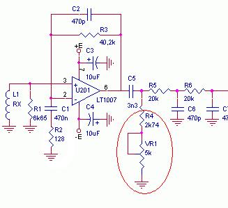

      Hi Geo
      Here are two ideas for a solution that you can try:

        Thanks Magma.
        Do you know if the waveforms are ok or not??
        Also first 2 days the disk worked ok (no perfect but good).
        Today i will replace the capacitors for phase shift.
          Thanks Magma.

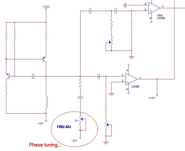

                  • Hi Pompey.
                    I found the first problem with sound, it was a fault 100n capacitor. But now the problem is the coils. As i see at Bluemax the Rx signal is about 35degrees rear of the Tx signal. So i must make it to be in phase with tx signal. I will try to late the Rx signal other 330 degrees so to be in phase with the Tx or other 150 degrees and to reverse the winding. But it is not so easy to make it. With the disk potentiometer closed and when i have signal only on the one channel (ferrous), it detect a 30mm coin at 50+cm with the coil no good tuned. This is the reason that i try to make it to work right.

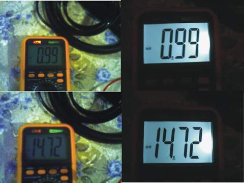

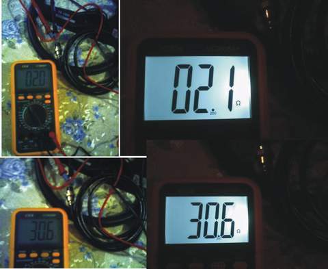

                          • Hi,
                            Ivconic.
                            Can you measure what are resistances of this TS100 coil.
                            I just measure those on RH coil and they are 3,9ohms/40,6ohms.
                            Waiting to see this video when you are ready.
                            • Resistances....
                              • Inductances....
