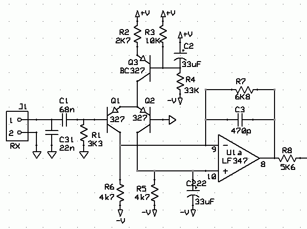

  • What about this kind of front end modification ...
    I did not try this particular solution in Spice, let alone in practice, but It seem promising. I think Q3 can also be substituted with a simple resistor because the CMMR will take care of noise. I already played with this solution in a full differential input configuration, but it must work fine in single ended configuration as well, even with less noise. With 327's I'd expect ~1nV/sqrt(Hz)
    • It is 2K7, sorry for the mistake!
      Possibly yes. It is also good solution.
      You can change R37 value or put trimmer instead to see the difference.
      Also i think that 555 stage can be improved further.
