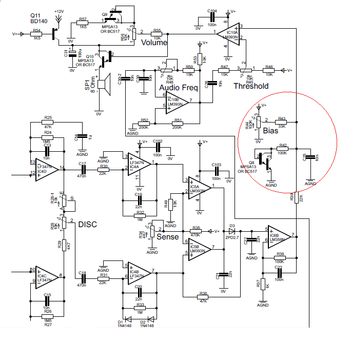

Hi everyone,
I noticed, that in the latest versions (ver. 2.0 and 3.0) of the scheme are added some components, missing in the initial versions:
Q8, R42, R43, R44, C25
What is the purpose of these elements - to maintain the threshold to be calm or...?
Since do not have the opportunity at the moment to experiment this circuit topology of this type of schemes but I am curious about this and I'd like to comment on it... What are your opinions?

and bias. The oscillator provides triangular wave, so the comparator ON periods are affected with signal voltage, as dictated by bias and threshold controls.
