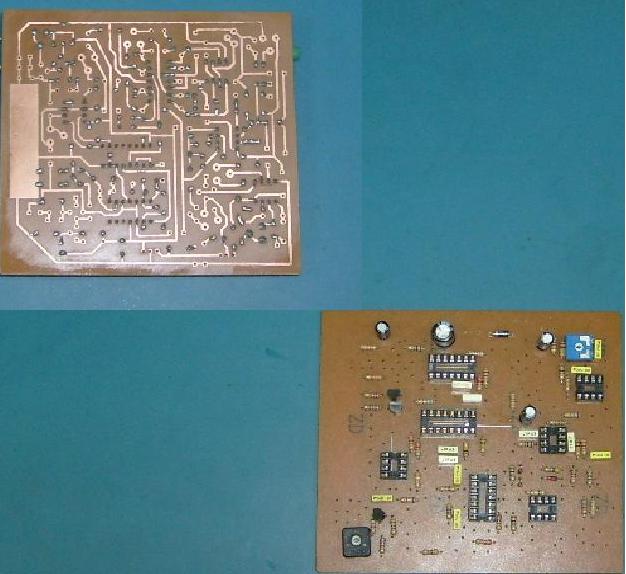

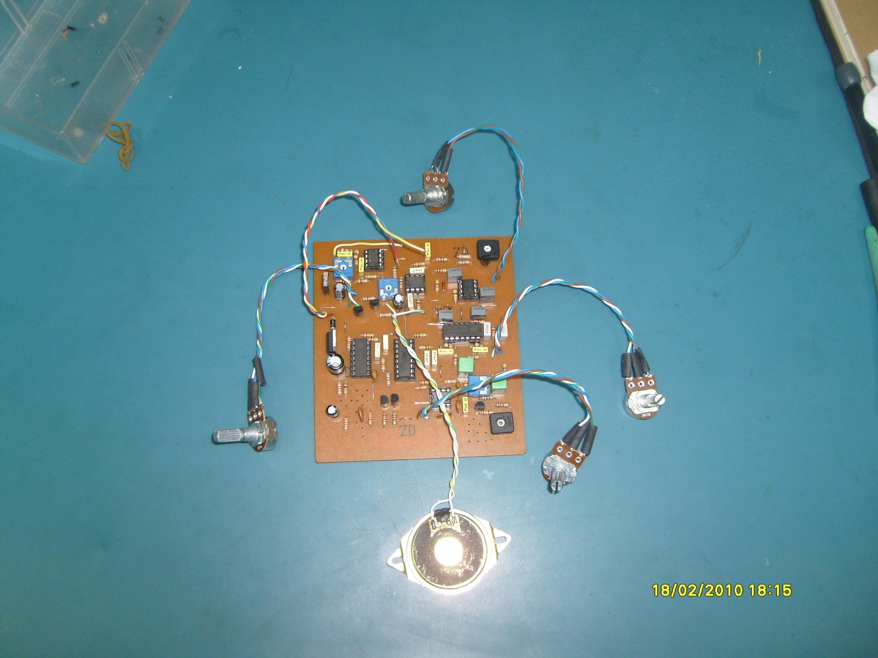

    Air tests with 555 SMW version with 27DD:
    24mm coin - 45sm
    34mm coin -55sm
    diskr -rejects all iron
    no reaction to ferrite
    very small sound cracks coused by interference
    GEB must be adjusted very fine to get best sensitivity and stability.Also coil nulled perfect.

    • Super it is, but the test in air and test in the country who are heaven and earth.
        Sorry I didn't get you Orbit. Do you mean it doesn't work as well in real conditions as in air?
        • Originally posted by mindfree View Post
          Of course NOT. At ground every VLF lose 30... 50% of the depth.
            I'm aware there is some loss in depth but Orbit's comparing the difference to 'heaven and earth' which would mean very large differences.

              Hi.
              Make the version with the 555 at the audio. It is better and realy if you will make a good coil then you will have a very good detector.
              ohhh.... thanks for your good words about my lab
