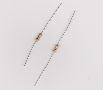

I guess it is 1M3 made from 2 other resistors..
Serbian "Most Wanted"
Hello Friends,
No…no…. not a secret modification, only lazy me…
I made a error in the colors from the 4k7 resistor. The one on the pcb is 47k !! look at the colors. Have not removed the wrong 47k but fixt a 1k on top of it. The near 22N cap is also wrong must be 10N (thanks Nakky).
Best regards.
Ap
one resistor 4k7 one resistor 47k look close......

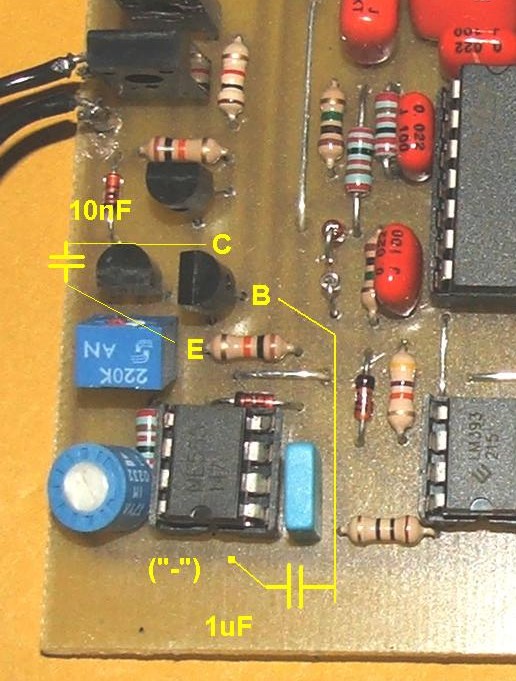

ApBerg add those 2 caps to hear the differences in audio!
10nf beetwen C and E. 1uF beetwen B and "-".
You will be amazed! Simillar to "bell" at Garrett GTI2500!

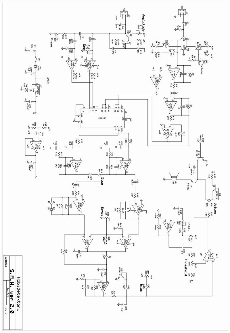

HELLO IVCONIC AND FREINDS
I built the circuit SMW but found some disagreement in the revised schematic and PCB
1. Resistance is 1K, but the PCB schematic with 4.7K specified. Which is it correct??
2.MAX in this circuit does it do?
3. If I can instead of 33 micro farad capacitor Tantalum electrolyte to use?
4. LM7805 specified in the schematic, but PCB 7809. Which is it correct? 7805 or 7809? ZENER 4.7V and not the PCB Why??
5. Resistance is specified in the schematic but 3.9K is PCB 1.8K.
6. BC327 transistor in the schematic, but is in the PCB BC547. Which is it correct? BC547 or C327????
7. Lord, I instead of the BD180 transistor transistor BD140 to use??
8. The schematic 2.7K specified value for this resistance is 27K but the PCB amount specified. Which is it correct?? 27K or 2.7K????
9. I can instead of the IC LF347 IC TL074 USE(REPLACE) ?????
