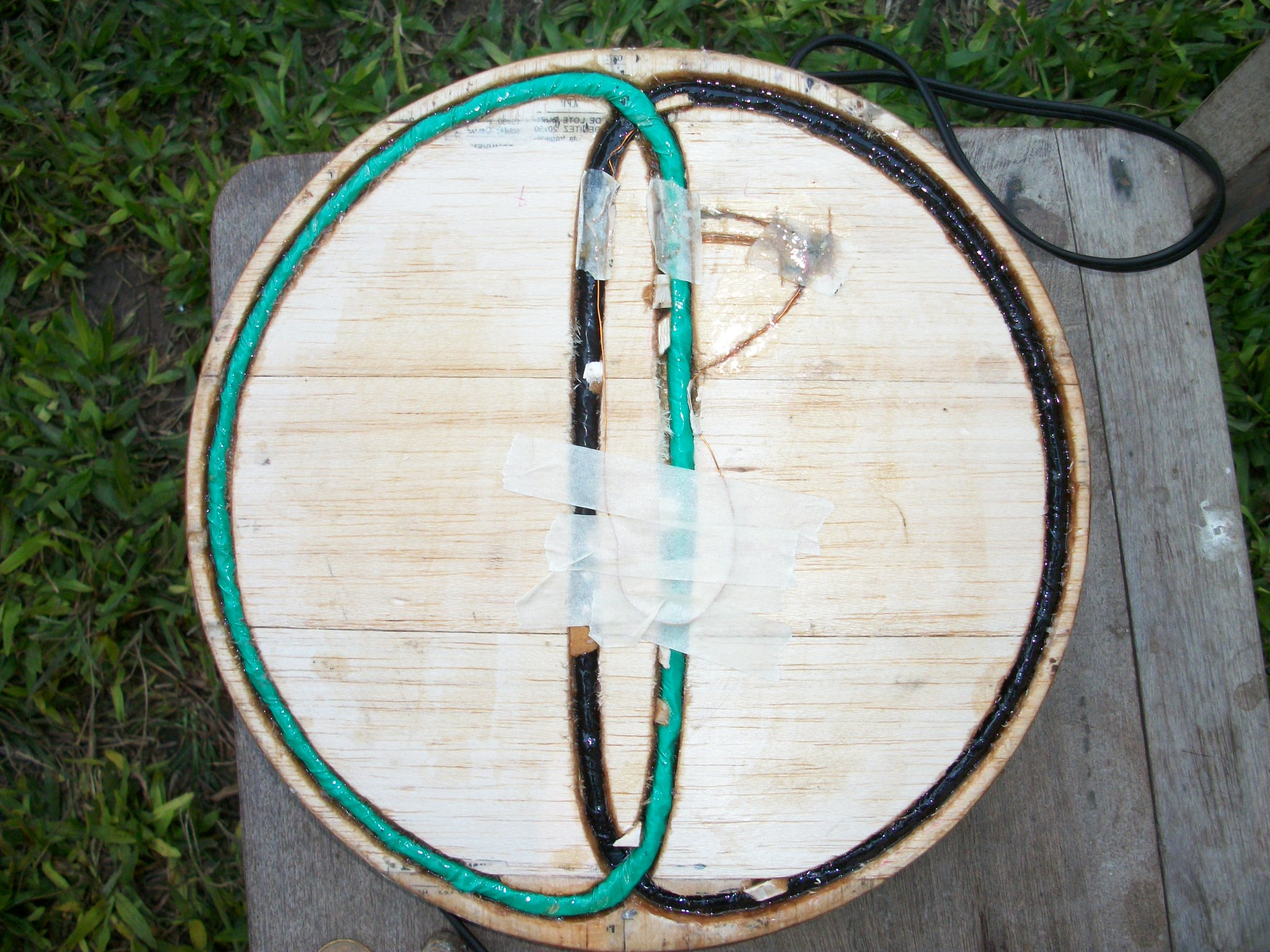

  • have not tested it with another coil and there had not had time to do another. I also work with the coil Minelab Musketeer, but you have to change the values ​​of the capacitors of TX-RX, 220nF and 68nF for, according to the scheme presented Ivconic.
    • I make this coil with balsa wood, with the data mentioned verotopasera for the SMW.
      Fine tuning is done with the loop seen in the photo.
      Data DD coils 27-28:
      TX - 75 coils, wire of 0.45 mm, 200 mm in diameter.
      RX - 160 coils, wire of 0.27 mm, 200 mm in diameter.
      Jose

                            • Hello everyone
                              I just finished this detector works from the last weld. I have a serious problem. I detect a € 2 coin to a maximum of 10 cm and a metallic plate of 10 x 10 to 20 cm and bigger problem, if I just touch the potentiometer R 16 or 3 thread of connection (GEB), I have a strong signal in the speaker as if an object is detected. Where is the problem?
                              Greetings
                              • Hi Freddy67
                                a percentage of a large mistake in the coil.
                                Coil is 28cm DD,
                                TX= 65-75 windings, 0.45mm wire,
                                RX= 160-175 windings, 0.22-0.27mm wire...
                                best time
                                j.
