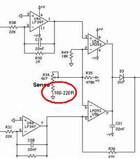

. I have another question. Potentiometer "Threshold" as a specifically threshold level, is or not dependent on potentiometer "Sense"?
BTW that treshold preset is most interesting feature to experiment with. Whole quality of final audio output directly depends on treshold adjustment (as i experienced).
That treshold feature is main reason why i replaced old audio stage with this one.
ivconic thank you againOriginally posted by ivconic View PostAs i noticed; not.

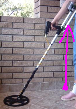

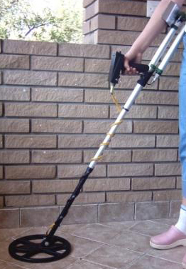

Interesting. It is difficult to see the detail from the photo, so I assumed it was being manufactured locally. Nice job!Originally posted by Magma View PostThe stem is made of aluminum handle for painting and arm rest of PVC pipe 110mm (or aluminum plate) , coil housings I was bought in Bulgaria.
I recommend this rezistor as protection against hypersensitivity.Attached Files
