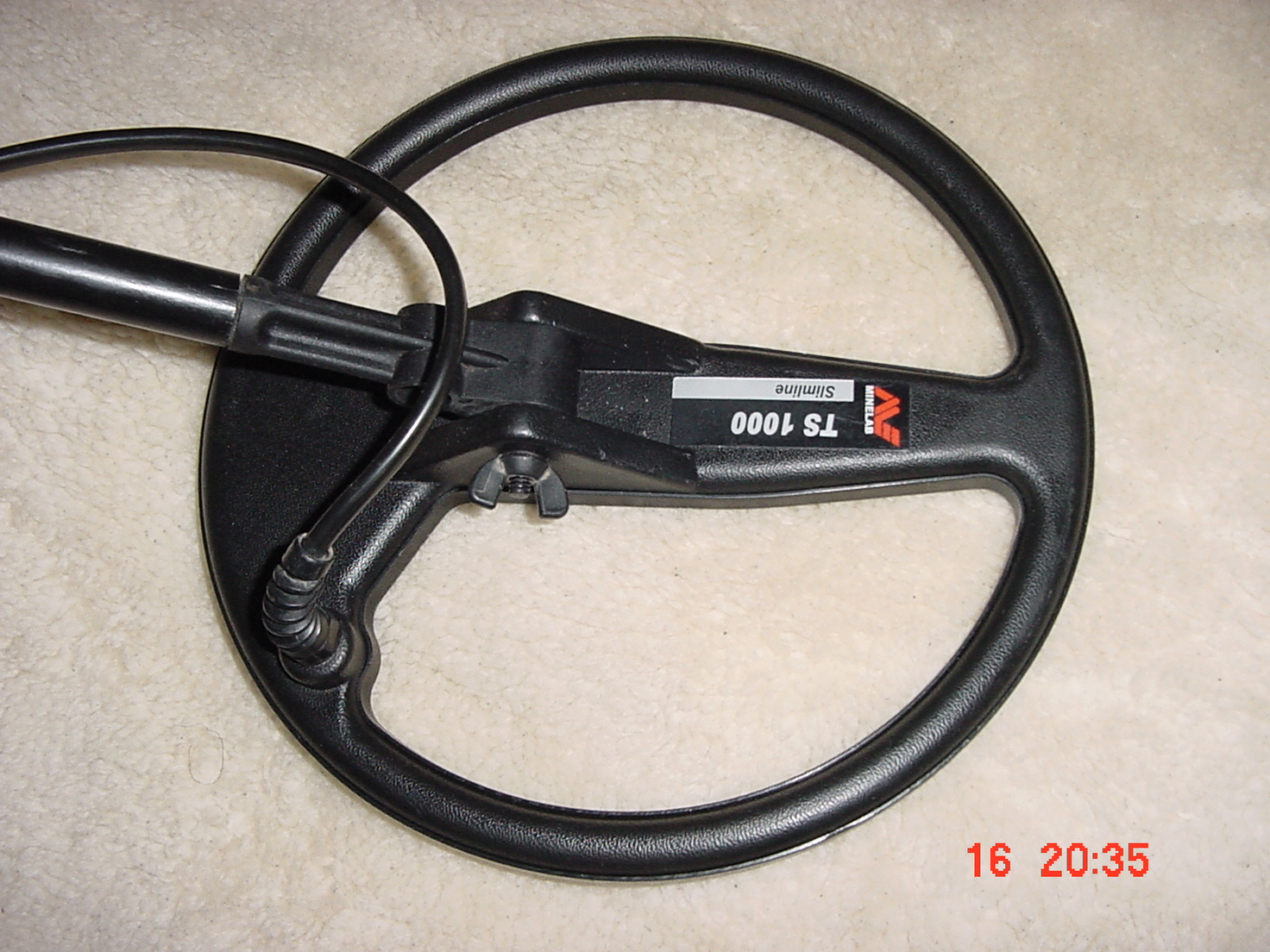

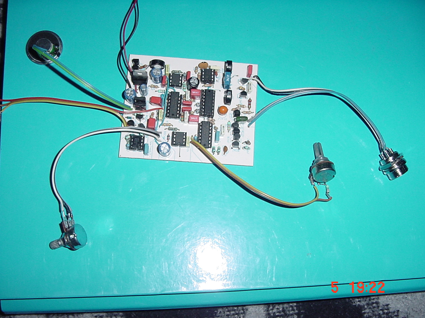

        I worked SMV 2.0 and I'm not satisfied with the depth.
        I tried with hand-held probes as well as with the original TS-1000, I changed the capacitors to the RX and TS and the best results I got 22nf RX and 470 TS 10cm peny.
        I worked on the Lay file.
        Do you have any suggestions or solutions?
        Thank you.

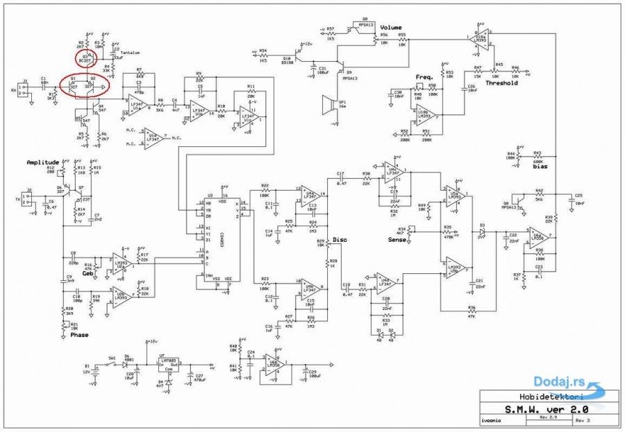

        • Menjaj tranzistore. Chenge tranzistor. bc327
          • Hvala zemljak.Мењао сам и њих,најбоље резултате сам добио са бц 327-40 појачањем 450 хфе
            I changed them, I got the best results with bc 327-40 amplification of 450 hfe
            • Zemljace probaj malosumne bc 558c (npn). Use lonose bc558c.
              Ne zaboravi da ih uparis jer imas posla sa diferencijalnim signalima.
              menjaj im radnu tacku s otpornikom od 10k. nadji optimalnu struju.menjaj samo na metu. rezistor test target.
              • Thank you.
                I'll try and just get more transistors.
                • zaboravih, mozda ti sonda nije dobro iznulovana na par mV. bad nul sonde ?
                  • Сонде имам 5-6 оригиналних Цезарове које феноменално раде на детекторима са ИЦ555.
                    Имам и ТС1000 оригиналну скоро нову сонду и нема битне разлике.
                    Menjao sam i kondenzatore čak sam i njih merio i upoređivao i isto.
                    Покушаћу још са транзисторима.
                    The probes I have 5-6 originals of the Caesar that are phenomenally working on the IC555 detectors.
                    I have the TS1000 original almost new probe and there is no significant difference.
                    I changed the capacitors even when I measured them and compared them.
                    I'll try more with transistors.

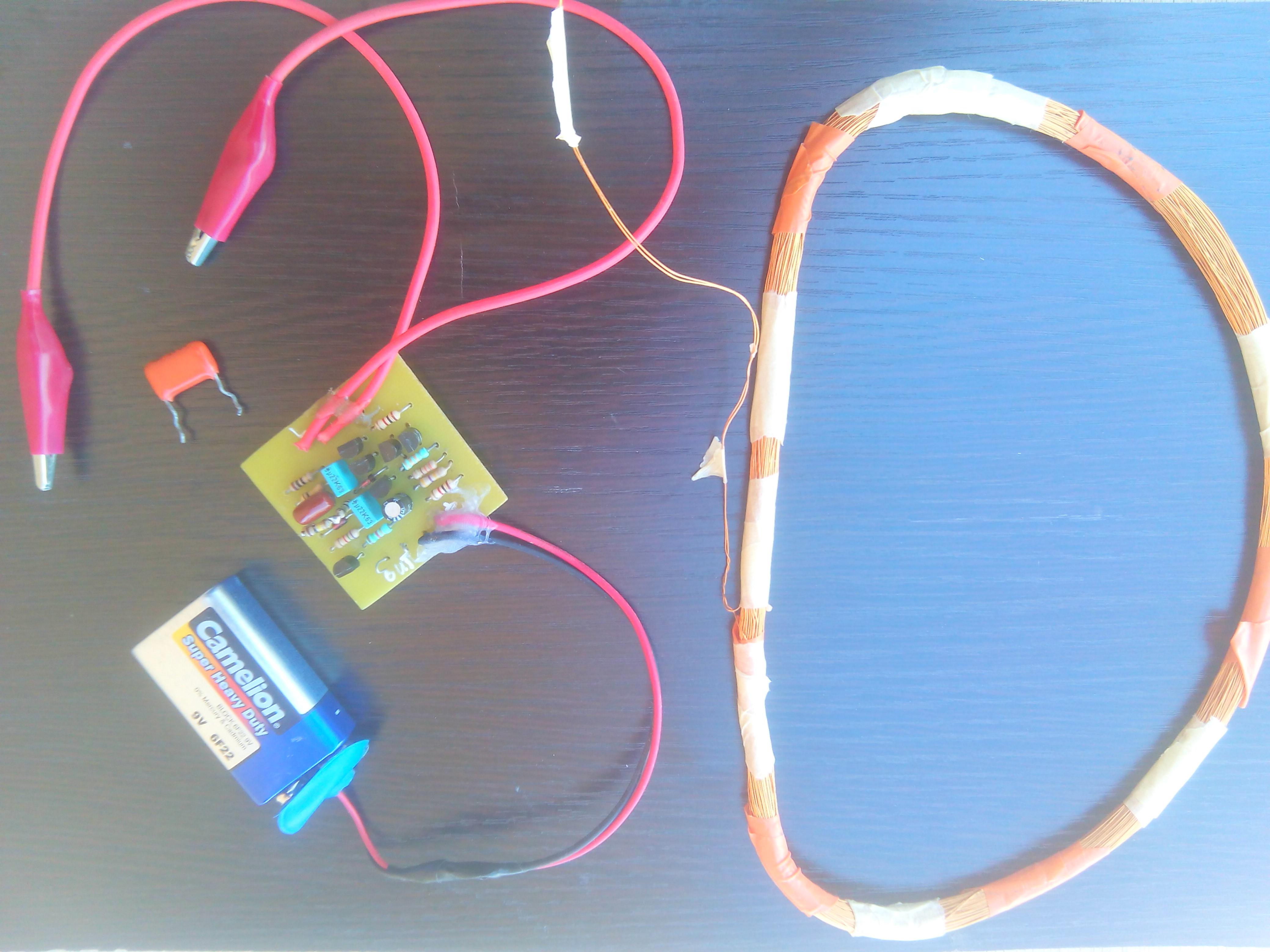

                          • hello all
                            I made this detector smw v2
                            When i measured the Frequency of tx signal I noticed that it is unstable, it is varied inversly to amplitude (when the ampl is 20v p - p fr= 6khz and when the ampl=14vp-p the fr=7khz).Is this a normal or there is somthing wrong?
                            In this case i can't estimate the inductance of my handmade TX coil with c=470n and variable fr.
                            because i don't have L meter for measering inductance .I made fr generator(in attashment) i found it in this forum. but i dont know what accuricy is it.
                            Also what is the porposes of c1 68n in rx side is it fixed value according to inductance 15mh or can i experiment with different value such 10n 22n?

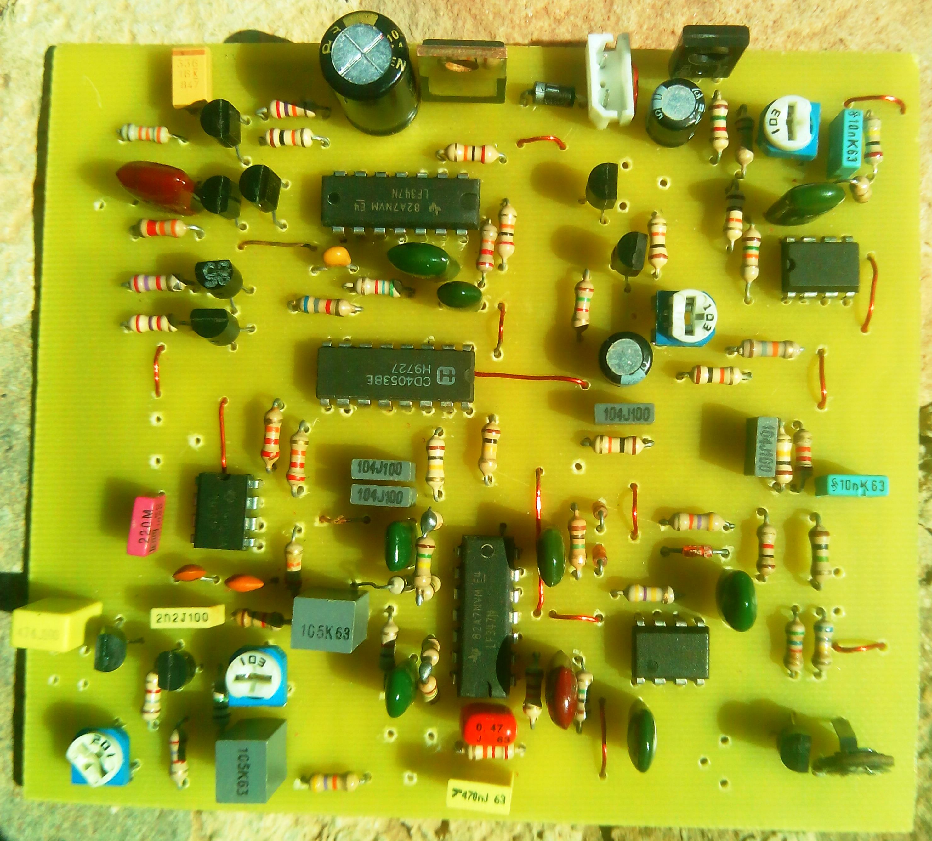

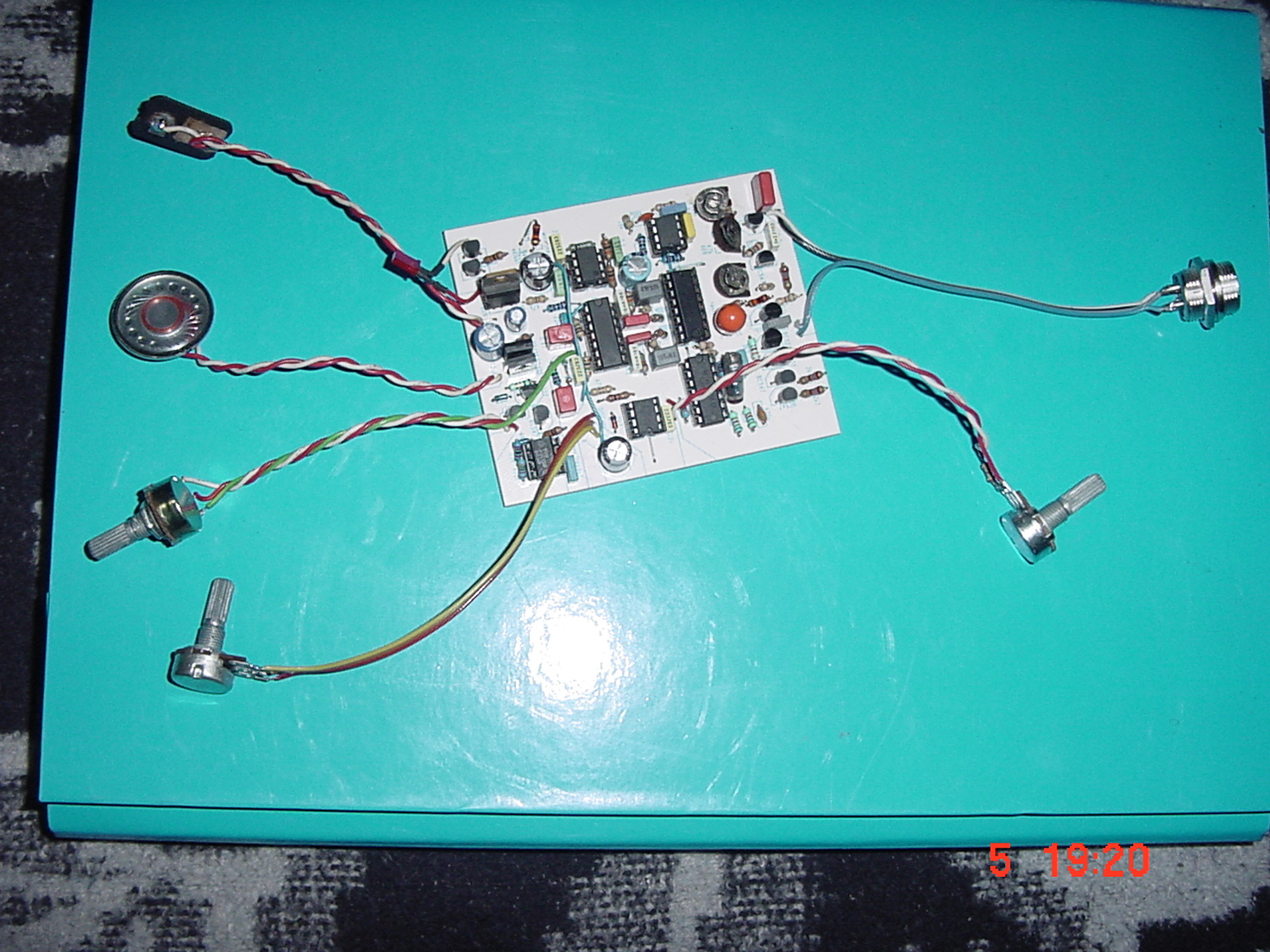

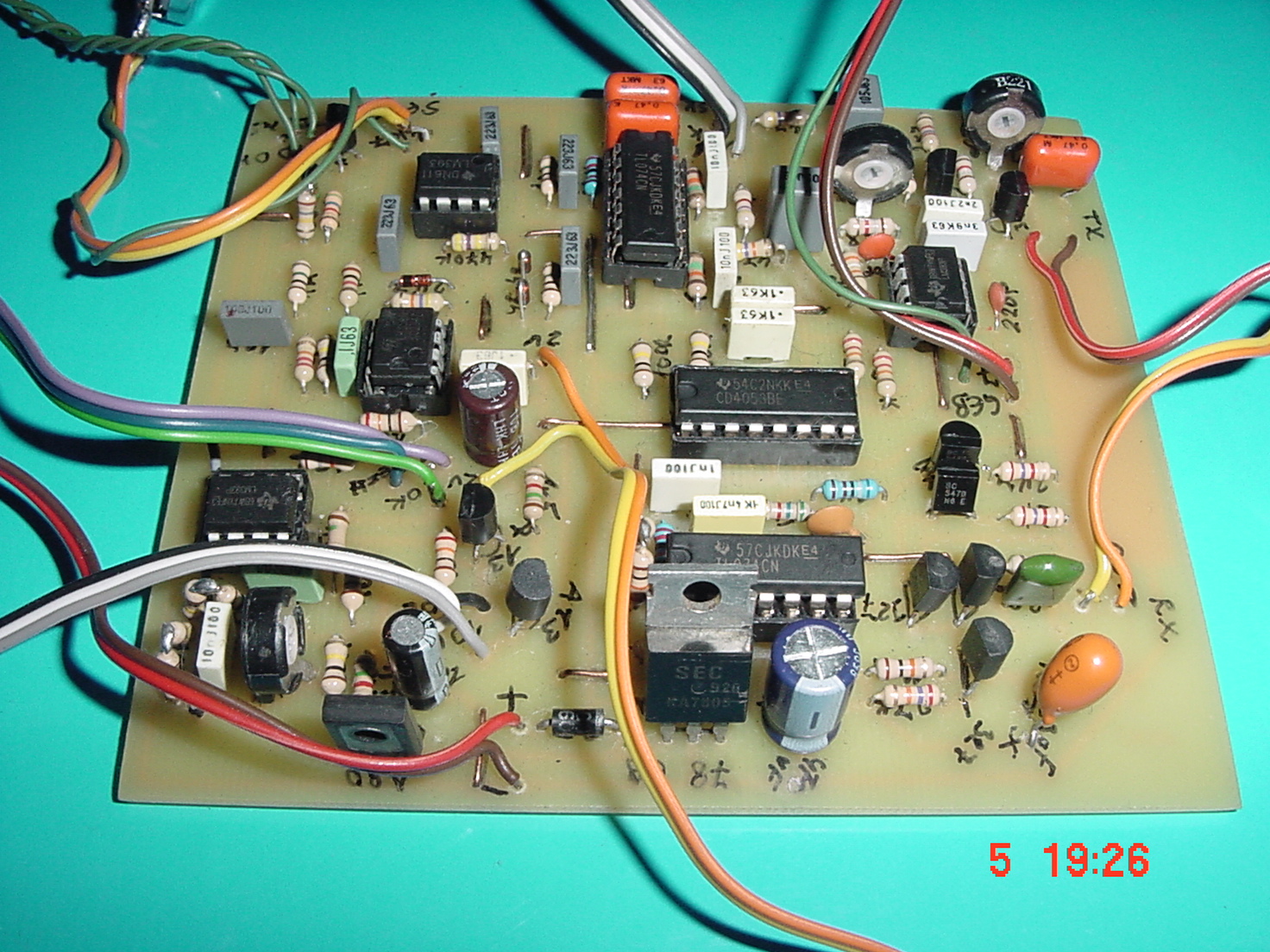

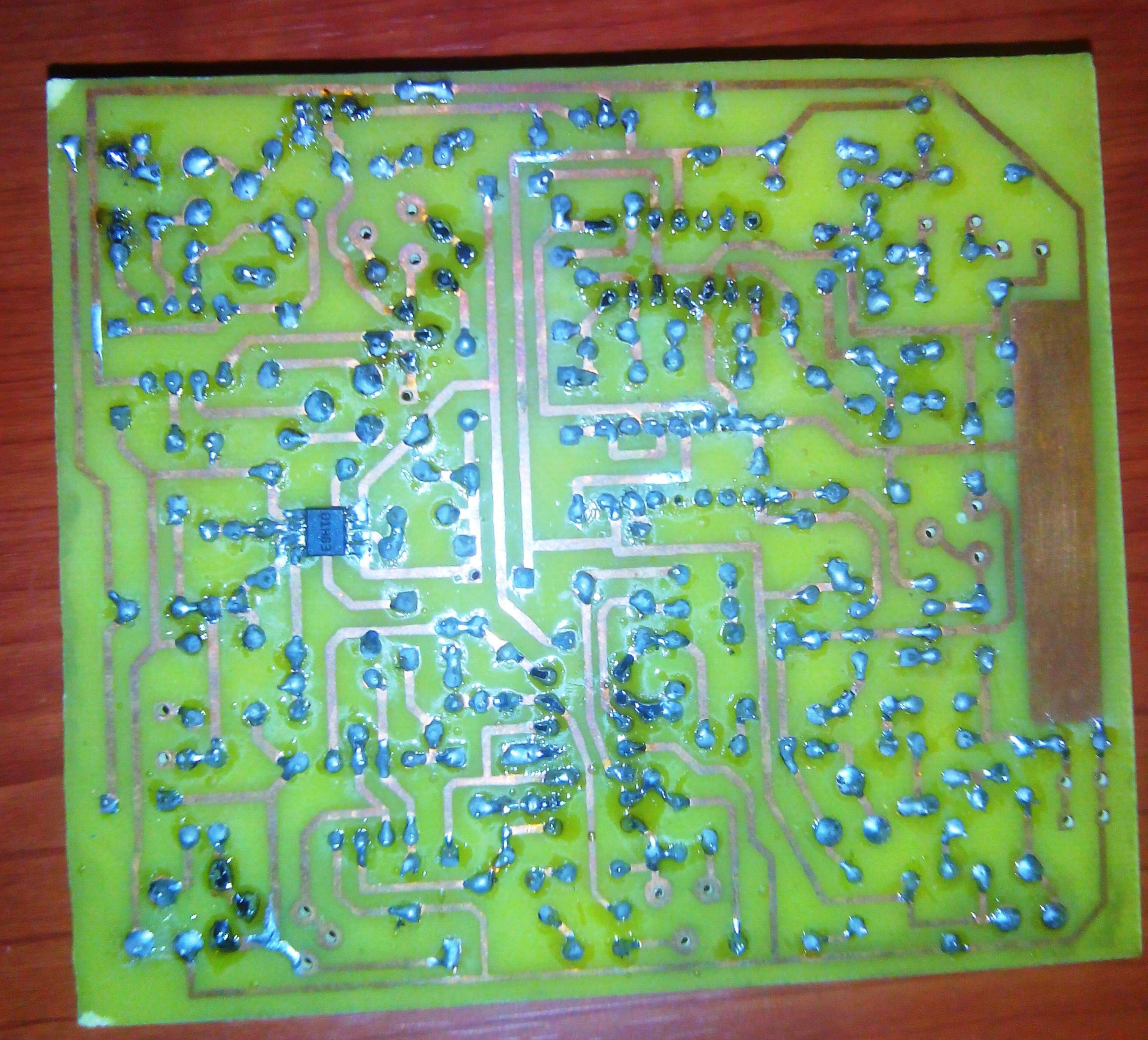

                            • My SMV 2.0 still has a low range of detection, discrimination is excellent.
ID:	352295Click image for larger version
                              And SMV V 1.0 depth and discrimination are excellent.
                              • Originally posted by crni1 View Post
                                [ATTACH]44312[/ATTACH][ATTACH]44311[/ATTACH]
                                [ATTACH]44313[/ATTACH]
                                Proveri Tx i Rx. Ako su ok menjaj integralce, mozda je neki falsh.
                                Pozz.
                                Chenge IC, Tx i Rx.
