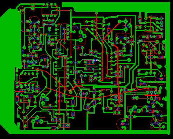

    Q1,Q2 and Q3 are BC327/40. Try to sellect those between dozen. hFe should be from 250-320 for really good performances. Try to match hFe on all 3 transistors. For Q6 find BC327 with hFe>300
    • #62
      C2 is not 0.1! It should be 33uF/16 tantalum, minus on Q3 base...!

                    What was that? That is one ugly pcb!
                    Also translator is making mistakes!

                        Please look at picture! Where it is tied - to ground?:
                        • #72
                          Yes, common ground.
