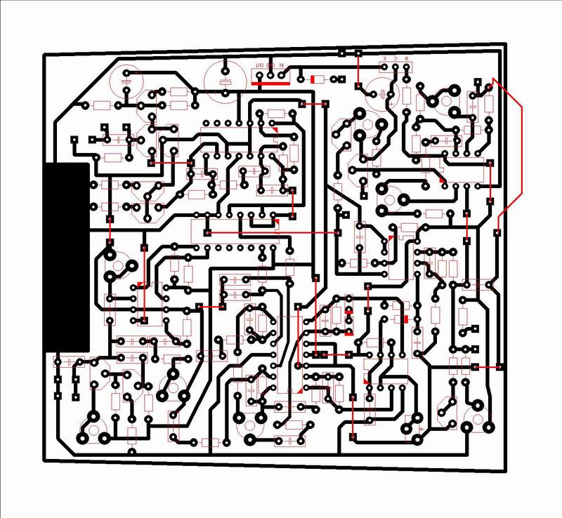

                pcb...
                • #83

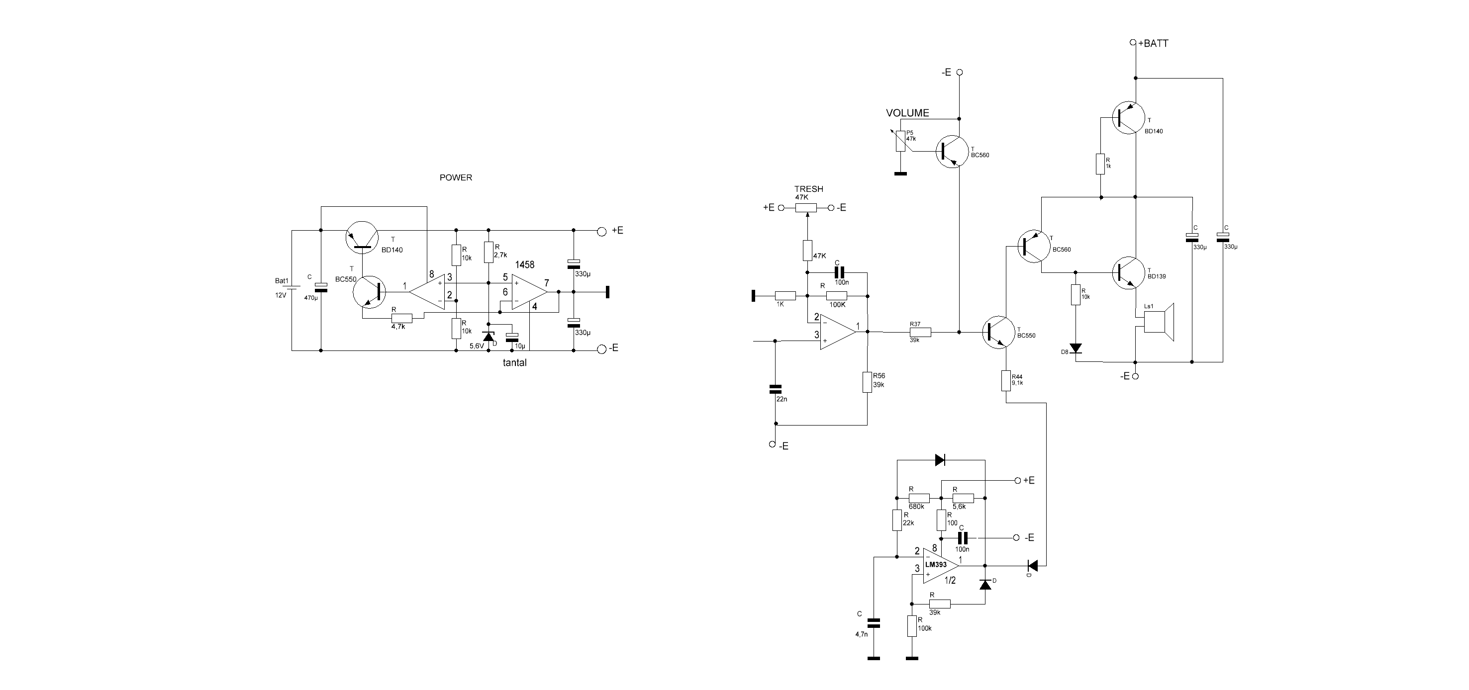

                  This is SMW v2 with audio taken from 1265/66. Much softer and better audio. Treshold & Freq. presets available.
                  Today finished, checked - working excellent..

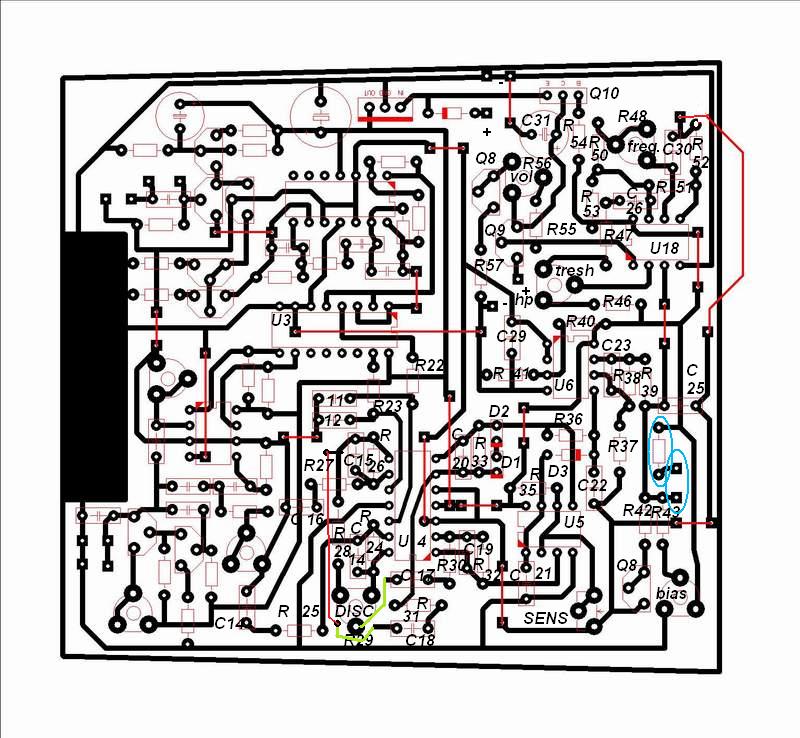

                        One major progress.
                        You have found supplier for those coils?What is the price?
                        Can you see the changes I made around disc. pot?Is this correct?Also what are those spots in blue for?Some switch?
                        I will try to find same coil on ebay.

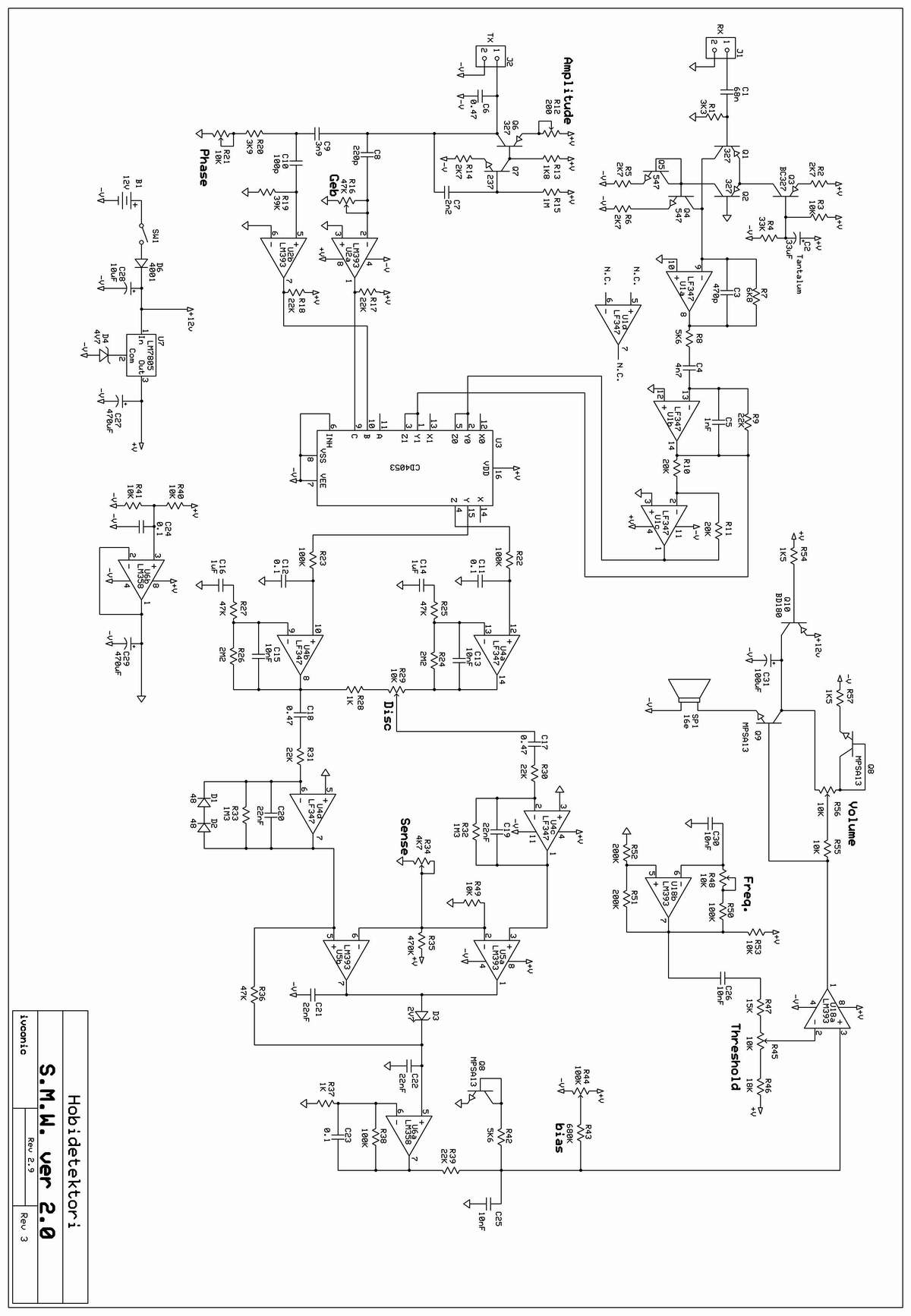

                          I disagree with the name of this contraption. "Caesar" or even "Cezar" is much more poetic than the initials SMW! Come'on surely there is something better!
                          Edit - What specifically do the "phase" and "amplitude" controls accomplish here? Also, what is U6b the opamp floating at the bottom connected to nothing doing (is that the ground reference for the other opamps?).

                                Freq. adj.
                                Hello Friends,
                                Thanks Ivica and others for this nice project !
                                In the Fisher 1235 there is a TR freq. adjustment, can this be used for adapting coils to make them work on that coils freq ?
