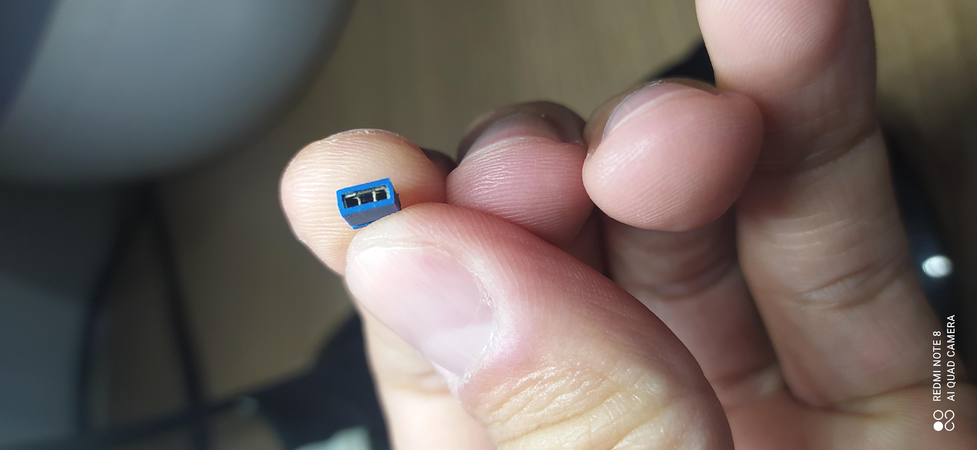

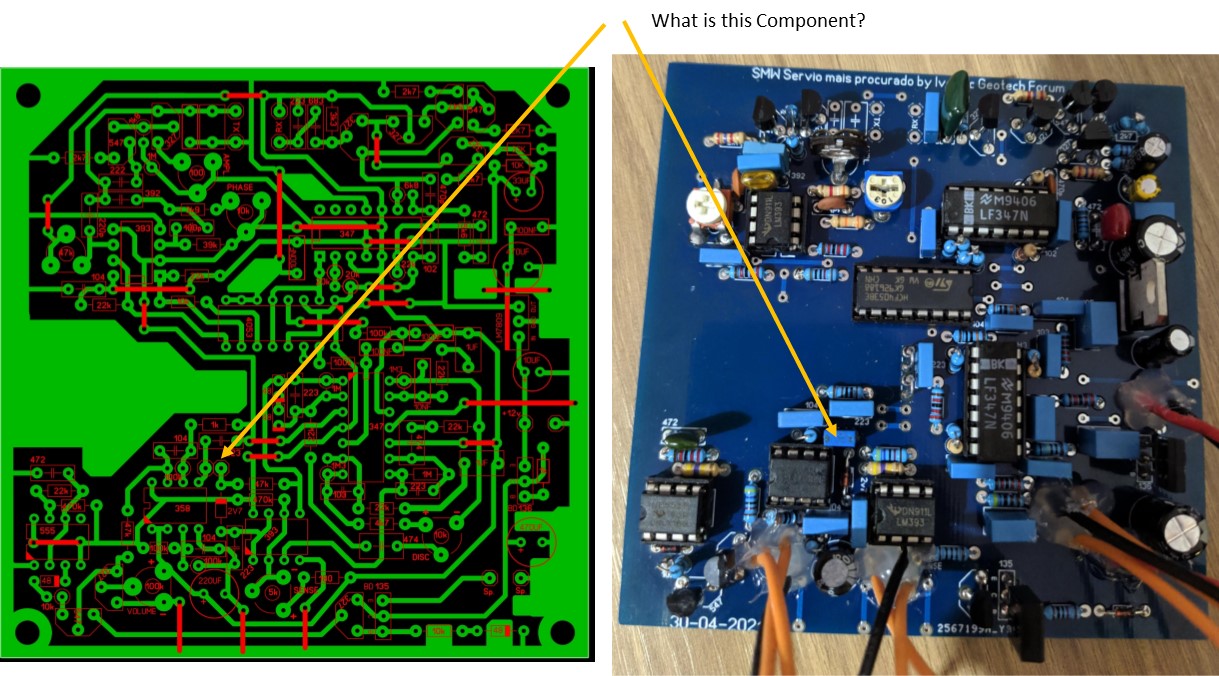

  • Does anyone know what this component is? I would like to make a start building this but I'm not certain what is placed at these pads. Any help would be appreciated. Thanks, Regards, Marty.

      I looked at the scheme that Ivconic gave. There, the connection 358 pin5 to the zener's diode 2v7 and R36 = 47n is direct, and the board is intended to have a bridge to interrupt this connection. Ask Ivconic and he tell what he meant by inserting this bridge.
      And the little blue element itself is called a jumper. There are a lot of computer boards.
      • Thank you for your reply Toros. So, in that place, I just install a jumper block? Thanks for the help Toros. Regards, Marty.

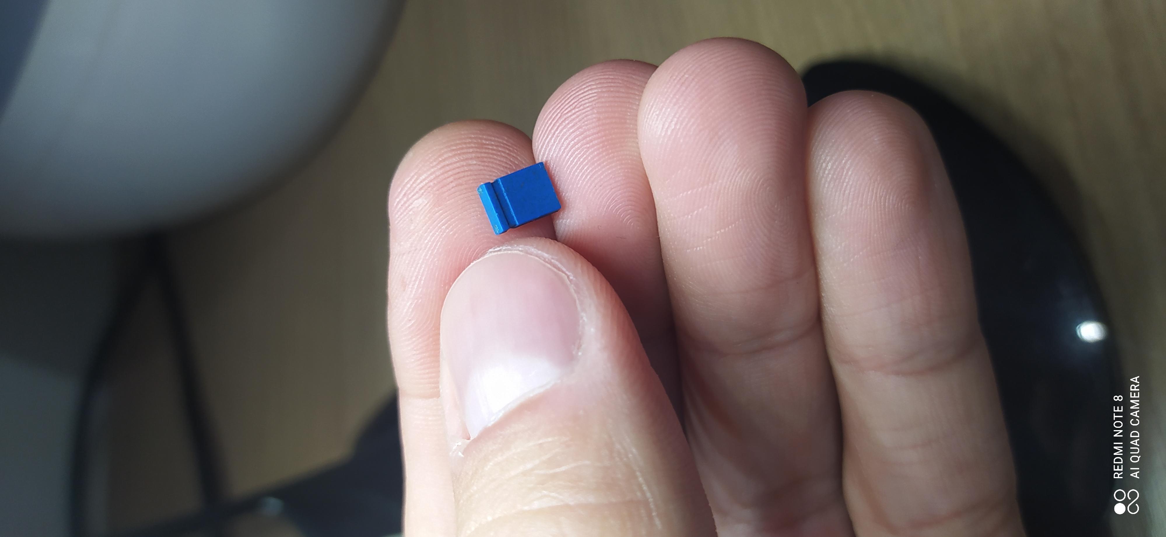

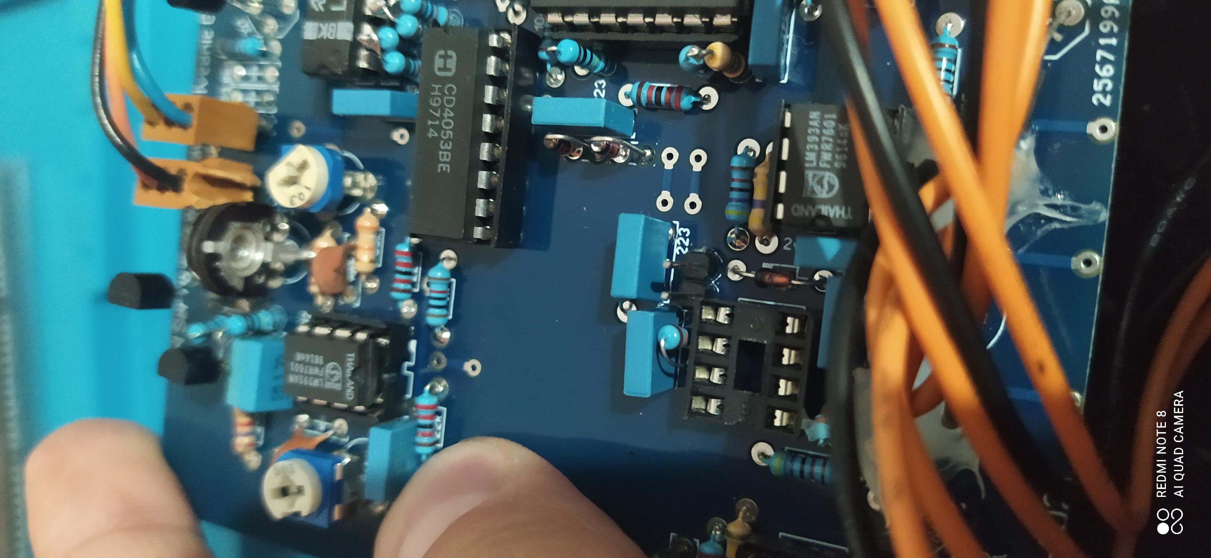

        • Hello friend Marty is a jumper the same ones used in used computer biosClick image for larger version

          • Hiya Emerson,,,,Thank you kindly for your reply and the photos,,,much appreciated! I have sent you a PM. Thanks, Regards, Marty.
