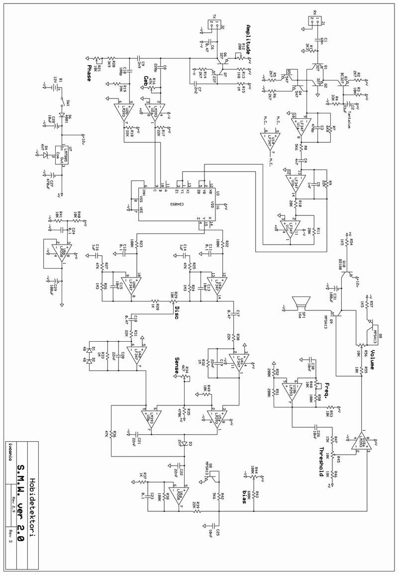

    • And corrected schematic, matched to pcb...

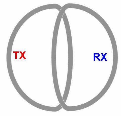

                      • ivconic your opinion about this detector???
                        this detector is good for opration ????
                        please give info about coils 36cm??? TURN AND NUMBER WIRE ...
                        are coils like this picture A or picture B????
                        BEST WISH
                        • It is ordinary DD coil.
                          TX=1mH, RX=15mH
