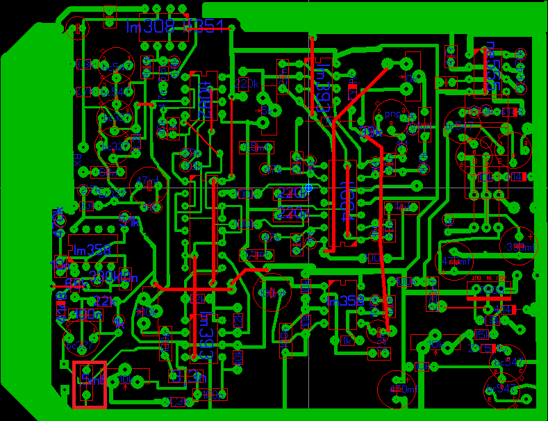

          GreetingsClick image for larger version
          • Can you post here lay file for the first pcb !
