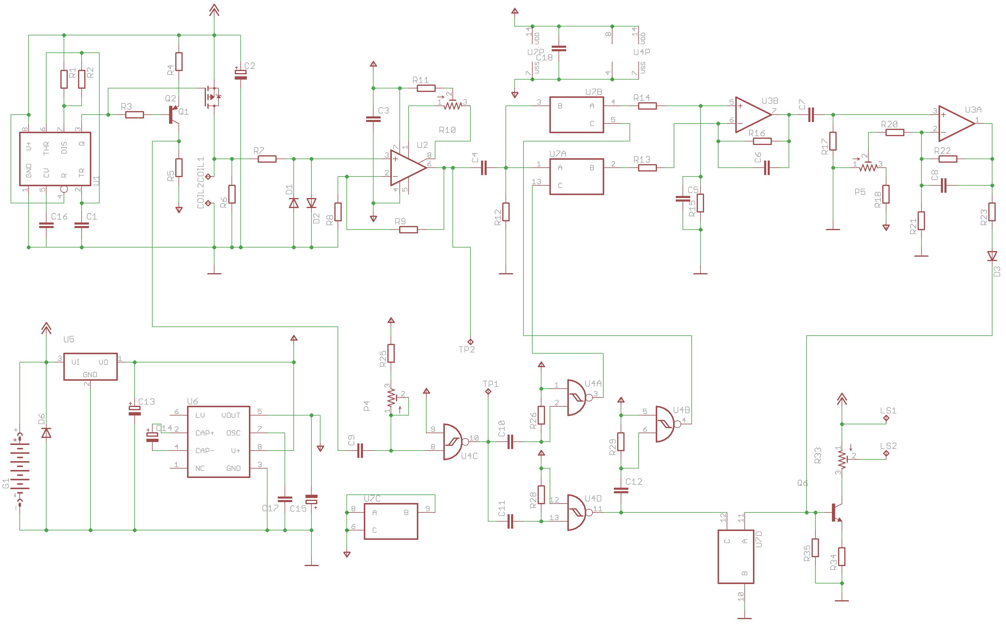

      But...this what i made is modified version, i dont have accurate schematic of it. Pretty occupied to trace pcb and draw schematic....hmmmm.
      Is there right schematic for this modified Surfmaster?
      Would be nice if someone post that here...
      This is my first drawing, next week I will try to build modified Surfmaster.
      • Mustafa,
        C15 looks reversed. Why do you leave out parts values?
        • Schematic with part values.
          • Hello Mustafa
            Thank you for the circuit !

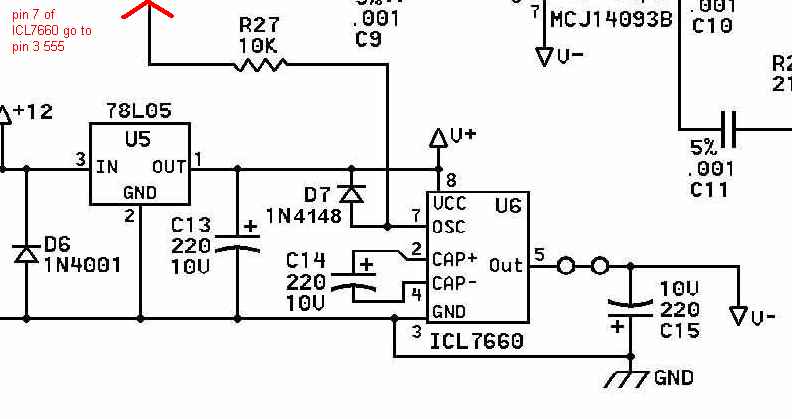

            C15 is OK it is for the neg. power supplay
            Best regards.
            Ap
            • Pin 7 of ICL7660 or MAX1044 go to pin 3 of 555

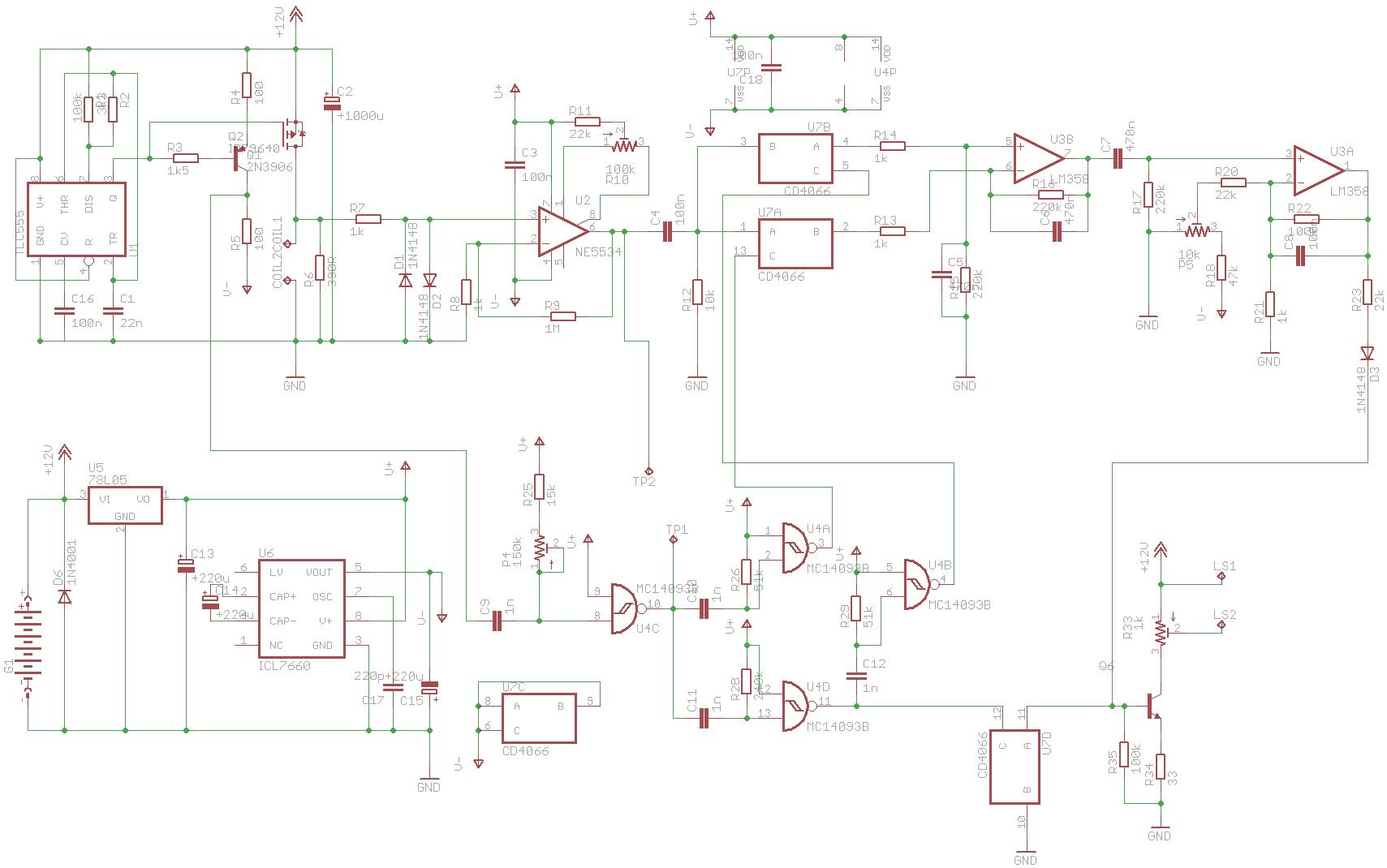

              • This schematic traced from ApBerg's "surf rev1.2.LAY" not from "Aris version of SurfmasterPi.LAY".
                • My version (Aris) is the same of white's schematic.
                  My pcb routing on original schematics.
                  Only my modification is IRF9640 and 390 ohm dump resistor fom my coil. (Not TIP32)

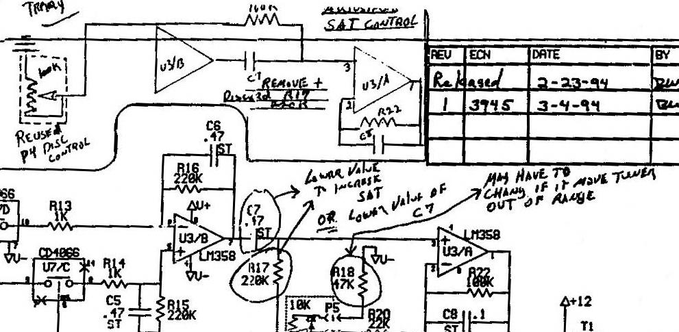

                  • Did anybody tried self adjusting threshold mod?
                    • make my modification you can see at pag. 3.

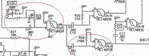

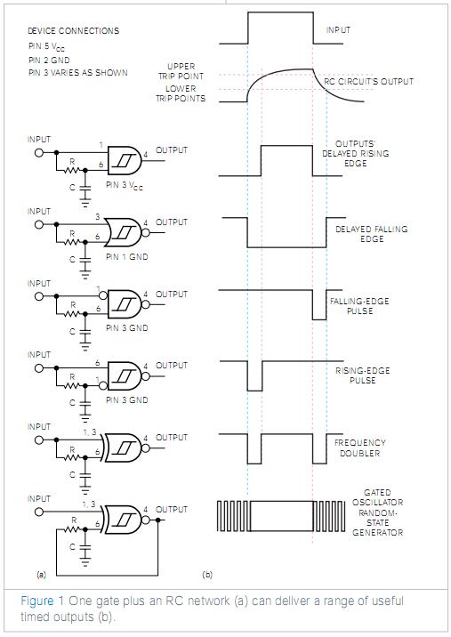

                              • Hi,
                                I am trying to understand Surf PI timings. I know it is very simple for most of you but I don't understand electronics very well.
                                My problem is how can I calculate sample delay from schematic.
                                I read about rc delays but schematic does not fit my readings.
