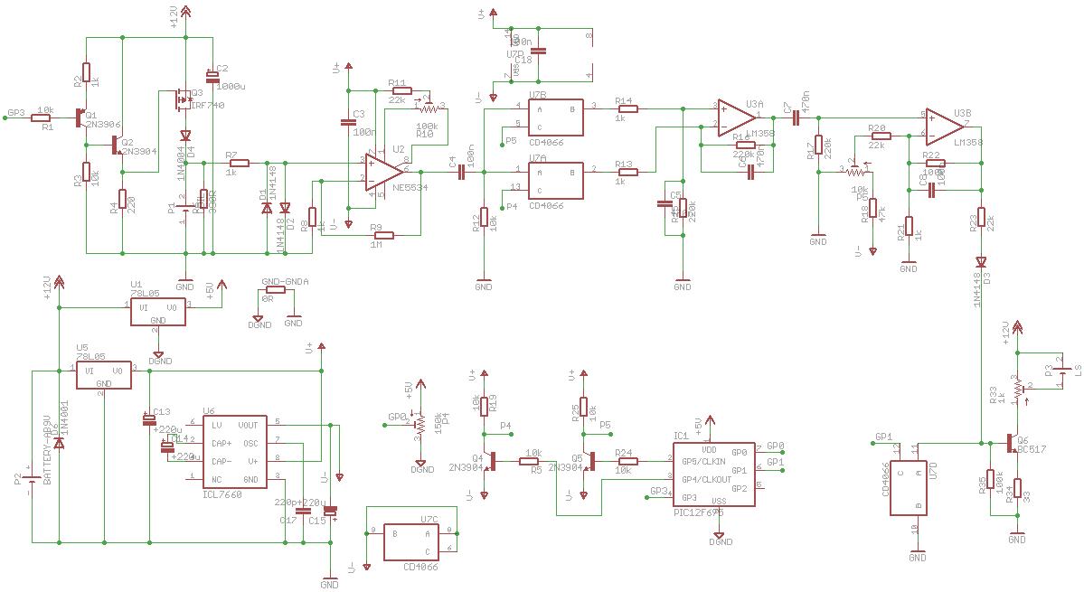

        • Hi,
          I am working on replacing timing logic with PIC12F675/683 on Surf PI like Carl's Hammerhead II.
          I have all of the components to build except P-channel mosfet.
          So I changed the coil driver for IRF740 but I am confused.
          Is this coil driver works?
          • Originally posted by Mustafa View Post
            It won't work. Try to use a PNP transistor like MJ2955 instead of IRF740.
            • Q1 is always turned ON!
              • Thanks 1843.
                IRF9640 is in my shopping list.

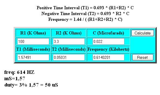

                • Are these settings meaningful for Surf PI?
                  Main Sampling Delay 50us - 120us
                  Secondary Sampling Delay +165us - +235us
                  • HI!

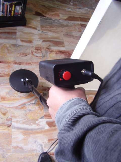

                    This is my Surfmaster PI. Coil 18 cm detects coin 2.5 cm at 25 cm in air. It has transparent coil head for easy pinpointing. Drawback is I find a lot of pulltabs, nails...but also some coins too!
                    I also have a very cool housing design for TGSL. Something you can assemble in a quick step and pack it up in a backpack!

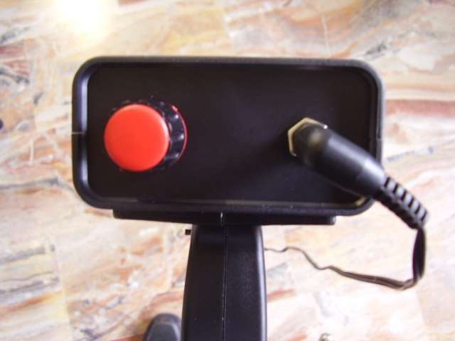

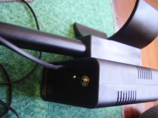

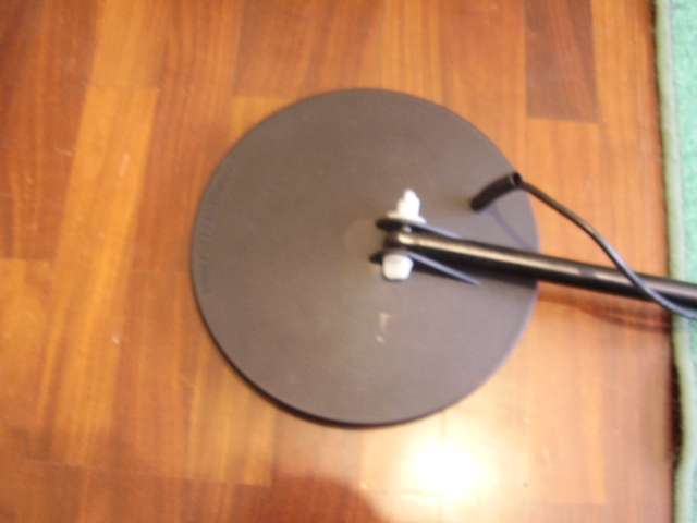

                      This is my final version of surfmaster.
                      There is only one pot tresh
                      the disc pot is setting onbord trimmer R25 50K and bridge 100K pot for full performance.
                      Coil is 20 cm diameter.

                          Where did you get the stem and the search coil housing?
                          Is this something you bought separately, or did you use an old detector as parts?
                          • hallo Qiaozhi,
                            i buy house coil and stem on italian electronics-kit site.
                            excuse my english.
