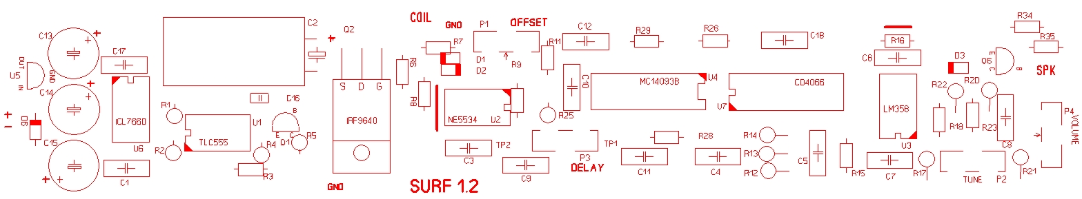

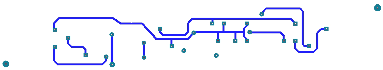

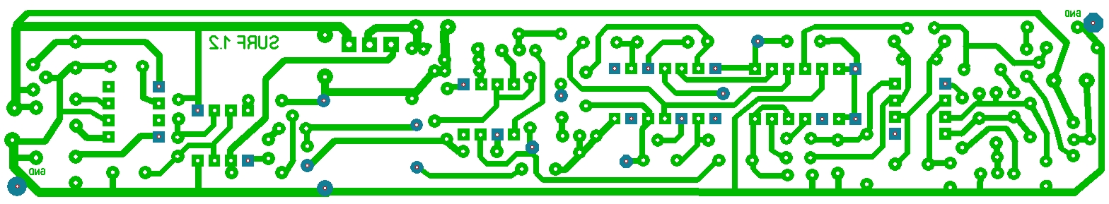

                • hello all
                  I have great need for long PCB in jpeg format
                  if someone can help me
                  Thank you very much
                    ...this is it...works more than good!
                    Coil is 21cm in diamm.. wire 0.35, 24 windings... 1e coin detects at 26cm distance in air, loud and clear!!!
                    Hello ivconic
                    I can do to get long pcb in jpeg format
                    Thanks a lot
                    • Originally posted by bebe2010 View Post
                      hello all
                      Thank you very much
                      168 x 31 mm 1568 x 289 @ 237dpi

                            • for "silverdog"
                              Thank you for pcb.

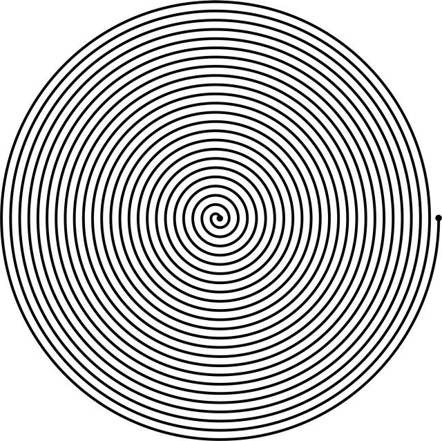

                              • PCB coil that goes to surf PI
                                20 cm diam, 24 turns, 1 mm, spaced 3 mm
