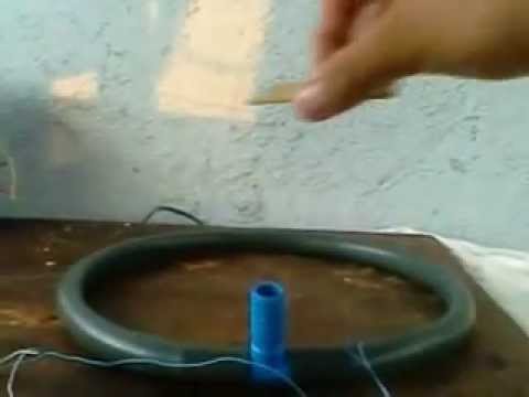

    • surf pi works but little sensitivity to coins
      • Try turning the offset pot of the NE5534.
        • turn the pot displacement of NE5534 not change anything which coil and ideal for design
          • got my last machine working correctly yesterday
            the troubles i had before was a result of experimenting with wrong coil values and wrong offset settings
            i prefer isolated litz wire (simple monoloop)
            i you should try to make your first settings far away from any metal believe it
            turn the offset trimmer so that the machine gets a little bit noisy (threshold and gain to70% delay under 50%)
            thats the point i used to start

                • My problem is little sensitivity
                  • Originally posted by nando.22 View Post
                    Hi Nando,
                    The only thing you can do now is check your component values and voltages. Without a scope it is very hard to determine the cause.
                    • Thank you
                      I see it's weak response
                      Change some resistors
